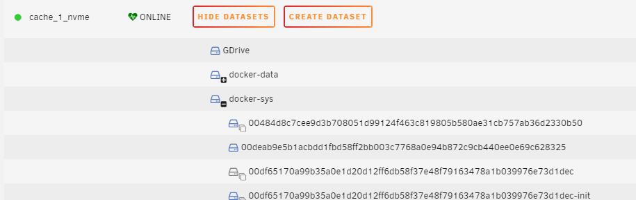

I can not get the exclusions to work. Reading through these posts I am pretty confident that I should set it to /docker-sys/.*
I have tried variations on that and also including the cache drive name /nvme_1_nvme/
When I first installed zfs master I had a parent folder above my docker-sys folder. It was /docker/docker-sys/ when this was my folder scheme I remember them being excluded. However I have now removed that parent folder and the docker-sys folder is its own dataset.
I have dozens of these docker images listed.
I had to tinker with mine to get it to work as well.
My setup, Docker-Directory is set to:
/mnt/zfspool/.docker_system/docker_directory/
ZFS Master Exclusion is set to:
.docker_system
Please keep in mind, that ZFS master doesn't use Regex, but Lua patterns for matching the exclusion folder, that comes with some downsides, in your particular case @sfef, at first sight your pattern seems fine, but it actually contains a reserved symbol "-", combined with "r" it means a completely different thing; you can check your patterns here:
https://gitspartv.github.io/lua-patterns/
Long story short, this should do the trick "/docker%-sys/.*"
Additional doc on Lua patterns:
https://www.fhug.org.uk/kb/kb-article/understanding-lua-patterns/
Edited by Iker
Thanks for the help, @Iker that was what I needed was the % in there.
This works:  /docker%-sys/.*
Edited by sfef
After I posted orig, my page refreshed with the response from Iker which has the same answer

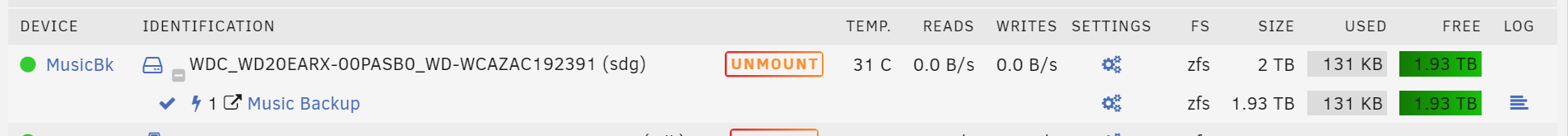

You should add the code to show the % used and free consistent with the display type selected in 'Used / Free Columns' and the color theme:
Your % Used and Free is gray in my setup:
This is the UD display for this device:
When doing GUI work, we want to keep the UI consistent.  Feel free to PM me and I can show you the code to accomplish this.

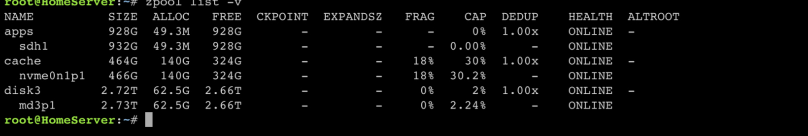

I set this up today - it picks up one of the pool drives but I have two formatted with zfs. Any reason the one would be ignored
8 minutes ago, andyd said:
Thanks for the plugin!
Can you please share the result of the following command (As text):
zpool list -v
Best
zpool list -v
Best
Looks like it's there. "apps" which is not showing up under the plugin
Could it be how I moved over the data? This drive has been sitting around for a while. Yesterday I decided to set up zfs snapshotting.
I moved a folder I had another drive (nextcloud) to this drive using unbalance. Not sure if that is the reason?
is there some way data should be moved to the drive? Do I have to manually create datasets for it to appear in zfs master
Please post it as text, that would help me to check if there are any parsing errors in the plugin and implement the neccesary fixes for the upcoming version.
Ah sorry at this point I got beyond that issue. For some reason, reformatting the drive to zfs again had it show up in the plugin. I ended up reformatting because I was getting weird errors that there was insufficient space. I'm all good now

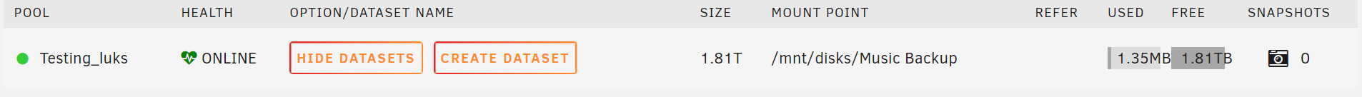

@Iker Thanks again for the Plugin
if you will have time for it ,will be cool to see unraid setup like Used/Free in plugin ...
in my case :
Sure thing; I'm planning to release a new version the next week, with all the bugs and little improvements implemented; stay tuned.
