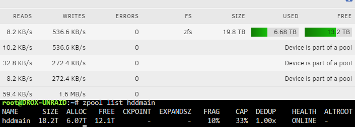

ZFS shows the very same information that you get from the regular "zpool" and "zfs" commands; for example, here is my hddmain pool reported via zpool list vs unraid:
But why is that? There are two factors:
  1. Unraid shows the units using SI (TeraBytes, Gigabytes, etc.) instead of IEC (Tibibytes, Gibibytes, etc.); zfs natively uses IEC units, so there is a discrepancy. The larger the pool, the larger the difference.
  2. Unraid shows you the usable space on the GUI interface reported from the filesystem, but that's not the same information reported by ZFS; in your case, I'm guessing a RAIDZ-1 config, so you get 2TB * (3-p) with p = 1 disk for redundancy; in practical terms, that means 4 TB of usable space; but at the pool level that's not what gets reported, instead ZFS reports 6 TB (Convert it to IEC TBi and you get your 5.5 TB) of total space because that's the pool topology, not the one showed at the filesystem level. Now, at the dataset level (zfs list) ZFS reports the actual numbers you want to know because that config applies to the filesystem level, how much space you can use, excluding the parity, slop space, snapshots, etc.
I hope this sheds some light on why the numbers are different and why I keep them as they are (Because I think they are useful!).
PS: BTW, I noticed the plugin is not correctly appending the Pool stats IEC (TiB); I'll fix that in an upcoming release.

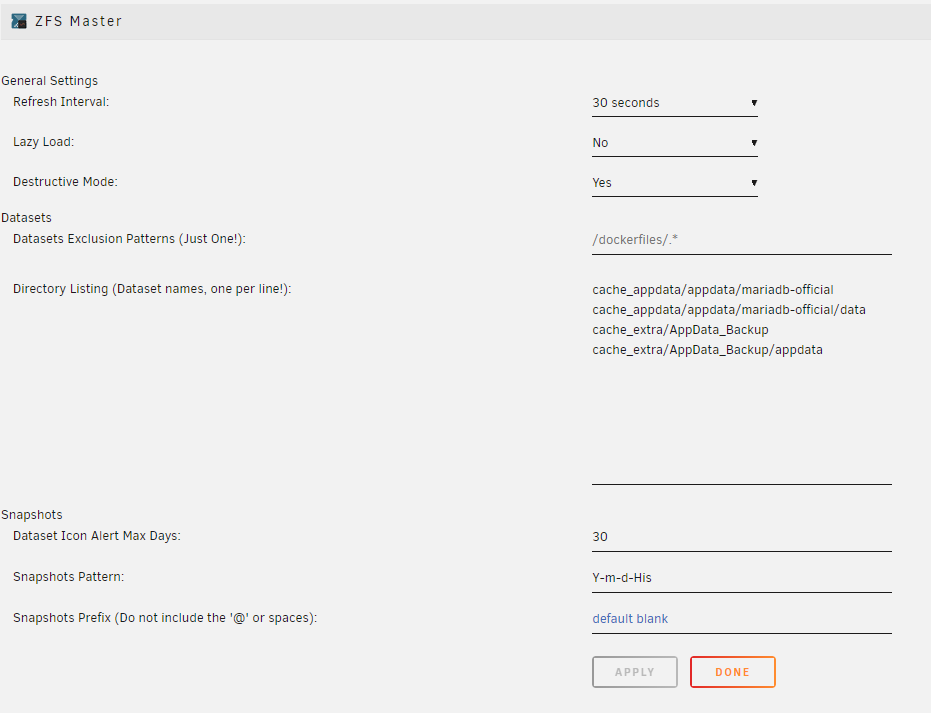

Hello,
Yes I do have "Destructive Mode" on. When I click on the appdata "ACTIONS" menu and click "add directory listings" I get the bellow screenshot.
If I do a recursive snapshot, it doesn't list the other new docker folders. So I can't turn them into datasets unless I use the user scripts by Spaceinverder.
I can click on another dataset ACTIONS menu and when I take a snapshot recursively, and then add directory listings button, the folders inside show up.
It seems to just not want to detect new folders inside the main appdata when I add new docker containers.
Maybe it has something to do with the Directory listings in the ZFS Master settings?
I never added those lines to the Directory Listing section. I assume they were added when I ran the "Add directory listings" button.
Thanks for the detailed report, let me try to replicate the issue so I can push an update with the fix.

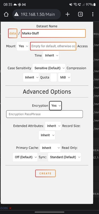

Hi sorry if this is not the correct place to post. It is a issue i have with zfs master
I did all this useing zfs-master
I setup a new data set with in my main dataset data\
data \marks-stuff
When i went over the set up page i selected encrypt drive.
I am sure i left the box empty but i did set encryption yes,
I carried on setting it up then clicked apply . I then moves over 1tb of files data to the new dataset
data\marks-stuff
Upon reboot its locked and i cant get into it. I have tried the main data passphrase but no luck.
Is it possible the dataset data\marks-stuff
inherited the key or paraphrase form the root dataset. \data
any ideas welcome
Thank you
Hi @capduncan, indeed, the child dataset inherits the encryption key; a side effect is that when you unlock the father, you also unlock the child dataset and vice versa.
