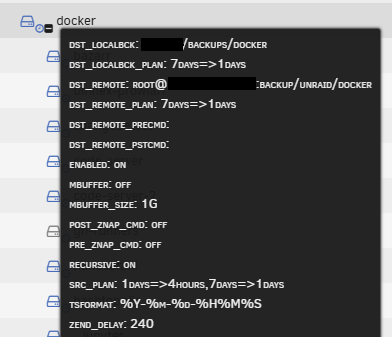

There is a new update with the following changelog:
2024.11.17
  • Add - ZnapZend plans information
The ZnapZend integration is very straightforward; if you have created any ZanpZend backup plan for your datasets, ZFS Master will detect those and show the information in the UI under a clock icon next to the dataset name, an example in the image below.
In my testing, polling the information didn't affect my dataset information loading times; however, please let me know if you find any problems, slow down, or have any issues.
