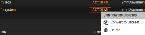

3 minutes ago, john_smith said:
see, that's what's weird, i don't see those options, only move/rename.
True! I have not seeing this Option by me too!

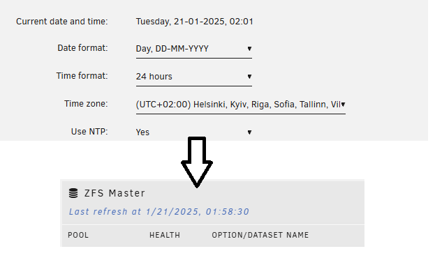

@Iker would like to ask you - is it possible to show refresh date in system date format? Or at least add options in plugin settings to setup format?
@john_smith To activate the "Convert to Dataset" option, you need to enable "Destructive Mode" on the plugin options; I'll probably move it directly to the main UI to make it more intuitive.
@d3m3zs Someone asked me for the same feature not so long ago, and I tried to include it in the latest release, but it's a little bit problematic for compatibility with other features, such as Lazy Load; however, I'll take another look and see what I can do.
Thank you! I saw that option but I thought it was only necessary for deleting already existing datasets. Now that I have enabled it, I see the previously missing "convert to dataset" option:
I'm realizing I may have done something wrong when migrating my pool from XFS to ZFS, since I see in the documentation that "Top-level user shares in a ZFS pool are created as datasets instead of ordinary directories.", and when I just created a test share in this pool, it was automatically created as a dataset.
However, all the shares i currently have in this pool are directories, not datasets. I believe this might be because of the way I migrated my data over from my old pool using copy,to keep old data safe and backed up in old unmounted cache drive while testing ZFS), rather than using mover, which I assume would have correctly created datasets when moving shares over.
I'm curious to try moving a share back and forth from my array to see if this places the data as a dataset rather than a directory. That being said, would this be effectively the same as hitting the "convert to dataset" operation?
EDIT:
move share out of pool and trying to move back was unsuccessful, ended up having to manually create dataset with matching name in order to move data back. tested convert data set on another share and it was much more straightforward.
leaving the system and appdata containers for last since those are the highest impact.
Edited by john_smith

Thank you, I suppose it is only format change for output, according to time format, in java that would be
// Convert the input string to a LocalDate object
        DateTimeFormatter inputFormatter = DateTimeFormatter.ofPattern("M/d/yyyy");
        LocalDate date = LocalDate.parse(inputDate, inputFormatter);
// Format the date to the desired format: 21-01-2025
        DateTimeFormatter outputFormatter = DateTimeFormatter.ofPattern("dd-MM-yyyy");
        String formattedDate = date.format(outputFormatter);
I suppose it will be smt similar on PHP
// Create a DateTime object from the input date
$date = DateTime::createFromFormat('m/d/Y', $inputDate);
$formattedDate = $date->format('d-m-Y');
But you know that better.
EDIT: I see the date request is already being discussed, so.... +1 to whatever can be done there :)
Feature request:
Please update the date/time preference to use the regional settings of the server.
I get a US date format for the last updated and it bends my brain because it's backward.
Talking about this:
"Last refresh at 1/23/2025, 20:13:50"
It'd be nice to see that formatted as
Last refresh: <date according to servers region setting>, <time according to servers time setting>
If that's not possible, it'd be great if we could have basic date formats as preferences (DD/MM/YYYY, MM/DD/YYYY, YYYY-MM-DD, etc.)
Thanks

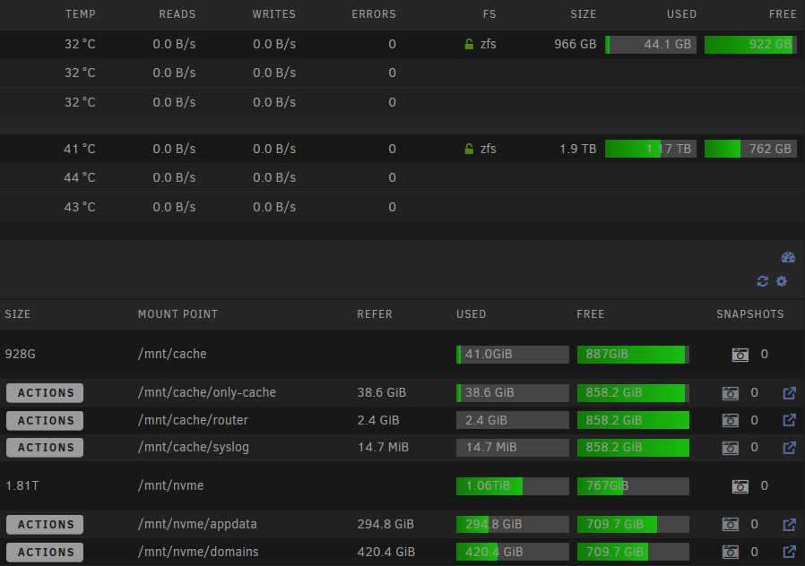

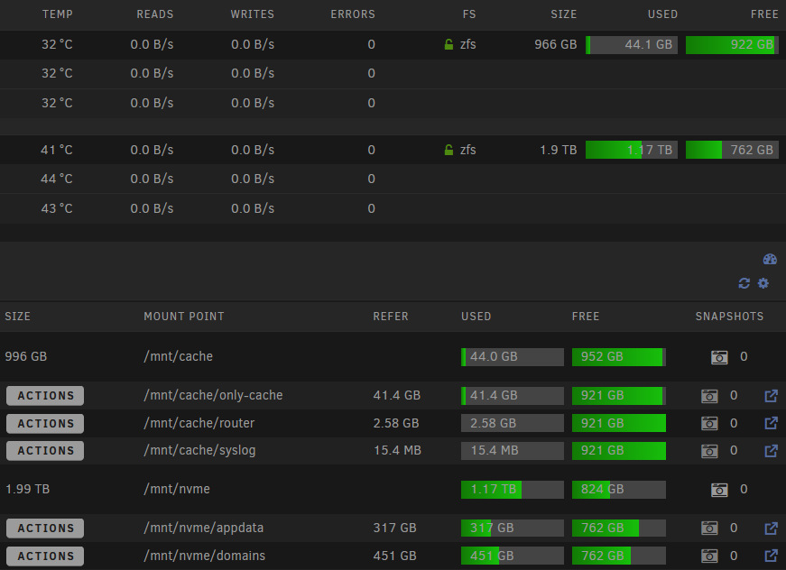

Hello all. Started using ZFS in Unraid and ZFS Master, and the different size units in the plugin compared to Unraid annoyed me, although I understand the reasons why. I wrote a userscript to watch the ZFS Master table on the Main dashboard page and convert all size units from IEC to SI.
This will fix the 1st item in the below list Iker gave for reasons that the sizes are different in the plugin. The 2nd reason is not fixable via this script because ZFS and Unraid have different definitions for pool size.
Before and after:
image.png.1e8fa9a6dd3b9a0871e8f1728a9b05a8.png  image.png.d7dc72ca6b64069e7e087ae9bdd01814.png
Tested with ZFS Master 2024.12.09.104 on Unraid 7.0.0
Tested in these browsers:
  • Firefox 135.0b9 with Violentmonkey 2.29.0
  • Chrome 132.0.6834.160 with Tampermonkey Beta 5.4.6224
It doesn't use anything fancy so I hope it will work with most modern browsers and script managers.
Source: https://github.com/jathek/firefox-tweaks/blob/main/userscripts/unraid-zfs-master-si.user.js
Install: https://github.com/jathek/firefox-tweaks/raw/main/userscripts/unraid-zfs-master-si.user.js
IMPORTANT INSTALL NOTE: You will have to add a custom match rule in your script manager if you use something other than "http://tower/Main*" for your Unraid Dashboard.
On 4/10/2022 at 12:16 PM, Iker said:
But why is that? There are two factors:
  1. Unraid shows the units using SI (TeraBytes, Gigabytes, etc.) instead of IEC (Tibibytes, Gibibytes, etc.); zfs natively uses IEC units, so there is a discrepancy. The larger the pool, the larger the difference.
  2. Unraid shows you the usable space on the GUI interface reported from the filesystem, but that's not the same information reported by ZFS; for example for a RAIDZ-1 config with three disks, you get 2TB * (3-p) with p = 1 disk for redundancy; in practical terms, that means 4 TB of usable space; but at the pool level that's not what gets reported, instead ZFS reports 6 TB (Convert it to IEC TBi and you get 5.5 TB) of total space because that's the pool topology, not the one showed at the filesystem level. Now, at the dataset level (zfs list) ZFS reports the actual numbers for the filesystem because that config applies to the filesystem level, how much space you can use, excluding the parity, slop space, snapshots, etc.

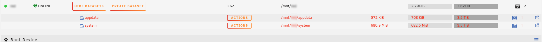

Why are my folders/datasets?!? in RED color?
For the other disks everything looks like normal, that means in black color.
Figured it out, is a ... display bug it seems. :)
No point to hide it, my pool is named red because there are two WD Red drives, and also had some (buggy) WD Blue NVME drives.
I was so scared of the red color when I saw it, cause I didn't know what was the problem, everything was allright, but was still red colored, so after the incompatibilities with the blue NVMEs I thought more problems now with my SATA drives. :)
Apparently, naming your pool as "red" or "blue" or who else what color (maybe green?!?) makes the plugin apply the css theme.
<tr id="tr-red/appdata" class="zdataset-red red red" style="display: table-row">...
Almost feeling like I've discovered some sort of a SQL injection. :)
Edited by AriseZC
It's worth knowing in general these differences and how they're displayed.
Linux is quite good at showing the correct unit names: K/M/G/T or K/M/G/TiB means IEC units, K/M/G/TB means SI units.
I assume MacOS is the same because it's Unix based, but I don't know that for sure.
Windows, annoyingly, is very bad at this. It says K/M/G/TB but uses IEC units.
If I were going to convert, I would rather convert Unraid's main page to all IEC so everything would match.
ZFS Master was the odd one out so that's the one I chose to convert to match. Everything else on the Unraid Main page is already SI and it would've been more effort to identify the units in all the different parts of the page. I use Windows primarily as well, so IEC is what I see everywhere else, but I'm just used to seeing SI in Unraid.

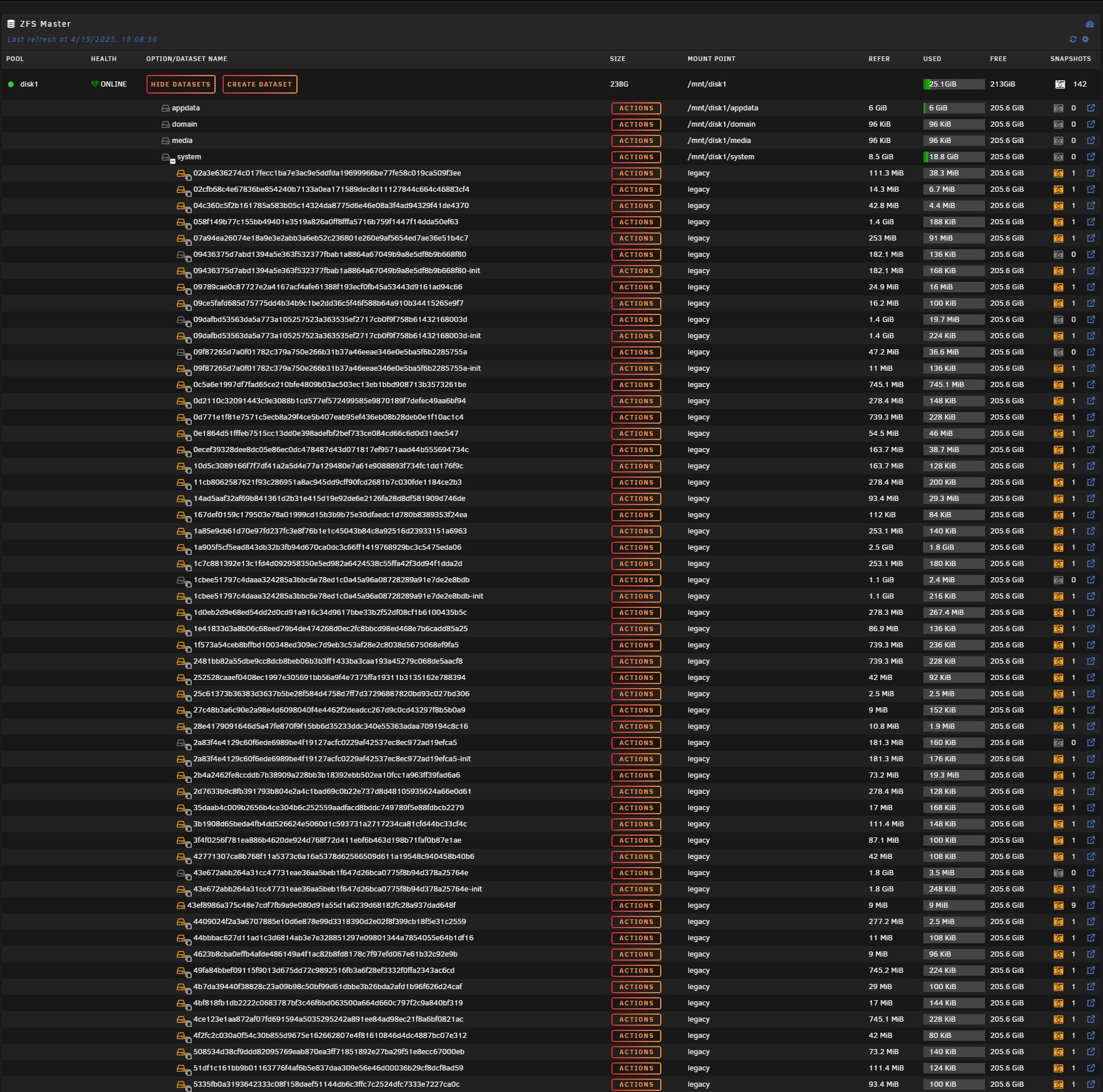

I have 142 "legacy" snap shots created under my system folder and I cannot figure out how to remove them. Also why are they being created. I tried deleting them and it goes the process but doesn't delete them. I have attached an image showing that I'm talking about. How do I get rid of these and stop them from coming back?
It's docker creating them. You can hide them (discussed plenty of times in this thread). You can also switch to image or keep the docker dir with overlay2 and it will stop.
can you point me to instructions for doing this I'm not seeing anything telling me how to do that in this thread
The plugin settings:image.png.a43818812436749ac8a56d0ef90f1b1a.png
It even shows you and example in the text box.
Or don't use the docker-root folder structure. Use a docker vdisk instead.

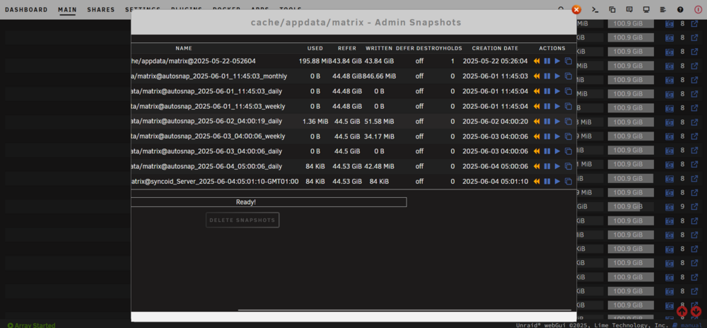

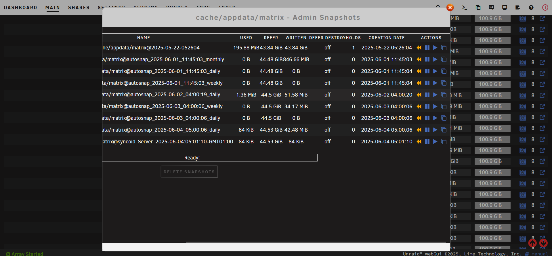

The Admin Snapshots pop-under seems to require horizontal scrolling to view the icons. Attached a screenshot.
The Ready! seems a little redundant in the Admin Snapshots view, as does the status bar when nothing is happening, because the existing design language dictates the greyed-out buttons as not currently being actionable, and orange ones being actionable.
As an aside, I cannot for the life of me figure out how you remove a hold on a snapshot via the ZFS Master GUI. I would have thought that the Hold icon would turn into a function to remove a hold (maybe 'locked padlock' and 'unlocked padlock' icons would be better than a 'pause' icon? Not sure if there's any convention for that in ZFS), but I'm still offered the Hold feature for a snapshot even when clicking it yields a Hold Result of Operation not permitted.
