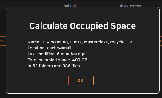

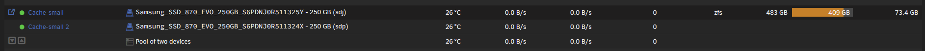

I've noticed a discrepancy in capacity stats between Unraid and ZFS Master.
One of my cache pools (2 drive mirrored ZFS) is reporting 483GB capacity. ZFS Master is reporting 464GB. The Capacity used is also reported differently as 409GB in UR and 381GB in ZFS Master.
Exploring the dataset from ZFS Master and calculating the capacity used reports 409GB
I'm not sure who would own the issue, whether that's UR or the ZFS Master.
I think that they are the same value but one is in GB and the other in GiB (I.e. decimal)

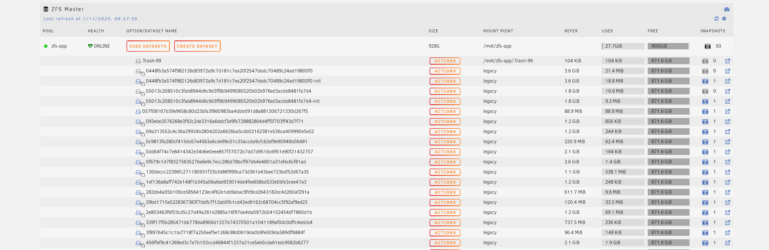

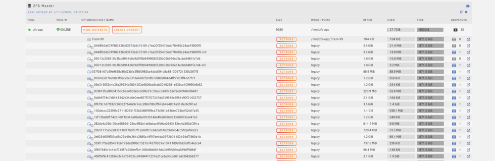

I'm not sure if this occured before or after I upgraded to Unraid 7 (from 7rc1), but on my app (docker) drive, I see this in the ZFS Master gui:
when I open terminal I can't find these anywhere.   What are they?   How can I delete them in bulk?
EDIT:
it looks like something from docker...
`mount` shows
zfs-app/05013c208510c3fab8944d6c9d3ff8b9499080520b02b976ed3acbb8481fa7d4 on /var/lib/docker/zfs/graph/05013c208510c3fab8944d6c9d3ff8b9499080520b02b976ed3acbb8481fa7d4 type zfs (rw,relatime,xattr,posixacl,casesensitive)
zfs-app/05013c208510c3fab8944d6c9d3ff8b9499080520b02b976ed3acbb8481fa7d4 on /mnt/zfs-app/docker/docker/zfs/graph/05013c208510c3fab8944d6c9d3ff8b9499080520b02b976ed3acbb8481fa7d4 type zfs (rw,relatime,xattr,posixacl,casesensitive)
EDIT:  I guess I solved it, hid in the zfs master settings:

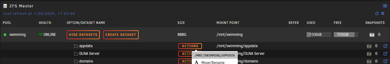

a bit new to ZFS here, I recently formatted my pool to ZFS and using mirror with two 1TB nvmes, but when i click actions using this plugin, the only option i see is to move/rename, nothing about snapshots. Am i missing a setting somewhere?
Hi John, I have the impression that you created a folder instead of a dataset, and that's the reason you can only perform a limited set of actions.
Edited by Iker

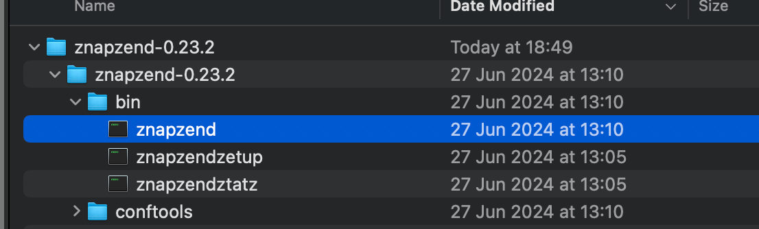

On 1/17/2025 at 6:54 AM, d3m3zs said:
Just get 3 files and use them (znapzendzetup, znapzend, znapzendztatz).
How did you compile it for unraid? Do you not have to? I tried downloading the binaries but I get some error about "Mojo" missing or something.
Edited by MowMdown
Download https://github.com/oetiker/znapzend/releases/download/v0.23.2/znapzend-0.23.2.tar.gz
Unpack, go to folder "bin" and you will find all 3 files. Copy them to any place and use, of course according to place where you put them will be diff command to execute. Or paste them to /usr/local/bin to be able run without path, but need to write simple cp script to do this every boot.
Create script to run during every Array starts:
/HERE_IS_YOUR_PATH/znapzend --daemonize --pidfile=/var/run/znapzend.pid
Yeah I tried that and was presented with this error when tring to run znapzendzetup create
Can't locate Mojo/Base.pm in @INC (you may need to install the Mojo::Base module) (@INC entries checked: /usr/local/bin/../lib /usr/local/bin/../thirdparty/lib/perl5 /usr/local/lib64/perl5 /usr/local/share/perl5 /usr/lib64/perl5/vendor_perl /usr/share/perl5/vendor_perl /usr/lib64/perl5 /usr/share/perl5) at /usr/local/bin/znapzendzetup line 10.
BEGIN failed--compilation aborted at /usr/local/bin/znapzendzetup line 10.
I feel like i'm missing something obvious...
i didn't consider that formatting my cache as ZFS wouldn't automatically create a dataset for at least for the top level as a whole. Do datasets need to be created manually for, or what's the process for working with them?
It does appear datasets have to be manually created. You can use zfs master to convert folders into datasets.
SpaceInvader also has a script that will do it for you but I don't personally use it.
Edited by MowMdown
These 3 files
Then
#ZFS snapshots
cp -rf "$source_dir"znapzend/ /usr/local/bin/
chmod +x /usr/local/bin/znapzend
chmod +x /usr/local/bin/znapzendzetup
chmod +x /usr/local/bin/znapzendztatz
#Run znapzend service
znapzend --logto=/var/log/znapzend.log --daemonize
# Check if znapzend is running
pgrep znapzend > /dev/null
if [[ $? -ne 0 ]]; then
   /usr/local/emhttp/webGui/scripts/notify -i warning -s "znapzend is not running"
fi
If plugin will be updated - fine, but don`t expect and don`t need it.

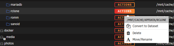

21 minutes ago, MowMdown said:
I don't use it because I manually create the datasets I need when needed. Im not doing it often enough to require a script to do it for me.
what's the process to convert a directory into a dataset? is it simply to hit "Create Dataset" and input the exact name of the directory?
i don't see details on this on the first post, only notes about what the process entails on the back end while it's happening.
You just click on the "Convert to Dataset" button.
Edited by MowMdown
see, that's what's weird, i don't see those options, only move/rename.
I noticed your folders are blue though, while mine are gray. is your root folder above those (rclone in your example), also a dataset? is that what i'm missing?image.thumb.png.6ac9429fa9ea5d80d72c3d13f7b30125.png
