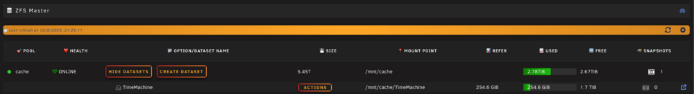

Small request, would it be possible for the pool size to match the actual "useable" size vs the entire size + zfs overhead? If I have a 200TB pool, zfs master reports around 200TB vs the 120 or so with the parity + overhead. I don't know if this is possible but it would make it really handy for setting quotas, so we can see exactly how much we have without pulling out a calculator every time. :) The dataset size seems decently accurate, so I usually just add up all used space from each dataset then subtract that from the useable space from zfs pool info then calculate out how big to make my quotas.

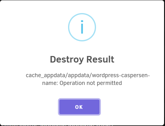

Sorry if this already have been covered somewhere in this thread!
But I am having a problem removing old appdata folders after deleting dockers.
They are all "greyed" out on ZFS master but when I select to destroy them I get permission denied.
I have rebooted the server multiple times.
I have stopped Krusader I heard that could cause issues...
I havent stopped the server before destroying the dataset, should I?
Unmount the dataset first by setting mountpoint to "none" or stopping the array.

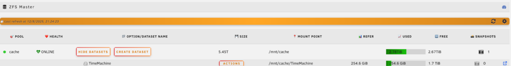

Is anyone else having issue with the zfs master populating anything on the main page? Occassionally all of my directory listing just dissapear, and randomly re-appear?
I had the same issue. Setting in Zfs-Master-settings the refresh intervall to 30 min could cure it. Anyhow, a not maintained, dying plugin is in the long run a problem. The interesting part of the game is the reaction from the Unraid officials (quietness). Advertising can be an alternative reality.
I just came here to post the same.
Just a blank page. I cant say I use it often, but I have never seen a blank page before. On the latest unraid version.
Just wanted to post that I got it back. Now sure which - or both, of these changed it - I turned OFF the auto refresh and turned off the lazy load :
