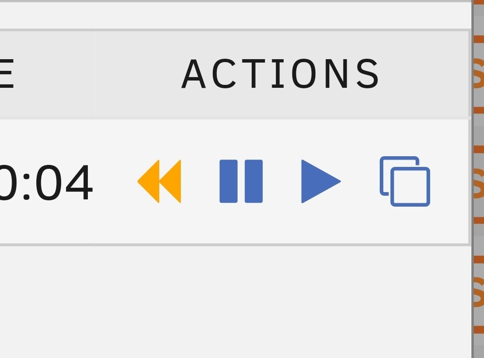

Can someone explain me what these snapshot admin options are/doing?
I cannot find any manual, and I am trying to restore a snapshots to a month ago, but I don't know which option I need to take.
Thanks!
On 12/25/2024 at 5:24 PM, TallMan206 said:
Hi all,
Merry Christmas!
Thanks!
When you hover your mouse over them, it explains....
rollback
hold
release
clone

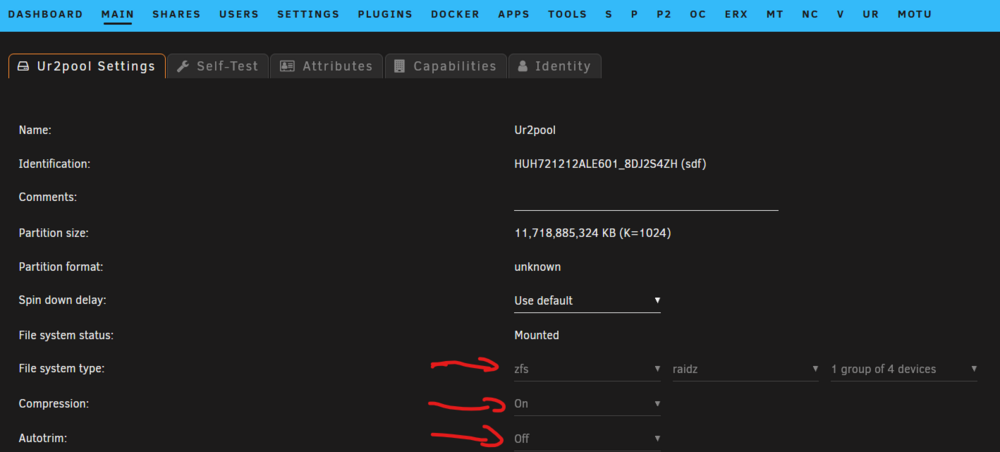

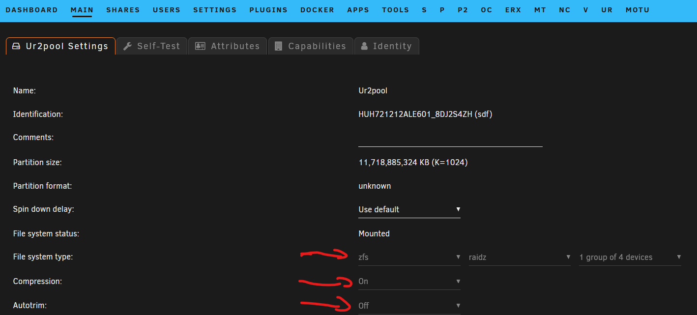

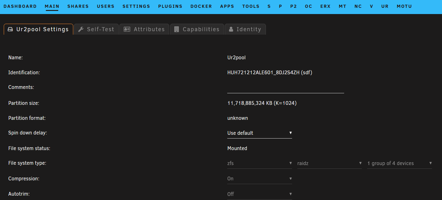

Hi everyone,
I'm looking for steps to set zstd-5 compression at both the zpool level, and at the dataset level.  Thanks to help from @bmartino1 I managed to get the dataset compression set, but the zpool level still shows as "on".
I checked and Unraid 6.12.14 is running > version 2 of zfs, so zstd-5 should be supported.
zfs -V
zfs-2.1.15-1
zfs-kmod-2.1.15-1
With help from @bmartino1 I did the following:
Created the zpool via the command line:
zpool create -O casesensitivity=insensitive -m /mnt/ur2pool ur2pool raidz1 ata-HUH721212ALE601_8DJ2S4ZH ata-HUH721212ALE601_8HKS73MY ata-HUH721212ALE601_AAGAX74H ata-HUH721212ALE601_AAGHK6WH
zfs set compression=zstd-5 ur2pool
zfs set atime=off ur2pool
I then added a pool via the  "Add Pool" button at the top left:
image.thumb.png.05238902f8e4d54f4d68432622cc35da.png.7c93b0692eaf5660da2509ece9ee20fb.png
I populated the newly created pool with the 4 drives that makeup my raidz1 zpool.
I then clicked on the pool and edited the values with red arrows:
I then created a dataset via the create dataset button in the ZFS Master plugin as per the screenshot above, and set compression to zstd, and "Quota" to 5 MiB:  Do not set quota to 5, as this limits the data allowed in the dataset.
However upon reboot, I see the following instead of "zstd-5" for both:
zfs get compression
NAME               PROPERTY     VALUE           SOURCE
ur2pool            compression  on              local
ur2pool/hotBackup  compression  zstd            local
I then set compression via the command line for both the zpool, and the dataset:
zfs set compression=zstd-5 ur2pool/hotBackup
Upon reboot, I see the following:
 zfs get compression
ur2pool/hotBackup  compression  zstd-5          local
My understanding is that "on" means lz4 compression.  Ideally I'd like this to be zstd-5.
This is pretty close.  Is there a way to set zstd-5 at the pool level?  Is there anything I've done in the steps below that should be adjusted before I populate the pool/dataset with data?
Thanks everyone,
Cal.
Edited by calvados

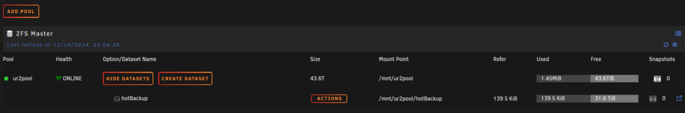

Hi all,
Sorry if I ask a stupid question, I am new to UNRAID and obviously I am discovering this fantastic plugin.
In my box running 7.0.0-rc2, when I open the ZFS Master tab there is no information and I need to manually click on the refresh icon to populate the page. The refresh interval is set to 15 minutes.
Is this the normal behavior?
2 hours ago, googleg said:
Hi all,
Hi @googleg it's not. Can you please share your plugins settings, just to check that everything is configured as it should.
EDIT: Nevermind after a complete reboot of the NAS the info is showing correctly. Not sure what happened but now it works as expected.
Here it is:
General Settings
Refresh Interval: 30 seconds
Lazy Load: No
Load ZnapZend Data: No
Destructive Mode: No
Datasets
Datasets Exclusion Patterns (Just One!): /dockerfiles/.*
Directory Listing (Dataset names, one per line!): mypool/docker
 mypool/otherdataset
Snapshots
Dataset Icon Alert Max Days: 30
Snapshots Pattern: Y-m-d-His
Snapshots Prefix (Do not include the '@' or spaces): default blank
Edited by googleg
