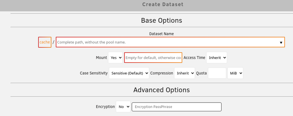

I deleted and have  up my CACHE drive and an external backup drive to ZFS.
When setting up a RAID in Unraid settings, I also selected compression and encryption for this ZFS pools.
I assume that this has now been done for all data. (not much on it yet)
Now you can also create datasets with your ZFS Master, which also have the advantage of a snapshot. and others...
But what I don't quite understand yet:
Compression and encryption can now be selected here again.
Is the data still encrypted with passphrase selected in UNRAID drive settings, if I don't select anything there? (do not touch the "no")
If I select encryption for a dataset and enter the same PassPhrase as on unraid, it will subsequently have a lock symbol in the ZFS master.... like on "medien".
Then of course I'm sure that it was encrypted,.... but twice ? Is backup and downloads also encrypted ?
Disadvantage: I then have to decrypt this data set separately with a password if I restart UNRAID... (even it is the same password as in Unraid encryption settings)
I hope one of you understands this better than I do.
Greetings
Mike

Hi @mmm77, most of your assumptions are correct, Unraid can create an encrypted pool; this process encrypts the entire disk using LUKS so your data is always encrypted. On a note, currently, Unraid doesn't support ZFS native encryption for pools.
Answering your question about data being encrypted twice, Yes, ZFS is not aware of the LUKS encryption, and in any case it allows you to have different keys/passphrases for different datasets, even if they are descendants of an encrypted one; moreover, ZFS allows you to have different settings for different datasets, that includes, compressions, mount points, etc; it's a very flexible system.
I recommend you to read the following article https://arstechnica.com/information-technology/2020/05/zfs-101-understanding-zfs-storage-and-performance/.

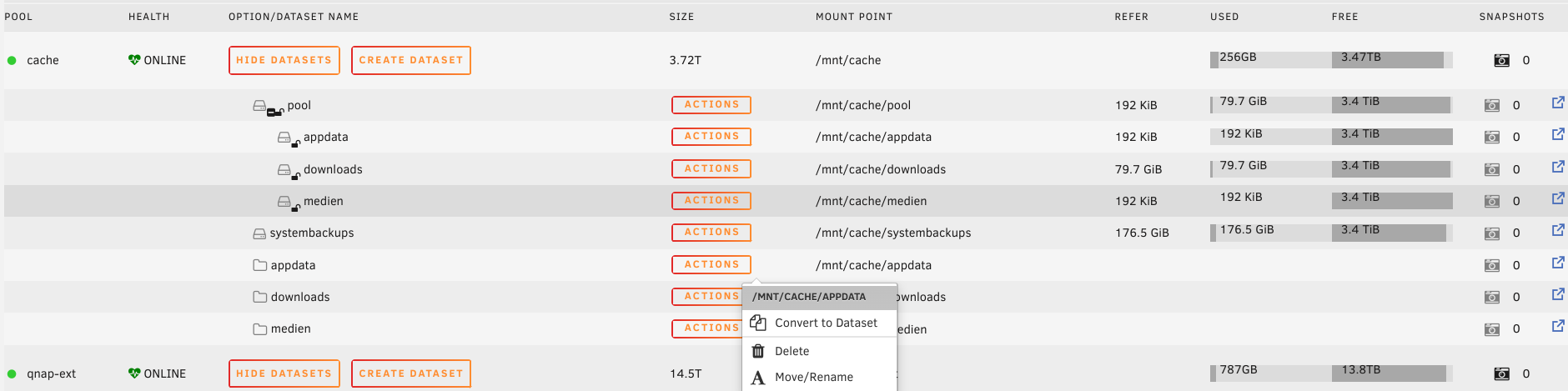

Thank you for your help @Iker.  Tried to understand , but I will also look for a German explanation to understand better.
What I now did:
Move Data of my cache ZFS drive to array.
Formated cache again as ZFS without compression and encryption set in unraid settings...
I understand how I can enable compression and encryption in every dataset, but I do not understand how I can enable this for the zpool itself, so the datasets can inherit the same passphrase and I do only have to unlock once.
Okay, as child of the first Dataset this should work....
But Unraid creates the shares for first and second storage only in the home directory?  First storage is this ZFS drive and second storage is my normal "xfs encrypted" array.
Thanks !
Mike
Tried to solve myself:
What I now did: create 1 Dataset with settings I need.
Created child Datasets in ZFS Master.
To get this dataset in root I found the solution to change the mountpoint of this dataset with ZFS Master from /cache/pool/medien to /cache/medien
This way all should work now.
Only "problem" is that this new mountpoints /cache/medien will be shown in ZFS Master as a normal folder too.
EDIT:  It seems that it is not a correct child of the Dataset, when I create it in ZFS Master as described above... It does not unlock together..  This does only work when I create the child dataset in terminal with  "zfs create cache/pool/medien"
After restart the new mountpoint I set to cache/medien does also not work... The folder is empty.
I have to set another mountpoint eg. cache/medien2 and set it back to cache/medien.  Then it works...

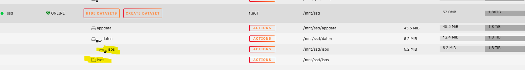

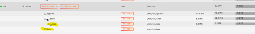

@Ikersorry, don´t want to bother you.... I am really a noob, and try to help myself with google.
Again the issues for me:
1) Child Dataset only unlock automatically when I create them on terminal with eg. "zfs create ssd/daten/isos", not in ZFS Master as new "child" dataset ssd/daten/isos
2) I can mountpoint of child datasets with ZFS Master to root of the drive when needed (eg. isos / domains) , but it is not automatically mounted, when I unlock the parent dataset in ZFS Master. The folder is empty... the parent is normally mounted... I have to use on terminal command "zfs mount -a"  afterwards (thanks google) and it works then.
3) Child Dataset mounted to root of drive are also shown as normal folder in ZFS Master.
So maybe something to improve for you or it is wanted as it is...
Only need to know...
Edited by mmm77
Don't worry; it's not a problem, but I'm not so sure what type of functionality you are asking for. Here is the thing: Unfortunately, Unraid doesn't support the native ZFS encryption scheme (yet); however, the LUKS encryptions work just fine; if you need extra privacy, it's possible, as you have suggested, to create additional datasets with different keys, but you have to unlock them manually.
About the mount point listed as a folder, unfortunately, it is very hard to work in these little cases, as you can mount a dataset anywhere in the system, but I see what I can do.
Thanks for your answer... Now I understand it clearly... I think you are right... I will use LUKS encryption with the same password for all...
I will disable compression in unraid to avoid double compression and enable it for each dataset. (so I will choose better and slower compression for some seldom used and changed data)
Thanks again
