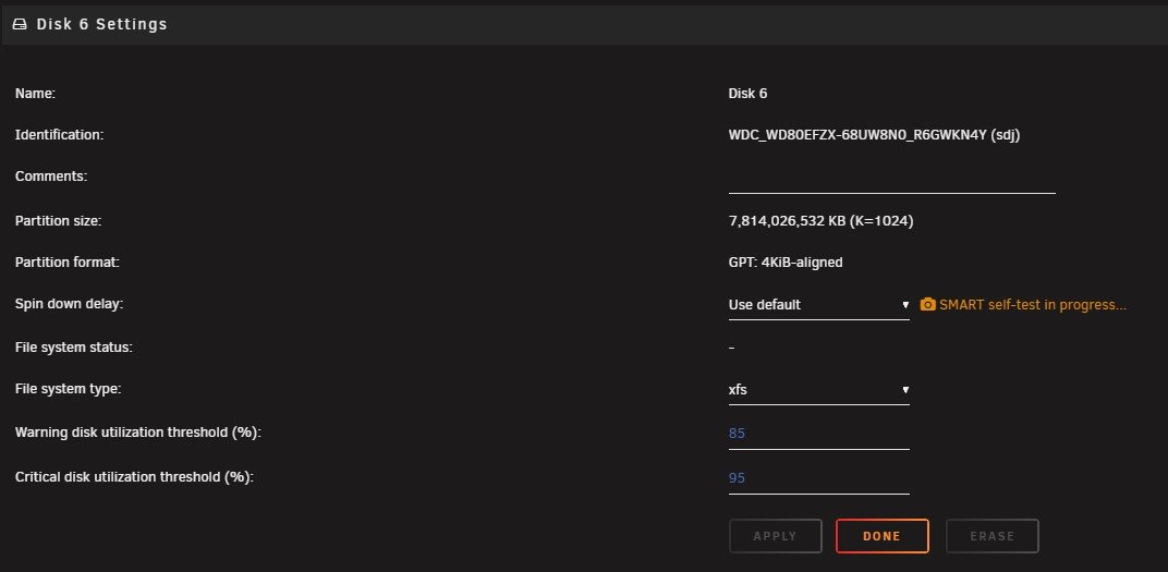

However, when I started the array after unassigning Disk4, Disk6 threw errors and went disabled.
I just ordered a new hard drive because I don't have a spare. Yes I know, I should always have at least one spare. I'm an idiot.

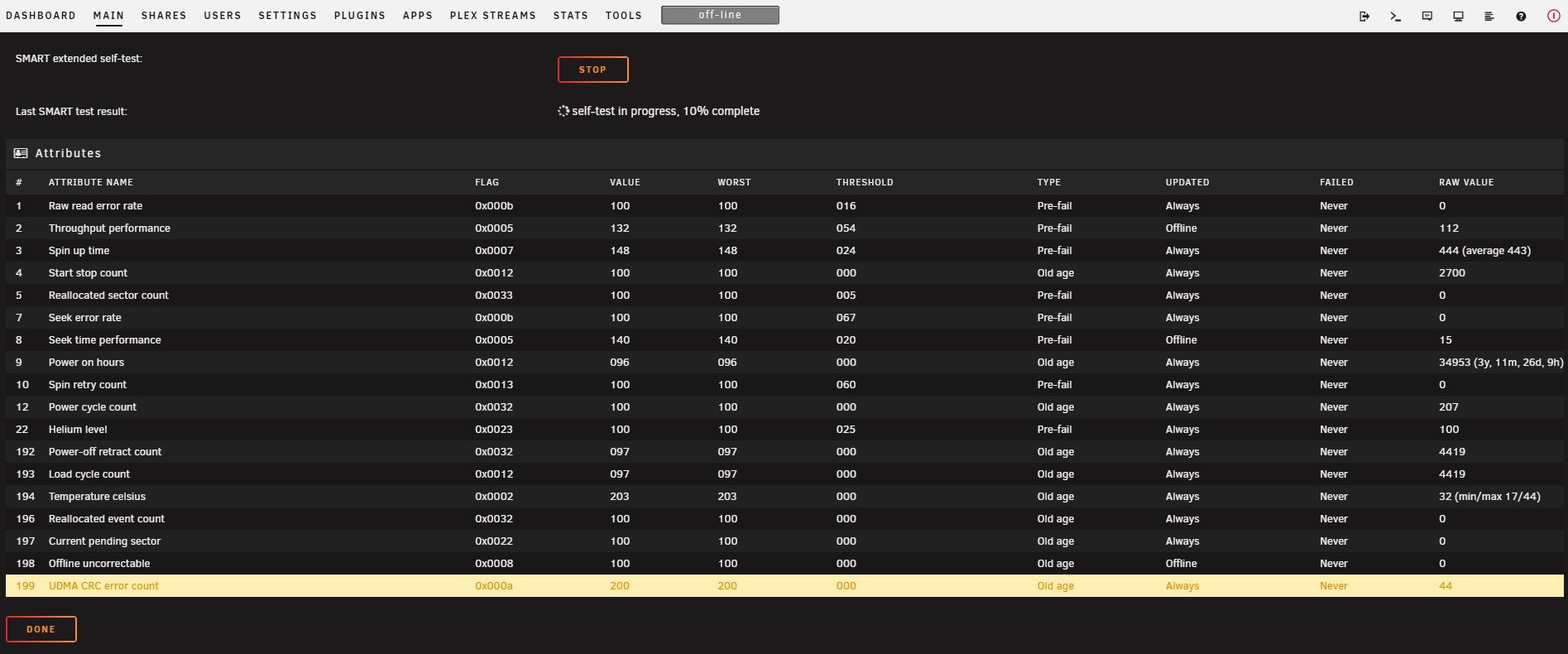

My question is, I don't see any 'bad' errors, like Unallocated or Pending sector. So is the disk actually bad or is there another issue like in my previous post with the bad backplane or maybe a problem with my LSI card?
I am 100% going to leave my server off until I get the new drive, then I will rebuild onto it after doing a Preclear, but should I re-build everything into my new case that I got, which doesn't have a backplane, or should I use my current case with the backplane and rebuild my array with the new disk?
I just don't want to keep getting all these errors especially when I'm trying to rebuild a disk.
I'm not sure if the Diagnostics file will show all the errors or not, but I'm including it and Disk6 smart report.
I also started a SMART extended self-test on the disabled disk.

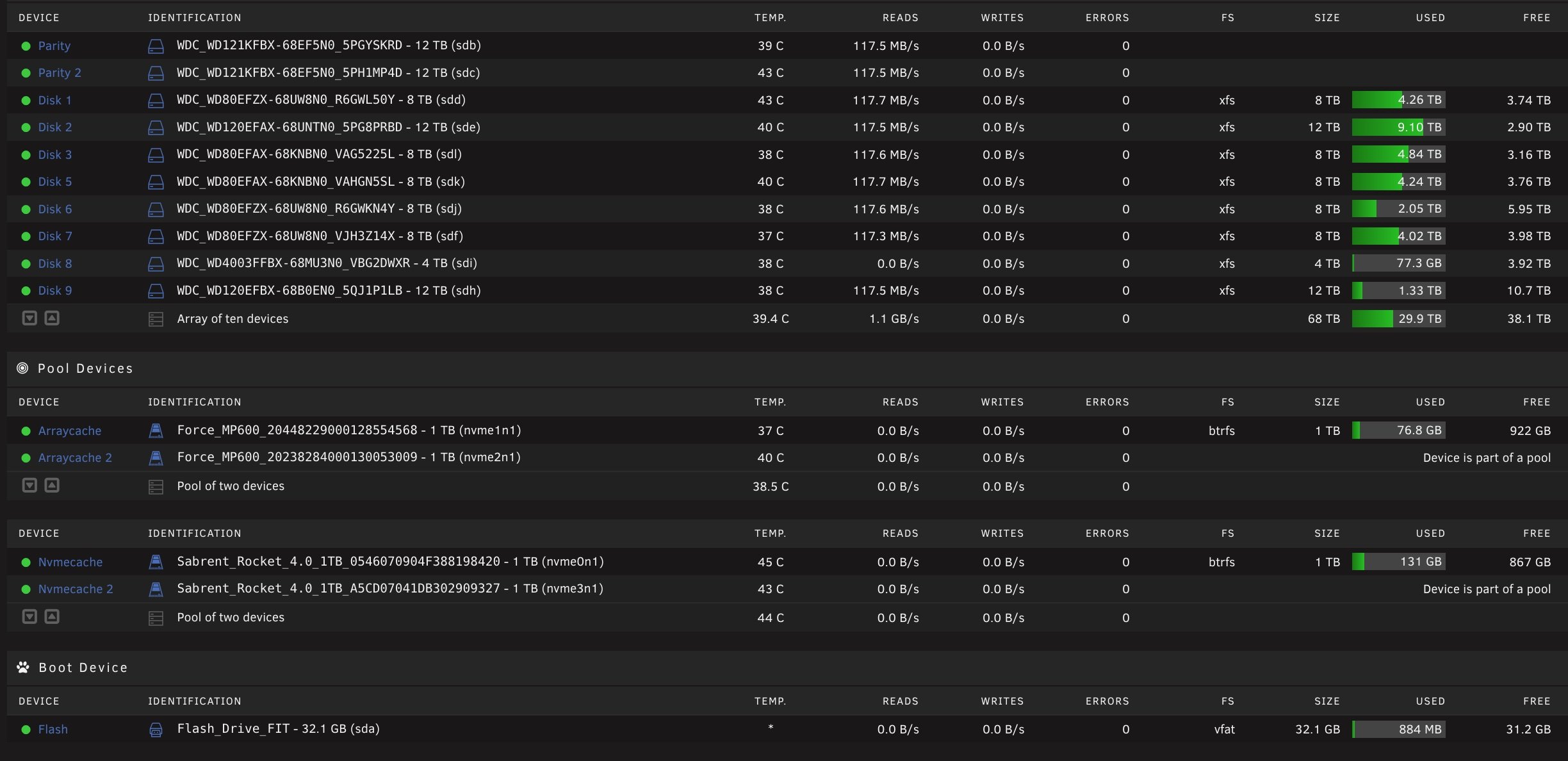

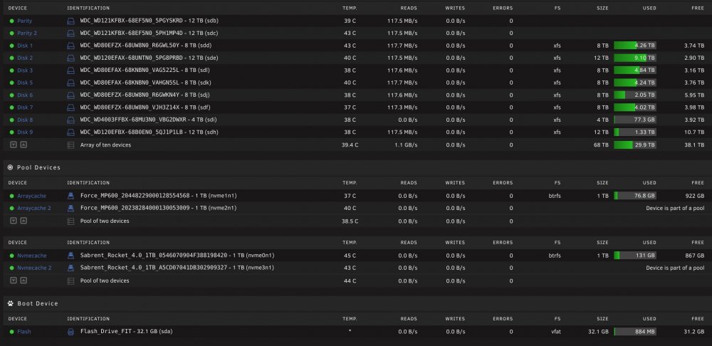

Disk looks healthy.

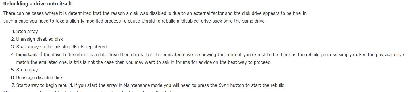

I just want to verify with you, but is this the procedure you would like me to follow to re-enable the disk:
Rebuilding a drive onto itself
I haven't written anything to the disk that I know of. I've disabled mover (set it to run monthly but not til the 1st of the month), disabled my dockers, and haven't written to the data disks from other computers in my house.
No, I mentioned doing a new config: Tools -> New Config, keep all assignments, check parity is already valid before array start, then run a correcting check.
Note that this is also a valid option bur only if the emulated disk6 is mounting and contents look correct.

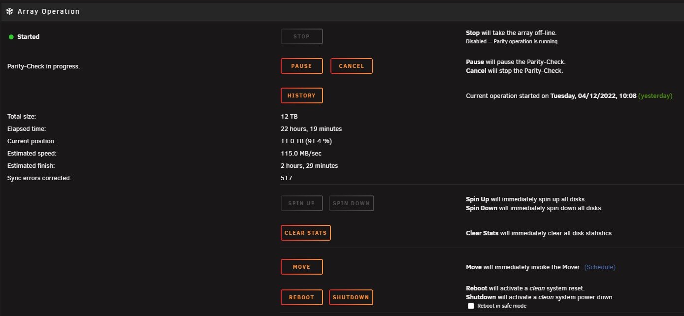

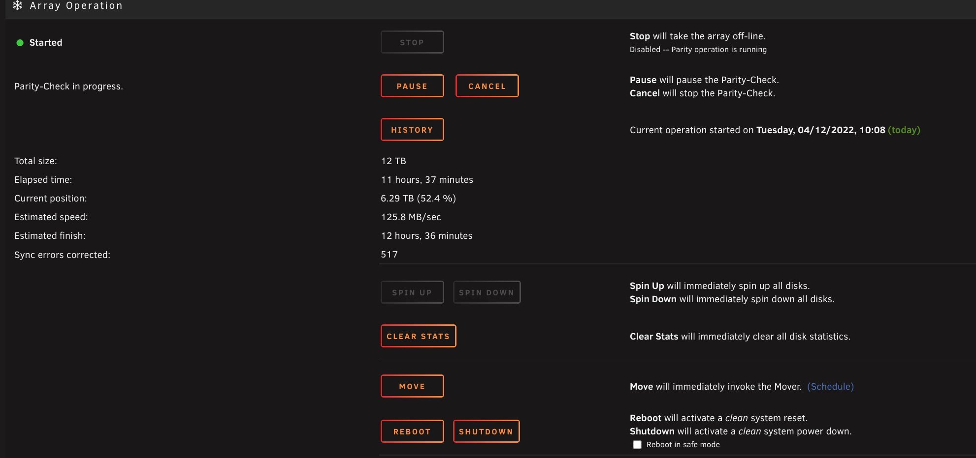

Just wanted to give an update:
I'm in the middle of the correcting parity check and I'm at 517 sync errors. I'm not seeing any errors on the disks though.
Should I do another correcting parity check after this finishes or just a parity check?
I understand that a parity check should always come back with 0 errors. So I assume I should do another correcting parity check instead of wasting time doing a parity check then having to do another correcting parity check after finding errors with a parity check.

If you are running a correcting check then it should be fixing the errors reported.    The next check should be non-correcting and if everything is good will come back with 0 errors.
Some sync errors are expected because of what happened, just let it finish, like mentioned by itimpi you can then run a non correcting check if you want to confirm all is fine, and it should be.

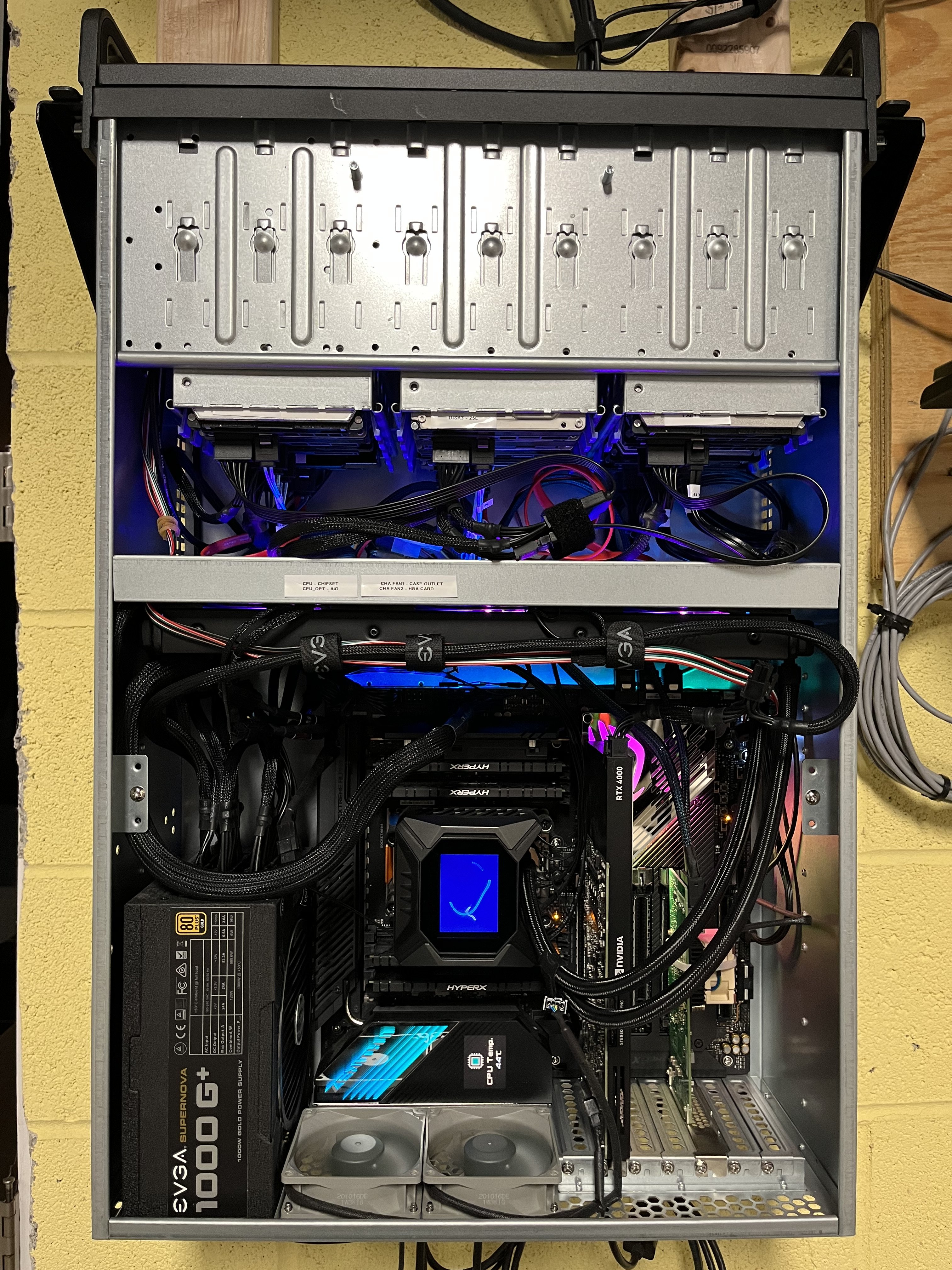

I finally had time to move my server into a new case.
I moved to a Rosewill RSV-L4500U, which doesn't have a SATA backplane/Hot Swap bays. It has three 5 disk bays. I ordered new SATA power cables because my power supply only has four 1x3 ones. I wish they made 1x5 cables, but I got 1x4 from EVGA 4x SATA Cable (Single). I also got extensions to run to the 5th disk in each bay from my fourth SATA power cable. Cable management is difficult without purchasing custom cables (which I'm not going to do).
Wish I could use the software for the MSI MPG Series CORELIQUID K360 AIO I have for it, but I'm just using the motherboard's fan controllers.
I have 4 disks (including the 2 Parity disks) connected to my motherboard's TRX40 chipset controller.
I have the remaining 8 disks connected to my HBA LSI 9300 8i card.
I will have 2 disks that will be connected to my motherboard's ASmedia's controller as spares.
I'm currently running a Correcting Parity Check. I will do a Non-Correcting Parity Check after it finishes.
I'm sure there will be errors since I stopped the Correcting Parity Check before it finished.
I haven't seen any errors being reported since switching to the new case. Fingers crossed that it was the old case's backplane causing all my errors.
