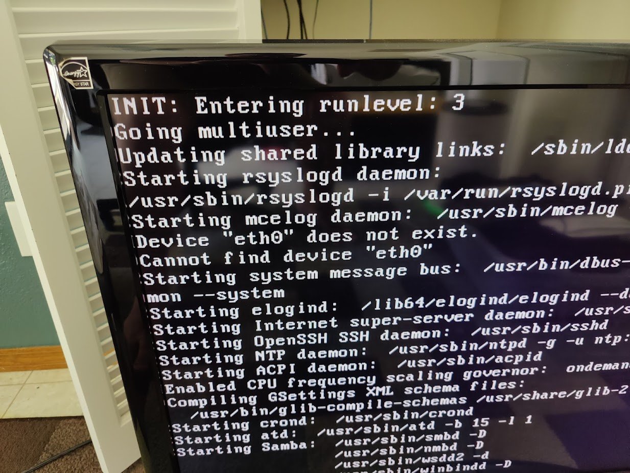

Just updated to 6.10.2 and, not, my host is unreachable. After stealing a TV from another room, OS seems to boot fine but I cannot get my box to talk to the network. Upon booting, the Unraid login screen (CLI) says IPv4 Not Set and IPv6 Not Set. I checking my network.cfg and it showed DHCP, Bonding, and Bridging as "yes" with no IP, gateway, or mask set. I tried setting all three to no and setting the IP, gateway, and mask manually but was still unable to reach the box.
During boot, I did catch the wording: "Device 'eth0' does not exist. Cannot find device 'eth0'" (image attached). Is that because of binding/bridging?
I couldn't imagine the process of a reboot borking my NIC... Please let me know what I can try to fix this issue.

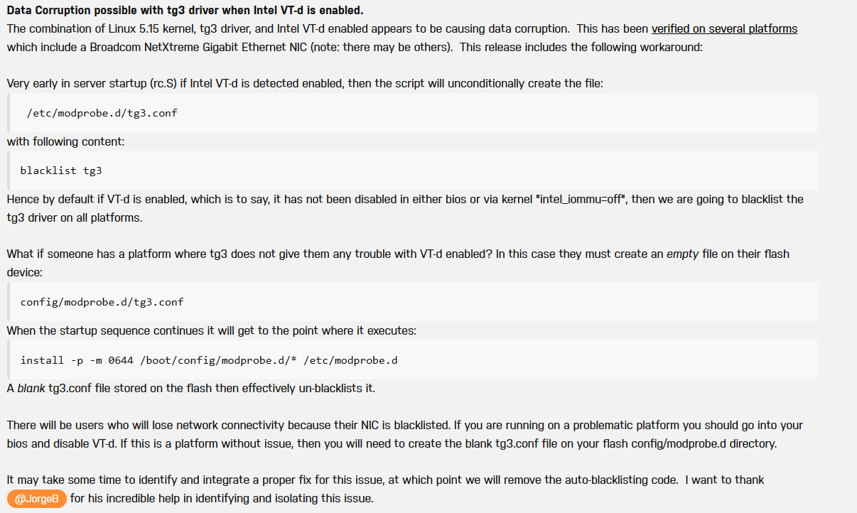

Solved by Frank1940
See here: (Release notes for 6.10.2):
and here:

It is a Poweredge T420. I ran diagnostics but am not sure how to get them off the box being as how it's CLI only at this point. Simple guide for that somewhere?
Looking in to this now... this looks promising.

Working on one of the above attempts now (disabled Intel Virtualization in BIOS). I think that is probably along the lines of the issue. I will upload logs next though for sure.
Does disabling Intel Virtualization (I can't find anything that is just VT-d) mean I cannot run VM's on this installation? I'm not anyways, just wanting to make sure I know the ramifications.
Hallelujah! Disabling Intel Virtualization did fix the NIC issue and I am able to access my UI via XXXXX.unraid.net. All docker containers up and accessible too (just validating that everything is as it should be.)

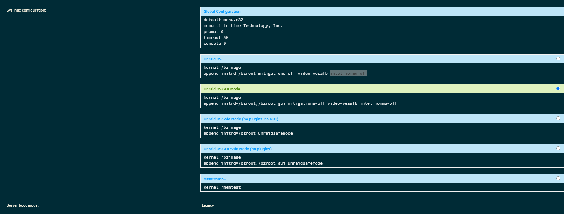

Virtualization can be enabled but VT-d specifically needs to be disabled.  If you don't have a VT-d option like I do not then add this to the syslinux config by clicking on the flash drive under Main.
intel_iommu=off
Then reboot.
Screenshot shows where to put it.
Virtualization will work if you need it in the future but you will not be able to passthrough devices to the VM
OK. Cool. Mine did not have VT-d so I will add that to syslinux. Later, I will go back in and enable virtualization in the BIOS. I do plan to do GPU passthrough eventually, so hopefully this does get fixed in a future version.

You can also just disable vt-d by adding 'intel_iommu=off' to syslinux.cfg, see how to here.
