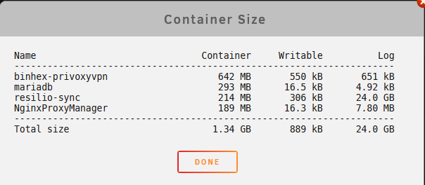

I did take a quick look in docker->container size and suspect resilio-sync may be the issue;
But not sure what needs to be changed.

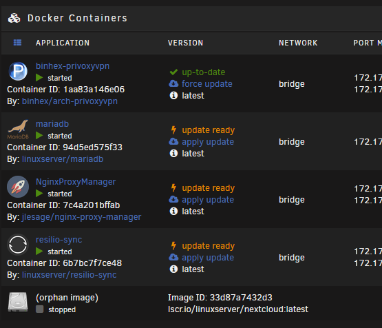

Also when I switch to advanced view in dockers, I see an 'orphaned image' which says it was created a month ago - I suspect that this is from when the same thing happened with Nextcloud a few weeks ago - do I need to do anything with this, or will UnRAID sort it out when I reinstall NextCloud?
24G logs is taking most of your docker.img. I don't use that docker but see if you can figure out why it is logging so much and fix it.
7 minutes ago, SliMat said:
'orphaned image'
delete it

I edited the resilio-sync docker so it cleared the log file... now I know where the issue is, I will post in the relevant support forum to try and find out why this docker is filling up docker.img with log files. The conainter is now back to 5Mb, until Resilio Sync fills it up again 🙂 At least I have some time to sort it out now 👍
EDIT - I logged into the Resilio-Sync GUI and found "debug logging" is enabled by default... so have unchecked this and hopefully thats an end to this issue 🙂
