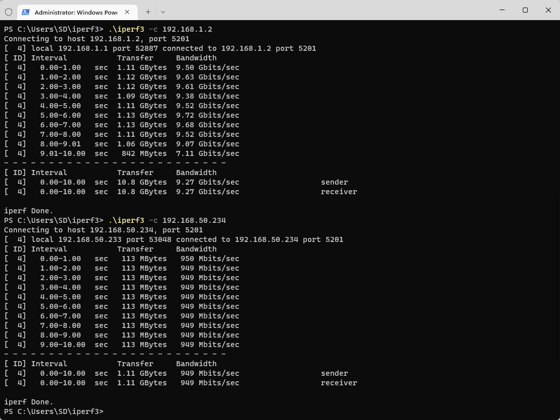

Start by running a single stream iperf test to check network throughput.
Thanks. Here is are the results, first NIC 192.168.1.2 is the 10GBE, second is a bonded 802.3ad 2xGBE connection.

Yes, the 10GBE connection consists of two identical Mellanox ConnectX-3 NICs connected with a 10G SFP+ Direct-Attach Cable

Most likely, network bandwidth looks good, you can get better speeds transferring to a cache pool with one or more fast flash devices.

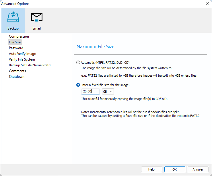

For images you could set Macrium Reflect to split the backups to a size smaller than your "min free space" setting in the advanced options. The decision of where to put each file is taken at file creation so when Reflect starts creating the next split it would take place and be redirected if needed.
Thanks. I was using this approach but the problem is then that incremental backups can't be done, resulting in having to do a full backup every time which is tedious for multi terabyte backup images. I'm getting around this by just doing a simple file & folder backup, which is smaller and easier to manage.
