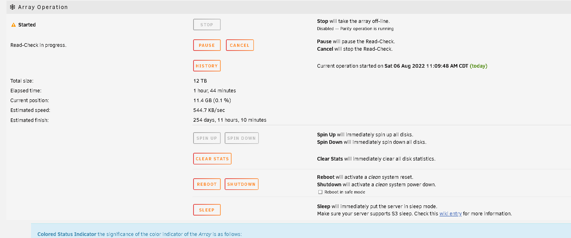

Help - Read-Check will take 176 Days to complete.
Hey there,
I need some help. I have an unraid (6.9.2) system that I have had in operation for about 2 years now. I have never had any issues. It is mainly used for media and for backing up several computers. I recently had the opportunity to purchase 3 - 12TB HDD's. I had a 6TB Parity, 4 - 4TB HD, 4 - 3TB HDD, and a 240GB SSD. Never had an issue. I precleared 1 of the 12TB HDD and then added it to Parity so I could add the other 2 - 12TB down the road. After the 12TB Parity was installed and running good I removed the 6TB Parity so I could add a 12 TB HDD. This went fine. I added a 12TB HDD to the Array, all good. I added the last 12 TB HDD, all good. After about 1 day one of the 4TB HDD in the array failed. I checked sata and power cables, even switched the cables from another HDD in the Array, no change. I removed the effected 4TB HDD from the Array assignment. After I brought the system back up orange triangle with exclamation. I started read-check but it is saying 176 days to complete. Do I really have to wait for half a year to get back to parity? With read-check working on the system I am not able to access a lot of the data on the system.

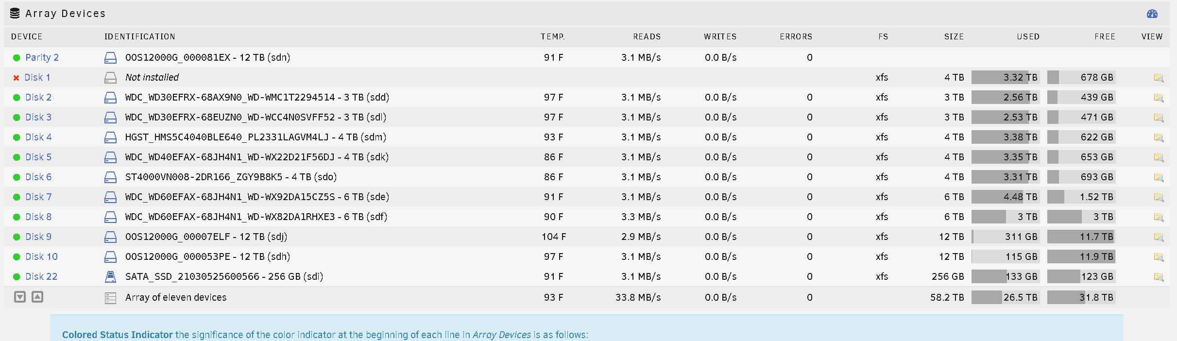

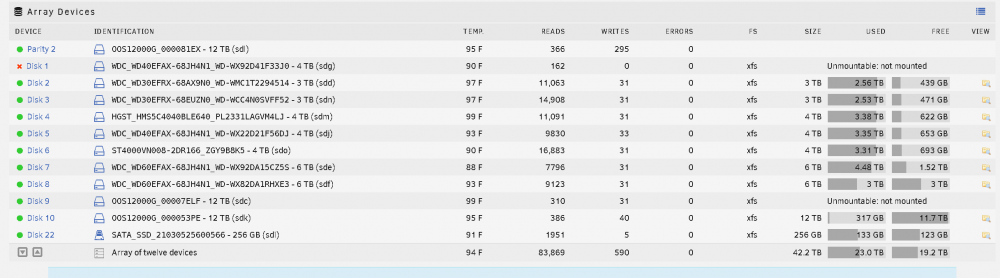

Why do you have parity2 but no parity?
And it looks like what should be your cache you have assigned as disk22 in the parity array
Parity 1 was a 6TB HDD. I had to remove it from the Array to add the 12TB HDD. I tried moving parity 2 to parity but it would not let me.
Disk1 has corruption but is mounted. That shouldn't affect parity check anyway.
Not sure why we are talking about read check.
Post a screenshot of Main - Array Devices.
Yes, disk22 was part of the original build and I just left it there. Planning on re-assigning to cache but I guess that will have to wait until I get everything back in order.

I read somewhere in the forums about running the read-check if parity is not valid.

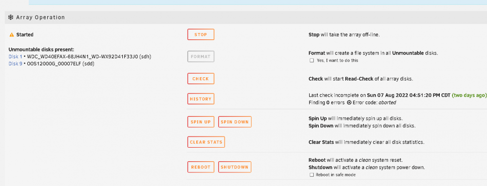

Now post a screenshot of Main - Array Operation
Why do you think parity is not valid? Don't really see what the point of read check would be even if parity wasn't valid.
Main - Array Operation??
Yes, a screenshot of Main - Array Operation.
Why the question?
If you aren't using tabbed view, then Array Operation is at the bottom of Main after all the devices
Sorry, I was confused on what you meant.

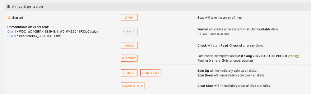

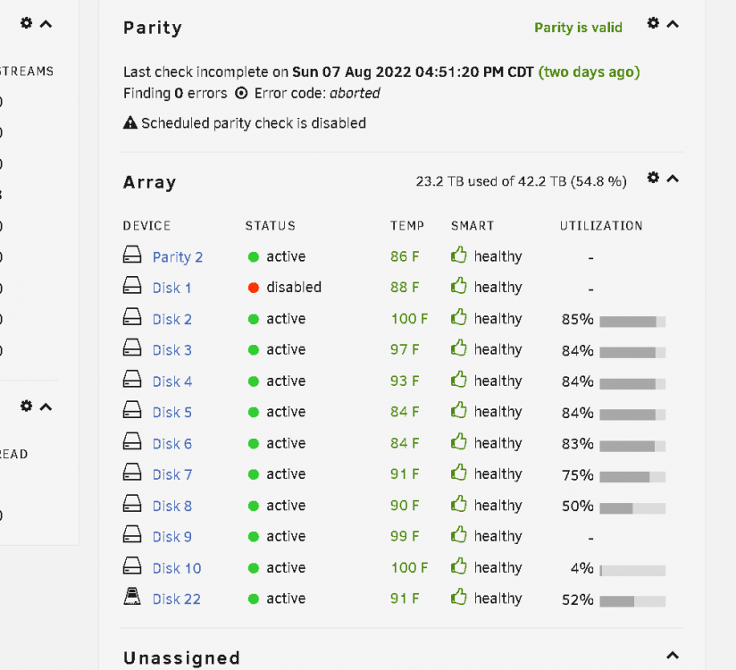

5 minutes ago, StewLoft said:
When the system finished bringing the array up I had the orange triangle with the exclamation and it showed Array started, parity not valid
If parity2 had not finished building then it would be invalid. Your previous screenshot showed parity2 green and diagnostics doesn't say it is invalid.
Did you let parity2 rebuild finish or not?
Yes, after I added the 12 TB to parity it showed valid. After I removed the 6TB parity it was valid. It went invalid when disc1 failed.
Where is it saying anything is invalid?
