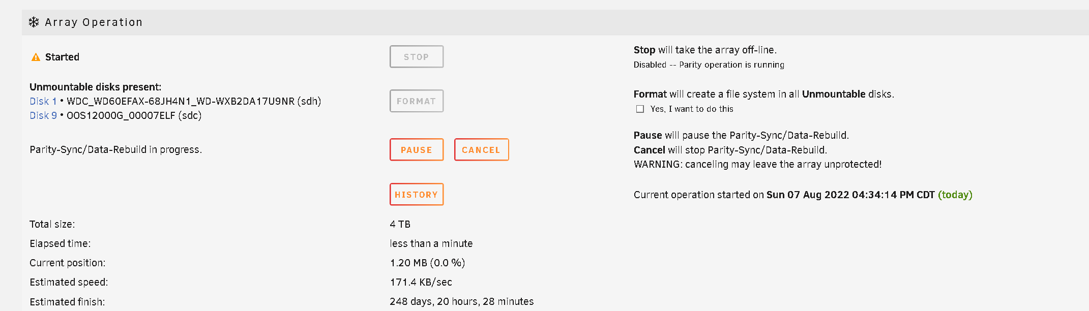

Help - Read-Check will take 176 Days to complete.

Post a screenshot of Array Operation.

So, we need new diagnostics with the array started, and screenshot of Array Devices.
