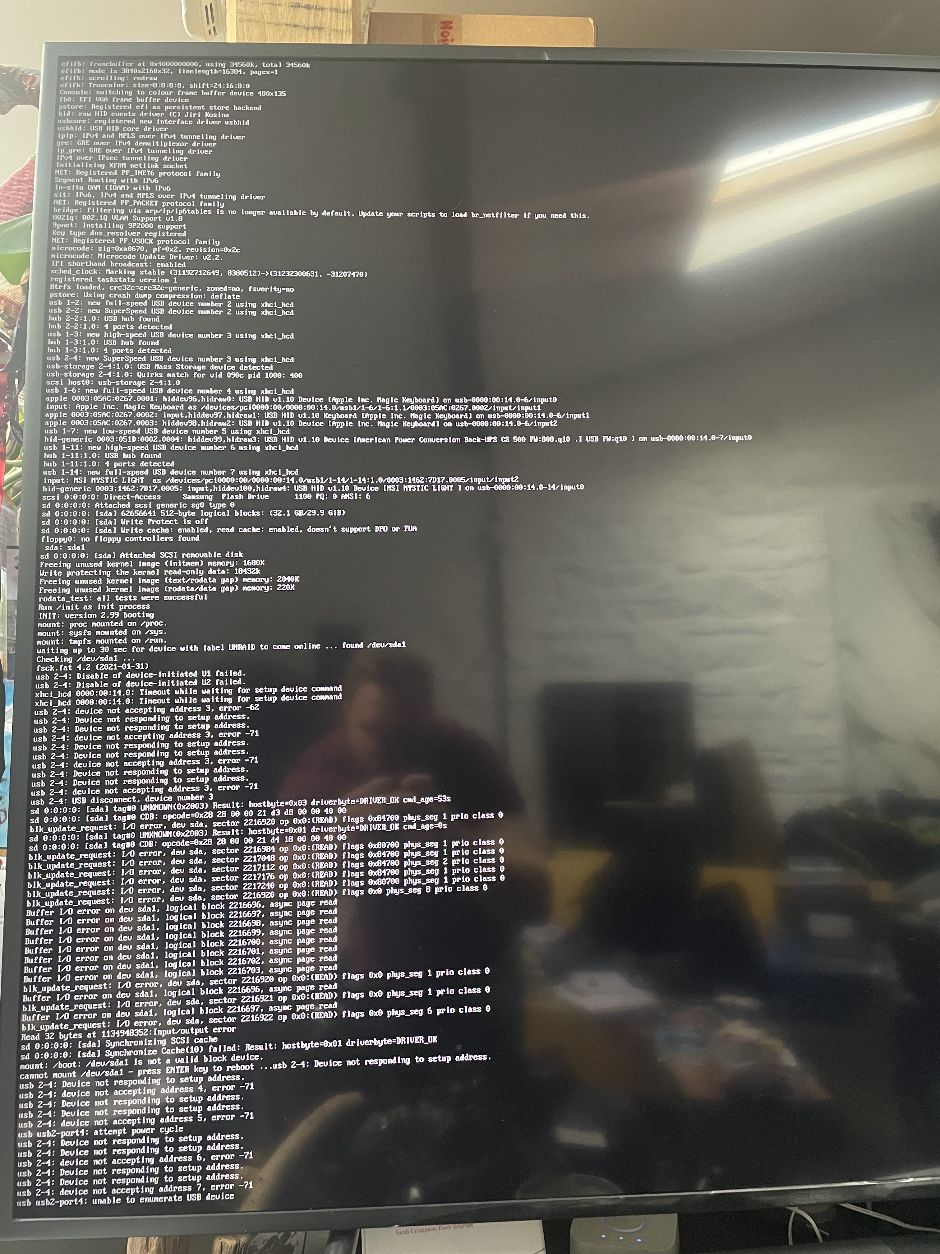

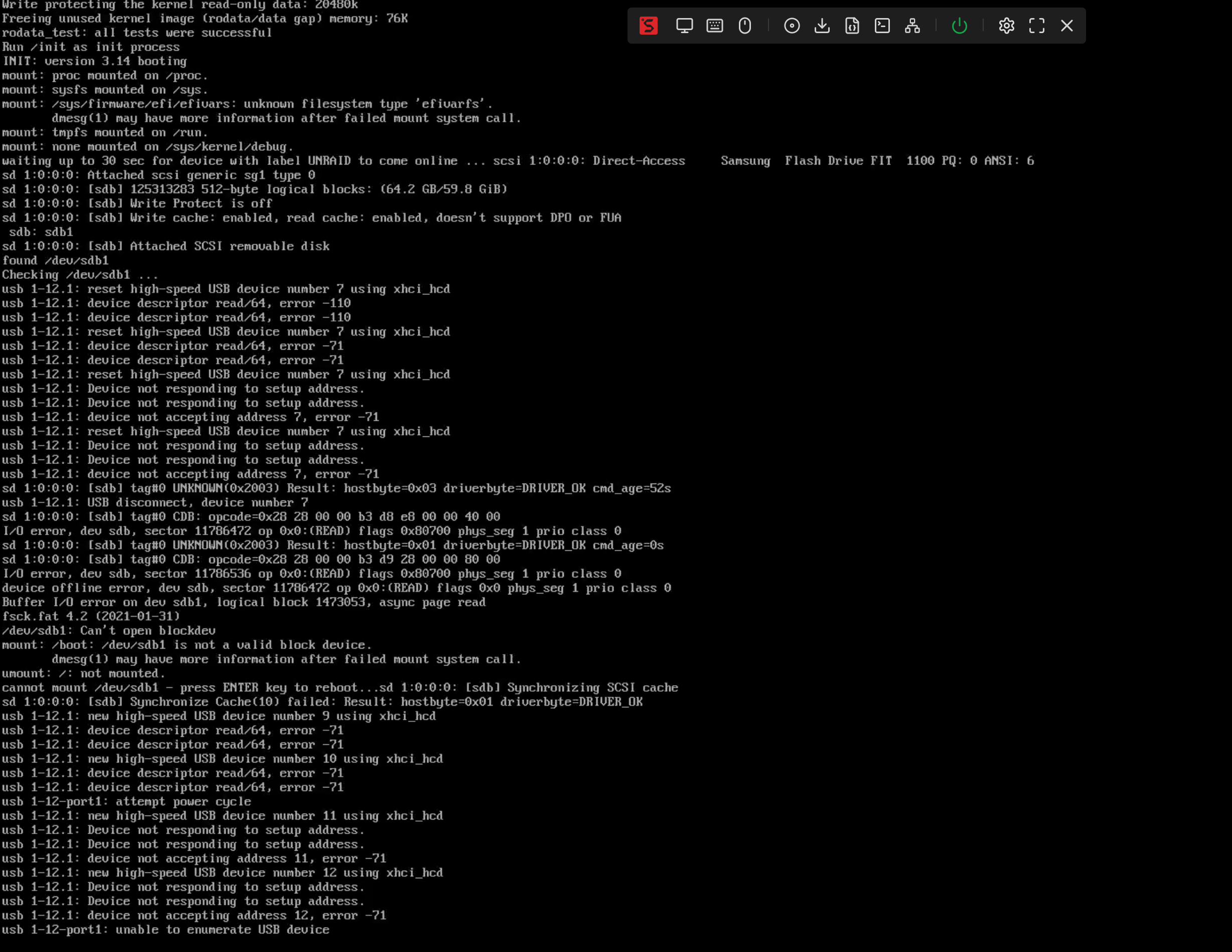

I have been having the same issue with a SAMSUNG FIT Plus.
The only way I can fix it is to move the USB stick to a different port which means I need to always be next to the server, which defeats the purpose of having a server.
I asked in discord and they kept telling me it is my hardware, their software is fine.
If my hardware is the problem, what hardware is your OS is supporting? Where can I find a list of supported motherboards, processors, hard drives etc?
I am in the same boat as everybody above, guys from team should have a look and at least communicate with users to NOT USE Samsung usb sticks.
I have Samsung Bar 64GB bought directly from samsung store, no chance for counterfeit etc.
And I am seeing exactly same behaviour as above, same errors after restarts, sometimes I am able to restart unraid server 2-3 times without any issues, but then good luck, and the only way to fix it is to move it from port to port, shame that have my usb slot inside the case... Which cause a lot of headache. Anyway today is the last day on the stick as I am moving into card reader and proper card.

On 9/22/2022 at 6:18 AM, dopeytree said:
e to enumerate USB devi
I have the same issue with multiple samsung bar usb drives now
