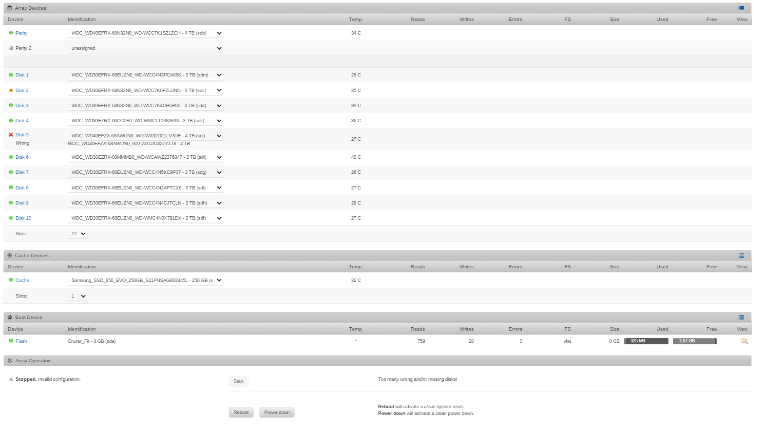

I switched back disk5, but cant start the array because it says "Too many wrong and/or missing disks!". Attached diagnostics anyway, if thats any help!
file-server-diagnostics-20220925-1141.zip

Old disk5 appears to have really failed, but keep it intact for now, we can try re-enabling disk2 to rebuild disk5 again, connet new disk5 again, then:
-Tools -> New Config -> Retain current configuration: All -> Apply
-Check all assignments and assign any missing disk(s) if needed, including old disk2 and new disk5, replacement disk should be same size or larger than the old one
-IMPORTANT - Check both "parity is already valid" and "maintenance mode" and start the array (note that the GUI will still show that data on parity disk(s) will be overwritten, this is normal as it doesn't account for the checkbox, but it won't be as long as it's checked)
-Stop array
-Unassign disk5
-Start array (in normal mode now), ideally the emulated disk will now mount and contents look correct, then post new diags

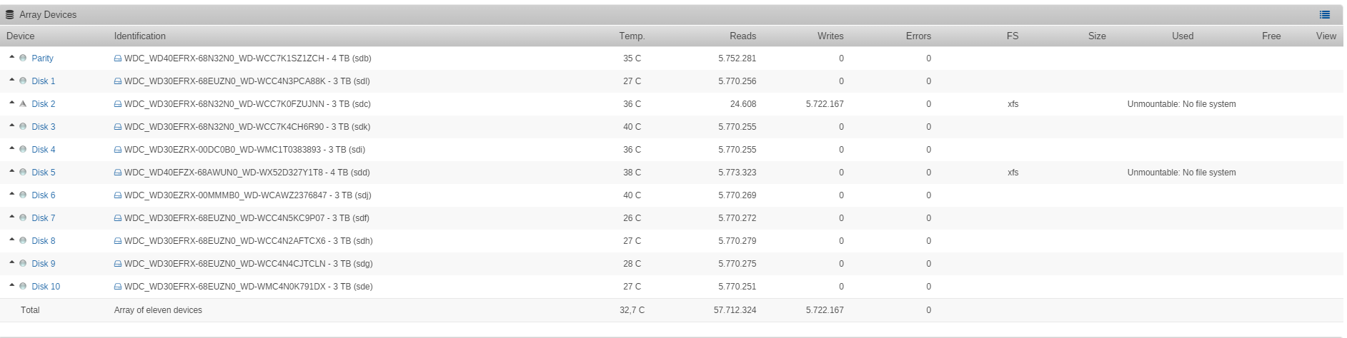

I did as you said above, but disk2 still says "Unmountable: No file system".
Posting diags!
file-server-diagnostics-20220926-2012.zip
Check filesystem on disks 2 and 5, note that you must remove -n or nothing will be done, and if it asks for -L use it.

Your question does make me wonder though. Have you been doing check filesystem from the webUI or from the command line? Easy to get the command wrong, webUI will do it right.
When I try to do it in the webUI I cant see "Check Filesystem Status" on drive2, its on the other drives though
Click on disk2, set the fileystem to xfs and try again.
Same thing again, "Sorry, could not find valid secondary superblock"
Diags after array start in normal mode please.
