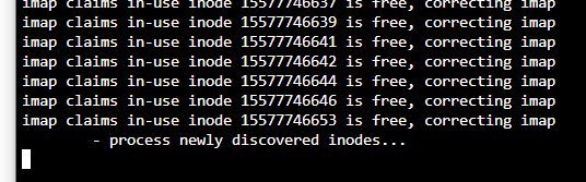

Running one via console; xfs_repair -nv completed so I ran xfs_repair -v and things stalled at process newly discovered inodes...
I quit the process and retried it. This time I let it go for a long time in case it was just taking a while, still stalling in the same spot.

When I ran
xfs_repair -nv /dev/md5
in the console, it finished.
When I ran
xfs_repair -v /dev/md5
in the console, it hangs at  process newly discovered inodes...

I assume you mean md3? There's no disk5, try rebooting and run it again from the console, if it still hangs it's likely an xfs_repair problem.

I've rebooted and retried, same issue.

Rebuilding the disk won't help with a filesystem issue, you'd need to wait for a newer xfs_repair release or ask for help in the xfs mailing list.
