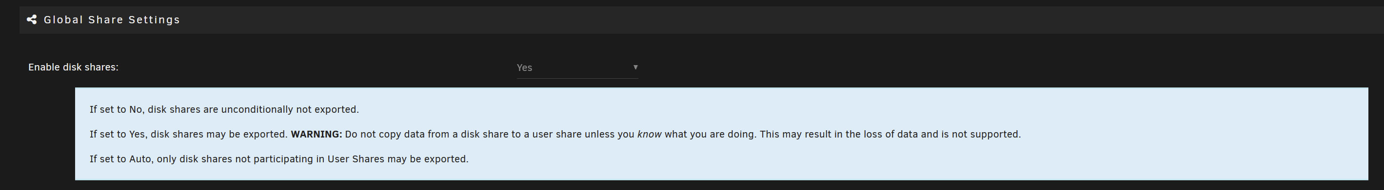

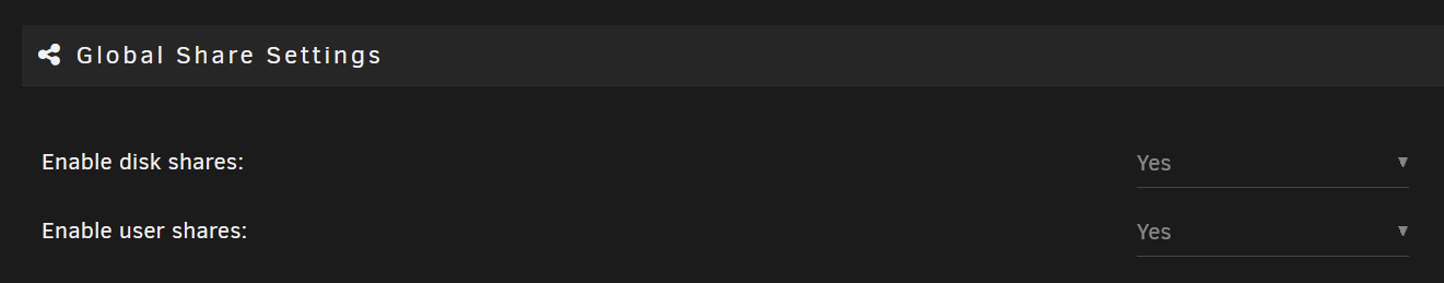

Then you don't have disk shares enabled.
Seems like I do?
1 minute ago, Original_Vecna said:
Seems like I do?

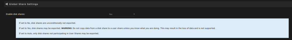

See help notes on Auto (does it apply in your case?):
That's the problem, I can't make a share on this drive. So, I'd say that it is not participating in user shares, since I dont have a share setup on the drive.

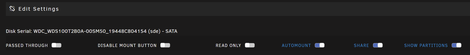

Yeah I have no idea. I was able to get advanced view on, and these settings still don't show up. Found another post that suggested  going to settings of the undefined device and enabling automount, passed through, and share. I've done that, going back in, automount is not staying enabled. I can access the share via windows machine, even writing to it without a login. Zoneminder still wont see it though. This is ridiculous.

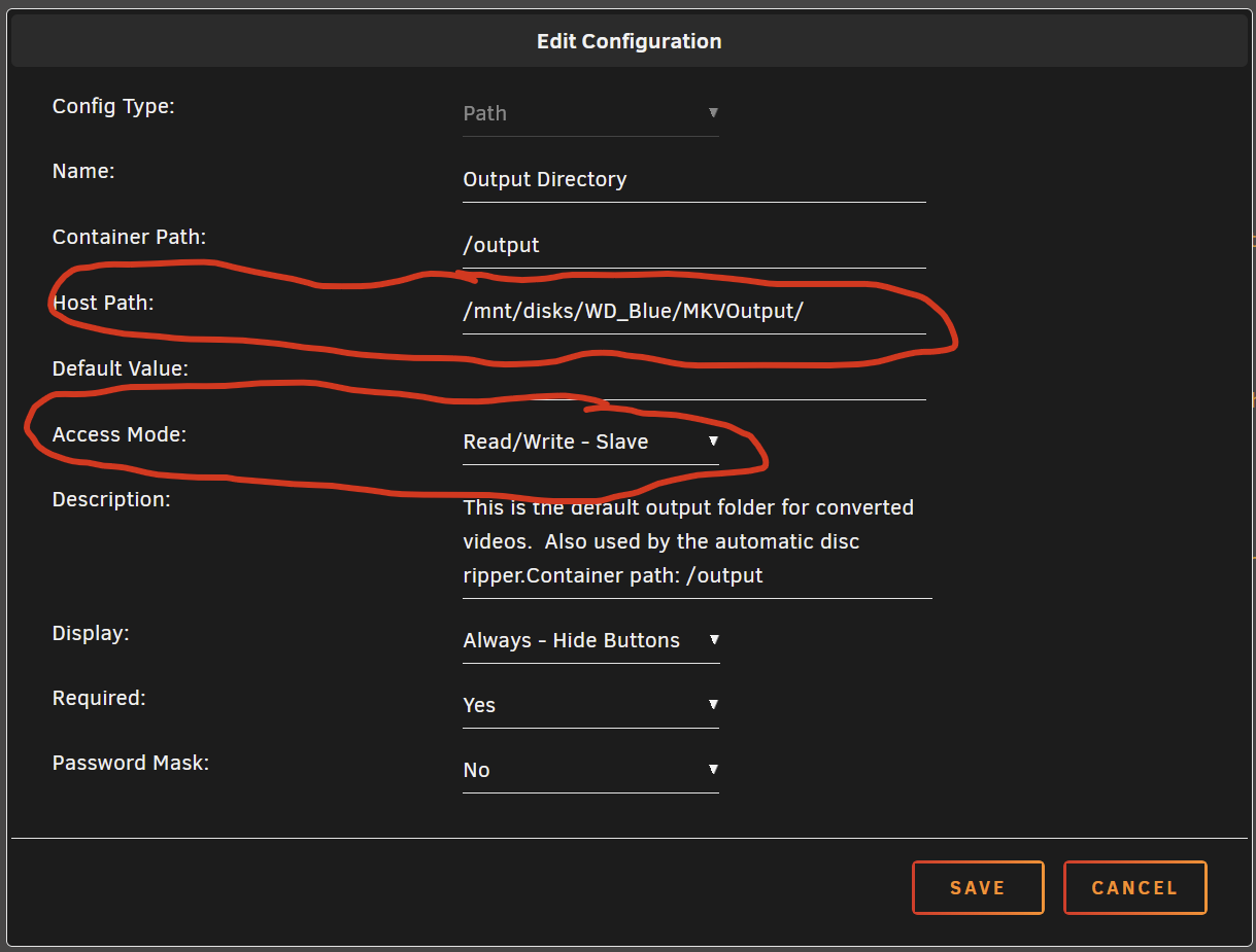

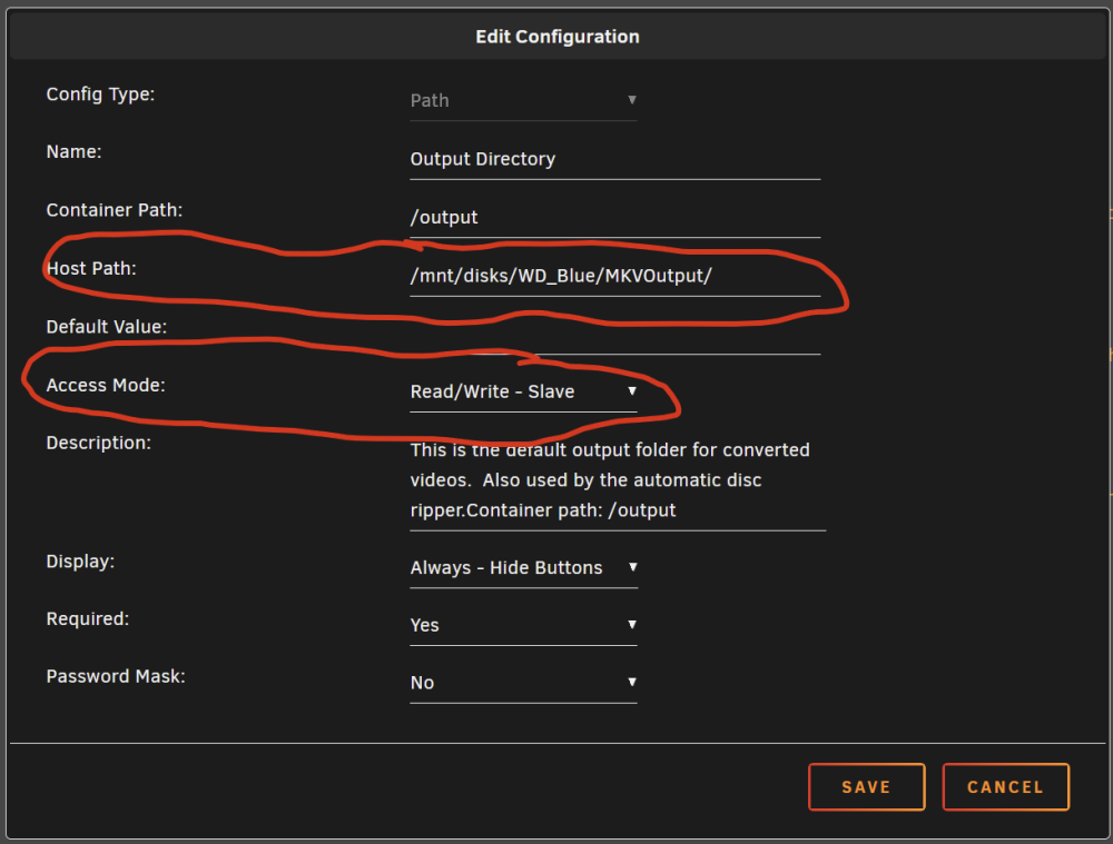

Below is what you should see for reference.  This is a mapping to a UD location for my MakeMKV container that uses a UD location for its output folder.
The path is the UD folder and it is set to R/W Slave access mode.  I know you are having  problems but something like this is what you need to get to.
Here are the settings for the Unassigned Device called WD_Blue:
