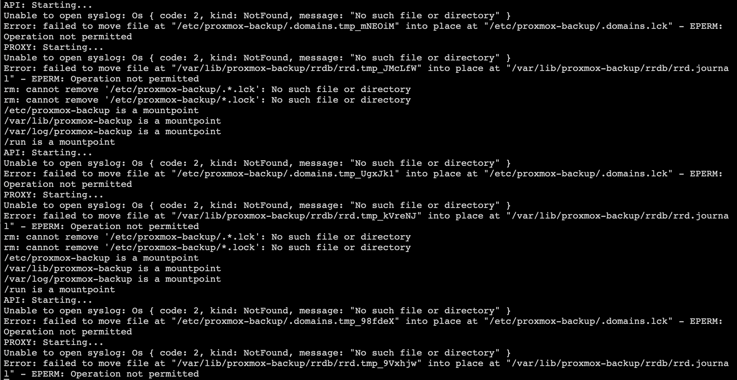

I just realised my PBS was down, I've been running this container for months and now it has the same issue. I tracked down when it failed and I believe it's the same night that I messed up and had to delete my docker.img. The re-deployed PBS container has this issue. I'm fairly confident I was running an up-do-date copy of the docker image before it happened.
The config hasn't changed, the permissions are all user and group 34. I shelled into the container and confirmed that the mappings are working; I also confirmed that the backup user is able to write files to /var/lib/proxmox-backup/rrd and /etc/proxmox-backup.
I think despite the error saying operation not permitted it's not a file permissions error. Something about the move is the operation not permitted, perhaps related to the syslog error?
After poking around a bit more I realised this docker setup was a bit more fragile than I'm comfortable with for critical backups. I've installed PBS into a debian LXC on unraid, using the proxmox apt repo, and migrated the config from appdata into there. Everything seems to be working.
