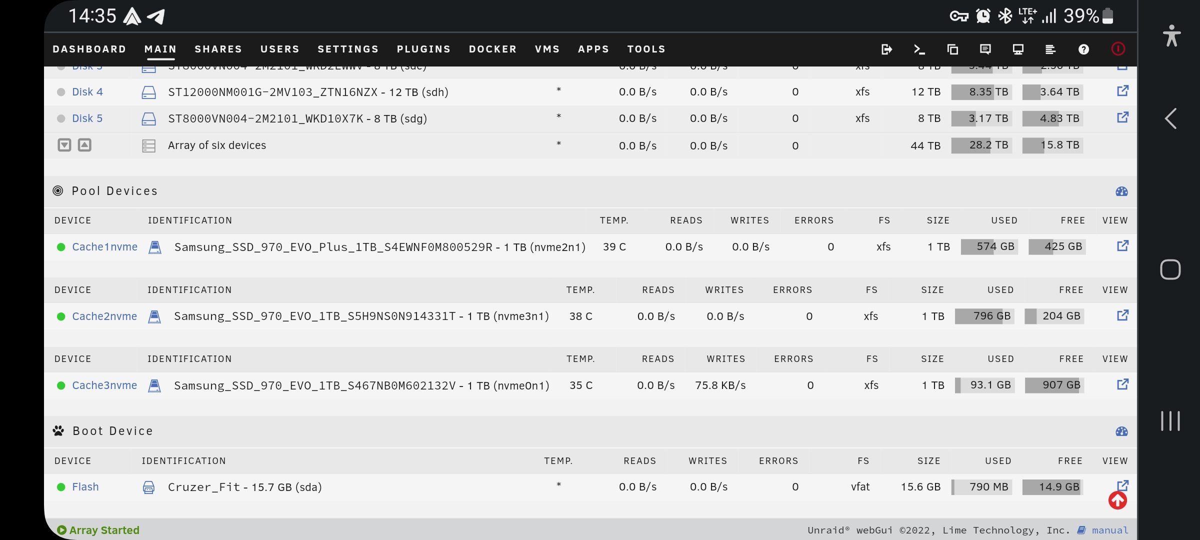

So how do I not make the proxmox backup server NOT use the ssd that stores the docker images?
1 hour ago, UnBeastRaid said:
I see..thank you.

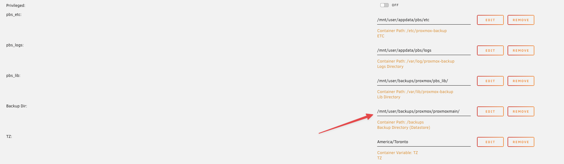

Please the "Backup Dir:" path in the template.
Create a share in your Pool and use this share.

I have done this from the beginning, however, the proxmox gui still shows only 107gb total storage.
in the dashboard check the Datastore
this should reflet the space available to store your backup..... assuming ou create one
Also in the datastore menu you should have that as well

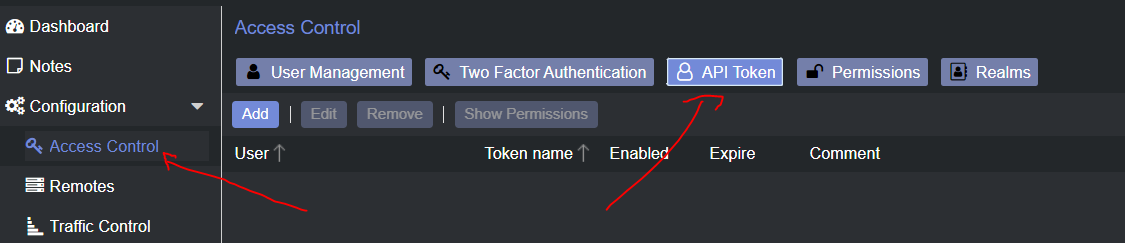

Is there a way to generate an API Token ID and API key for this PBS container?  The place it is supposed to be isnt there unless I am missing something.
I want to use it in Heimdall
Any help is appreciated.  If it isn't added or possible with the container, thats ok as well, I was just curious and would use it if its available.
i think it is there :
Much appreciated and sorry for the delayed response.  I tried that and I am still getting failed with invalid credentials.  the user is admin@pbs if I am not mistaken.  I also tried bypass TLS as well.

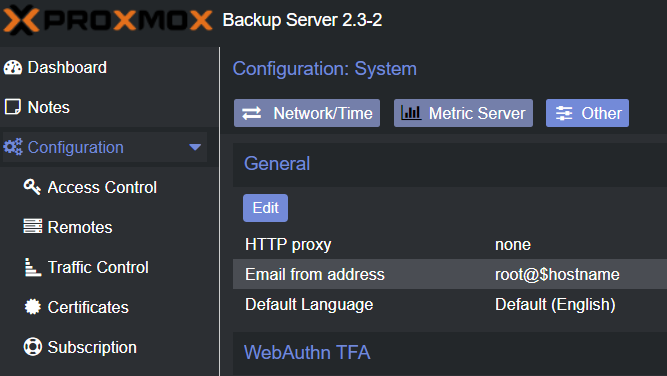

I have another question regarding this container.  I don't see anywhere to set up email/discord notifications to report the status of backups, fail/success.  Any ideas?  Many thanks.  Great container btw
this is not part of the container ,  but part of PBS itself ....
I have PBS running in a container on Unraid.  Does that mean there is a way to set up email notifications or not?  Sorry for my confusion on your reply.

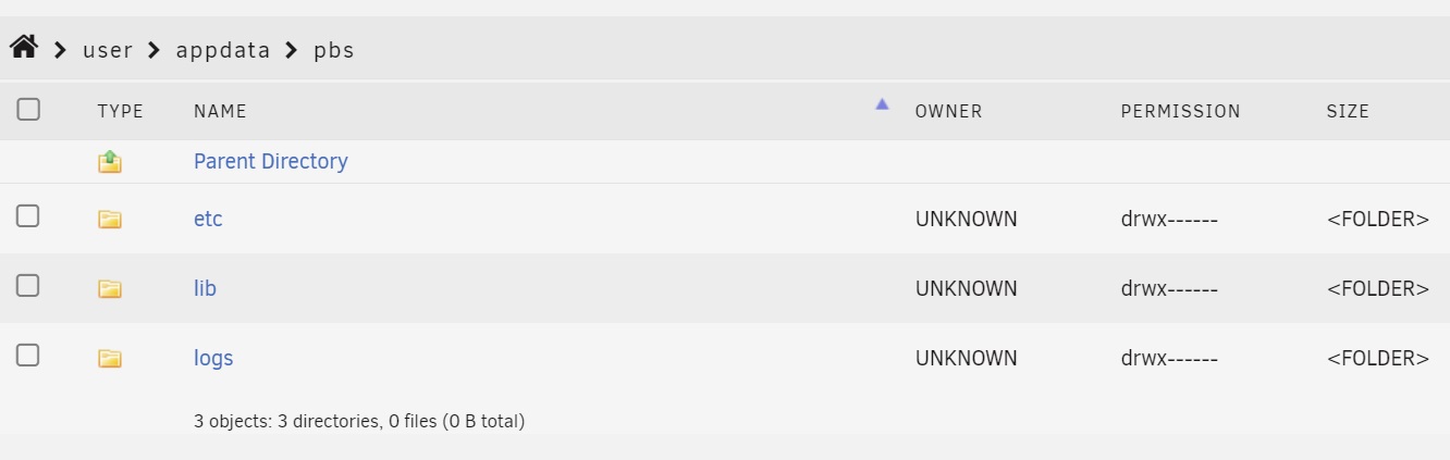

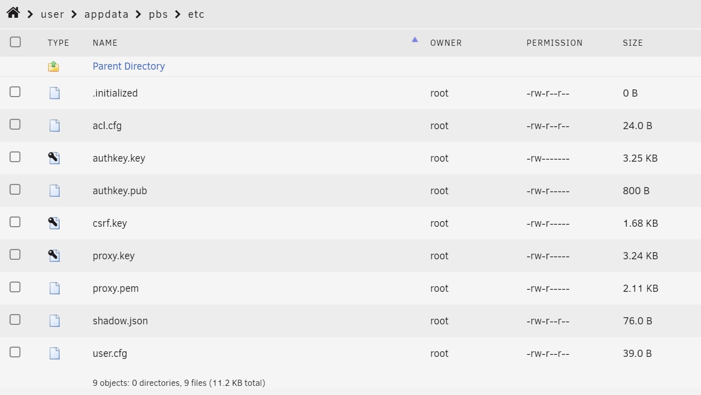

Ok can you show the perm and content of
/mnt/user/appdata/pbs/
/mnt/user/appdata/pbs/etc
Thanks

please post on the github in the issue i link
Thanks
