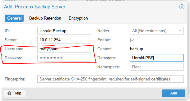

What is the root password to add the PBS as qdevice to a cluster?

Can this credentials be the problem? I just installed PBS as a unraid_VM with same results. TiA
