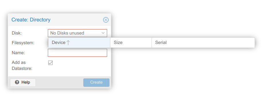

Hello, i install PBS and add new share for it. I cannot see any available drive in dashboard. How to fix that?
