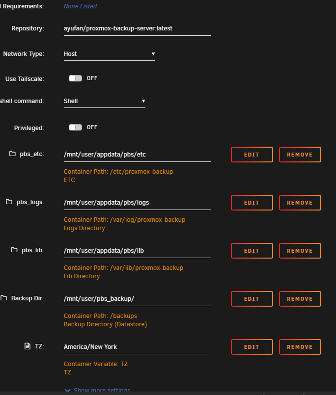

2 hours ago, ZappyZap said:
in the template,
please show me your setting for the mounting part (pbs_etc,  pbs_logs,  pbs_lib, Backup Dir)
and also
the permision of those dir on the array
thanks
I left everything with default values.
drop in a shell and provide output of :
ls -al /mnt/user/appdata/pbs
ls -la /mnt/user/pbs_backup
Thanks

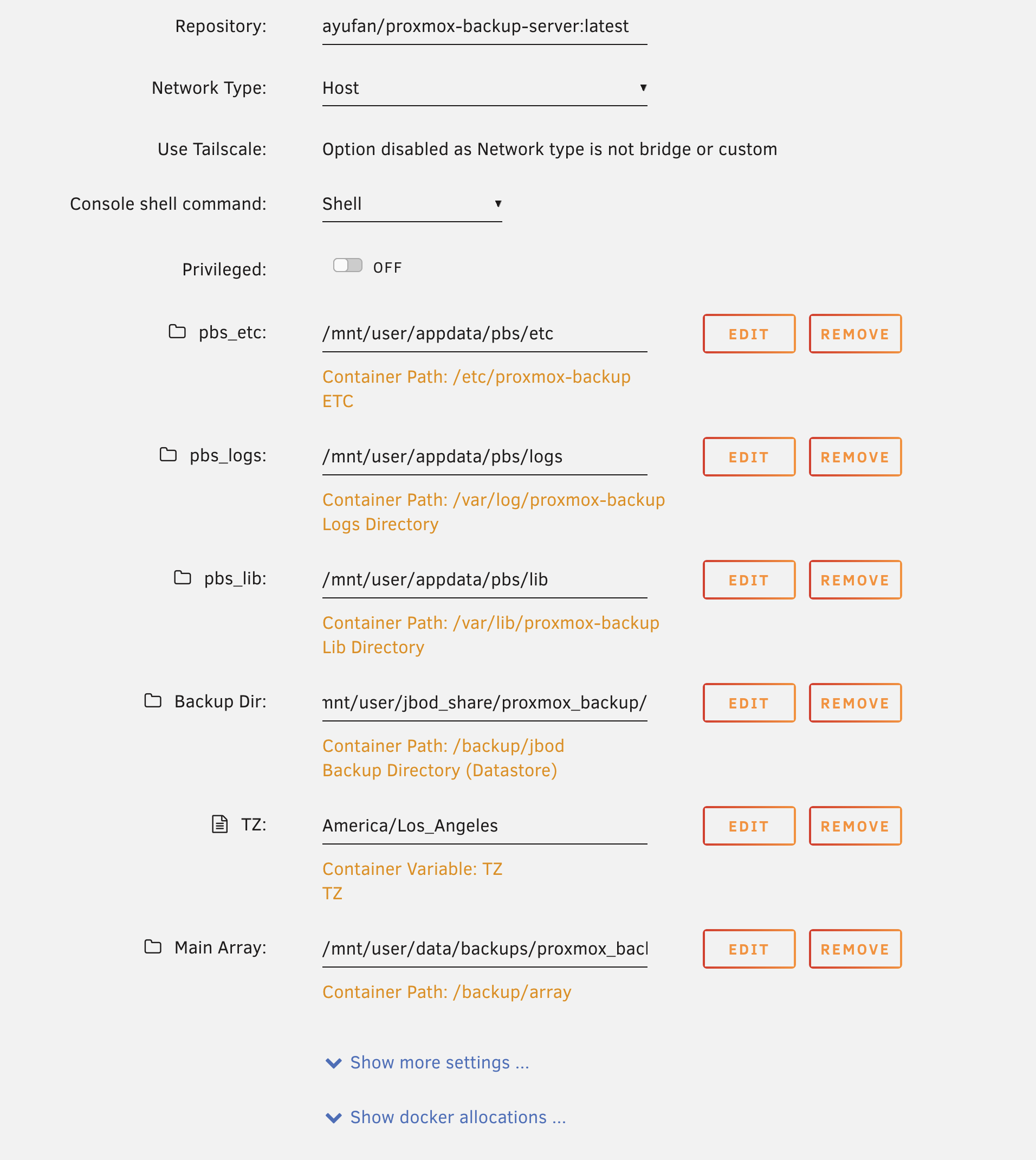

1 hour ago, myusername said:
it seems to be that no matter the settings on this update, PBS is using the docker vDISK for backup storage regardless of the settings when setting up the docker container on unraid, and/or configuring the datastore within PBS itself
Is this in reply to the issue I posted?
My configuration should be pretty normal, any clue why it would behave this way?

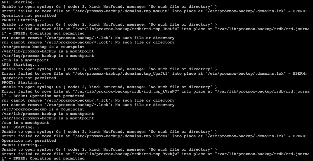

Hello, I installed this for the first time and nothing comes up from the webui. Took all the defaults, only changed the Timezone.. Any idea what the issue is? Here is what the log says
check the permission of your mount point in the Host.

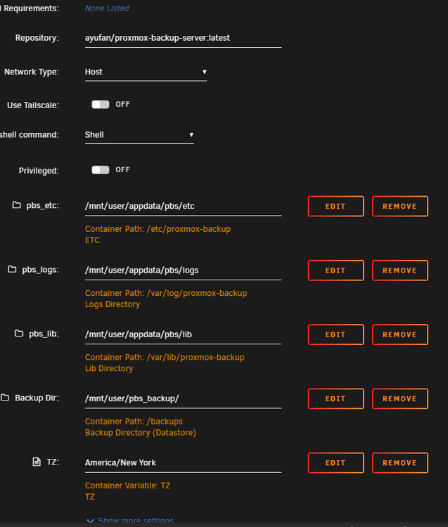

Its just the standard appdata path /mnt/user/appdata where all my other docker containers reside, all permissions are ok there. Is there something specific i need to do for this that i missed somewhere? Everything i left default.
please post the permission
Is this what you want?
can you put the perm of.
Seem like your directory are not correctly set
for /etc/proxmox-backup. you have set /mnt/user/appdata/pbs/etc
but the etc. directory seems to be in /mnt/user/pbs_backup
Edited by ZappyZap
Hmm, like i said above i did not change anything. I just took the defaults of the container.. so that is strange..

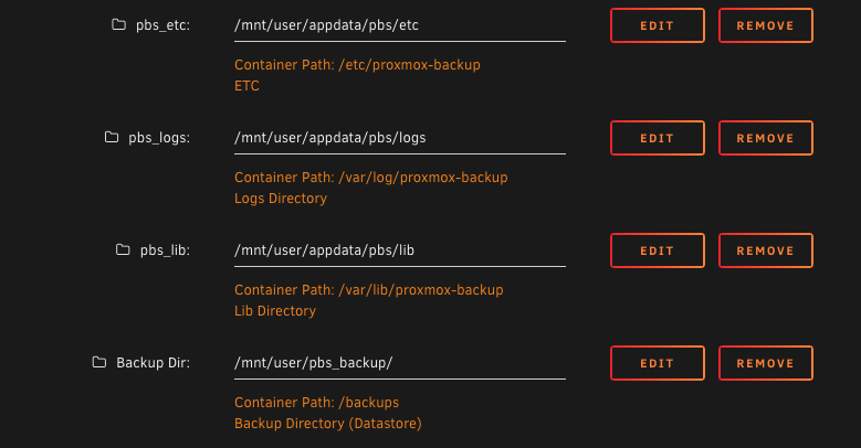

here are the default for this template :
and your SS match it
but your FS seems to say otherwise
Edited by ZappyZap
maybe i am being dense but can you explain to me how the FS says otherwise? Your screenshot matches mine exactly and above you said i have mine set to this below, but the template is set that way as well? I don't get what I am missing.
on you ss , of /mnt/user/pbs_backup , i see you have etc, logs and lib directory
they should be in /mnt/user/appdata/pbs
unless i am mistaken

also just an FYI i loaded the PDM as well, same issue, cannot get to web interface.. Something is strange with these two. Only happens with these. All other containers have installed with zero issues. Have been running this server for 10+ years.. on 7.2 now if that makes any difference..
EDIT: Same issue, deleted, cleared everything, no luck.. Appreciate the help but i dont know what is wrong. I did notice this on install.
