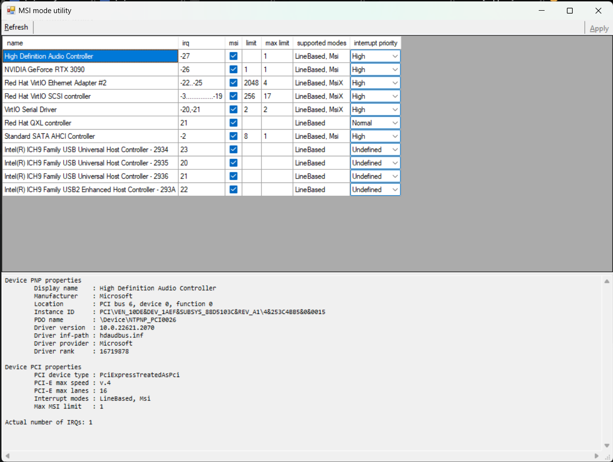

On 4/19/2024 at 8:30 PM, shpitz461 said:
Another thing to do on Windows to improve latency is turning on MSI feature for PCIe devices.
See here for the utility:
https://forums.guru3d.com/threads/windows-line-based-vs-message-signaled-based-interrupts-msi-tool.378044/
I've turned on all mine on and set priority to High:
This can help, when you have a dedicated GPU in passthrough mode. You are not using it correctly though (although no harm done either). You can enable MSI interrupts for devices where MSI or MSI-X is listed under supported modes. If "LineBased" is the only option under supported modes you did nothing. On every VM I checked MSI was enabled for all devices that supported it. I don't believe it's as big of a deal before as it used to be before for passthrough GPUs as vendors now support passthrough to VM for the most part and they didn't before.
'Not correctly' in what way?
I'm passing a 3090, MSI is enabled on the host (unraid):
Capabilities: [68] MSI: Enable+ Count=1/1 Maskable- 64bit+
Enabling MSI in Windows improved the smoothness of the experience, I'm remoting to the VM via Parsec.
You've enabled MSI interrupts for devices that only show "LineBased". If 3090 didn't have it enabled by default, that's the only benefit. I had a different nVidia GPU passed through (1660S ?) and it had MSI enabled by default without me changing anything with new nvidia drivers. YMMV on this though, it might still be useful for the GPUs.
