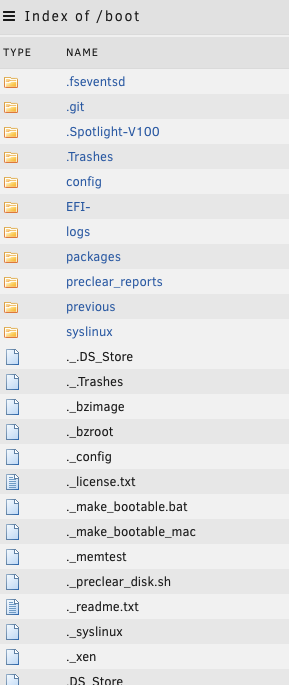

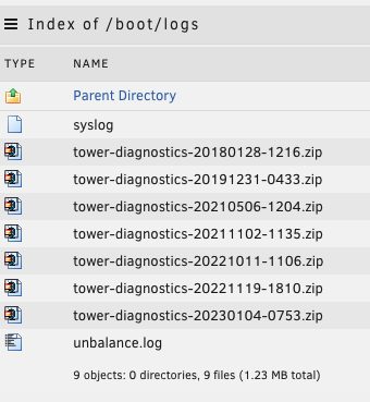

17 minutes ago, trurl said:
Thank you, I have set it to "mirror to flash." Is this file visible as soon as apply and done are clicked, or only after a shutdown/crash? I do not see it appearing yet on the flash drive. Thank you
Where (how?) are you looking?
I wasn't able to see it by browsing on my mac to the flash drive, but I can see it by browsing through the GUI on the "Main" tab for my server.  I have attached the current file that I believe is it. However, the server has not crashed yet.
syslog

It crashed last night and I was able to boot it up for about 5 minutes just now and this is the only log I was able to get from the flash drive before it crashed again (this time being 5 minutes into booting rather than 10-12 or so hours yesterday. There was no tower-diagnostic with any dates other than the attachment in my previous post. Should there have been one with yesterday's date on it?
