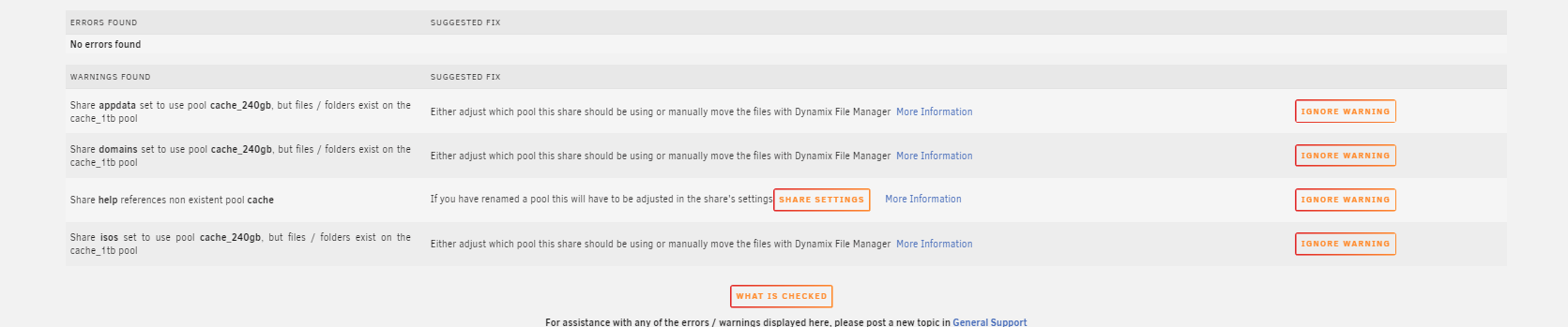

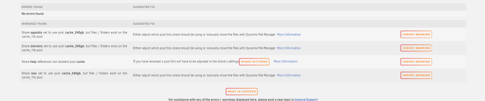

kysdaddy Posted January 27, 2023 Author Share Posted January 27, 2023 I am still getting these warnings in common problems. Should I have moved files manually? Quote Link to comment
trurl Posted January 27, 2023 Share Posted January 27, 2023 Mover moves cache:yes shares from the designated pool to the array, and moves cache:prefer shares from the array to the designated pool. Mover ignores files on other pools, and it ignores cache:no and cache:only shares. Quote Link to comment

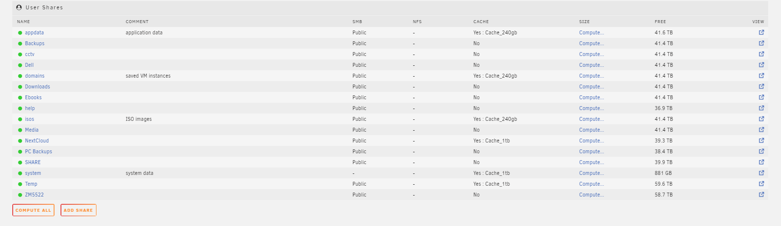

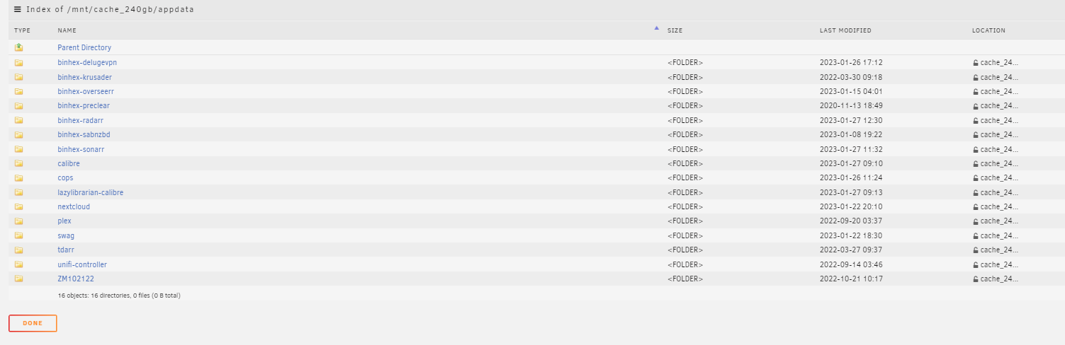

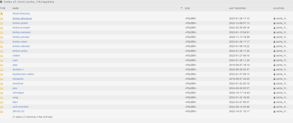

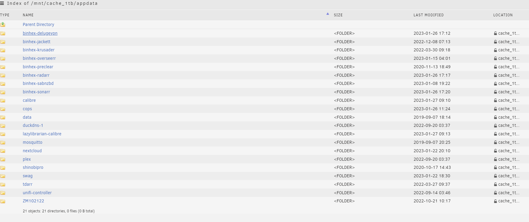

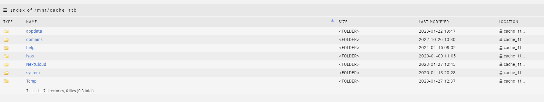

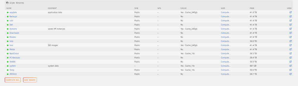

kysdaddy Posted January 27, 2023 Author Share Posted January 27, 2023 So If I read this right, my error was changing the assigned cache pool before I change the cache setting to yes. I told mover to look in a share that did not have files for the files. Unfortunately I do not know the steps to correct this. Currently mover is running. I have appdata folders on both pools, they have different information in them (not sure how I did that) Pool# 2 appdata folder reflects dockers that I am currently running (set to auto start) Pool# 2 only has appdata on it (as of now, mover is running) pool # 1 is all of the dockers that are installed including ones that are not currently in use. Pool# 1 has all shares including appdata Not sure if it is possible to screw this up more than I have already. Pool # 1 Pool #2 Shares Quote Link to comment
trurl Posted January 27, 2023 Share Posted January 27, 2023 After mover has finished, go to that last screenshot (User Shares) and click Compute All button at bottom, wait for the results, then post a screenshot and new diagnostics. Another thing you need to look out for is if any of your dockers specify a path on a specific pool instead of a user share path. /mnt/cache_1tb/appdata instead of /mnt/user/appdata, for example. Quote Link to comment
