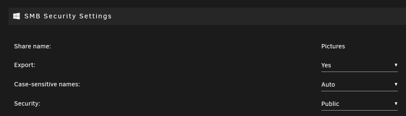

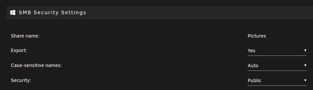

Hoopster Posted February 1, 2023 Share Posted February 1, 2023 26 minutes ago, davidshinobi said: I have some family video footage on the server I need get to I will let @trurl continue once you post diagnostics, but, for share contents to be accessible on a PC in the LAN, the shares need to be exported with the appropriate sucirty setting. Public is probably easiest until you get thing sorted out. You don't have to map network drives to access shares, but, it is one way of getting to exported shares. Quote Link to comment
