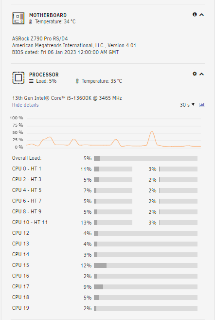

image.png.c60a45b5a34b286dde1c77653c5c8ba9.pngimage.png.d74fed54255cf77c6ba02bb3704fc020.pngimage.png.8fa9621c64d6f6243da3bf7d9bee56e6.png
you should be able to set power limits in the bios.  Worth looking into.
Thank you, I have set the power limit to 125W I don't think power limits will help as it is not getting anywhere near stressed (see pics on my previous post)
I cannot understand how it is consuming more power than my threadripper? as you can see it is sitting around 3%-5% load and even now with only 3 hard drives powered on it is drawing 215W?

The CPU temp is only 1C higher than the motherboard temp, that would confirm to me that this isn't the CPU drawing any signficant power.

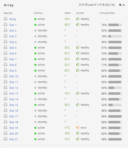

Can you detect anything getting hot in the case, 200W doesn't disappear, are 'spun down' HDD actually cold.
Do you have additional drives / devices connected, but not in the array.
Do you have a UPS inline?
Can you remove the HBA / Expander, remove the power to the HDD's then start the system (not the array).
Give it a few minutes to idle.
That should give you a baseline for the platform, I'd expect this to be 50W or lower, even my XEON E5 V3 (10C)  idles at 35W for just the board, memory, cooler with an 850W PSU.

I have checked the HBA and extender at 14W, you are correct about the cpu temp and this is because the CPU is just barely ticking over as it is running incredibly light tasks.

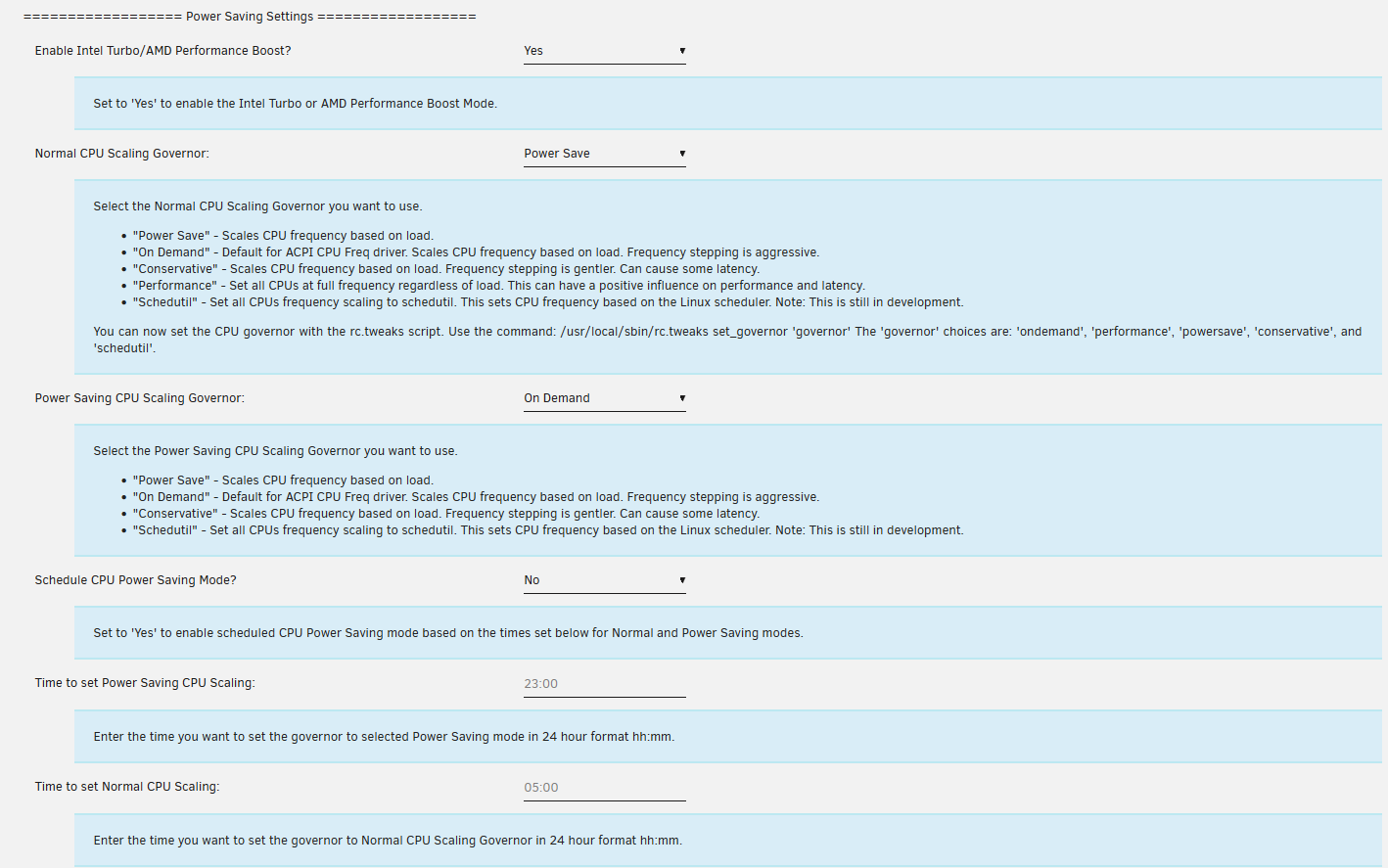

You might try installing the Tips and Tweaks plugin.  It does have some settings for Power Saving Settings.
@Frank1940 You are on a roll!!!
Thank you so much mate, enabled power saving in tips and tweaks and now down to 110W!!! Thank you buddy!

The UPS question was in case you had a UPS inline and it was pulling excess current to charge a failing battery.
How are the drives powered? are they all fed from the EVGA or do you have a powered drive shelf etc.
I think there are two main options
1) the Tasmota is giving a totally incorrect power reading. Can you read this from any other device, smartphone / web interface etc?
I'd swap this out or add a second power meter inline to validate. Even a $10 plug in meter will differentiate between 50W and 200W.
2) The HDD's are idle but not in power save. Typcially HDD are approx 5W in idle so that is easily 120W or 140W from the wall.
In power save they would be ~ 0.8W or ~ 20W total hence the question of what happens if you remove the HDD power.
That's more sensible for 24 drives!
All Powered by the single PSU in the rackmount
I did not know that! so if they are spun down they are still using approx 5W? or do you mean just spinning and not read/writing?
18 minutes ago, mbc0 said:
Idle is still spinning but not active
Powersave is spun down
