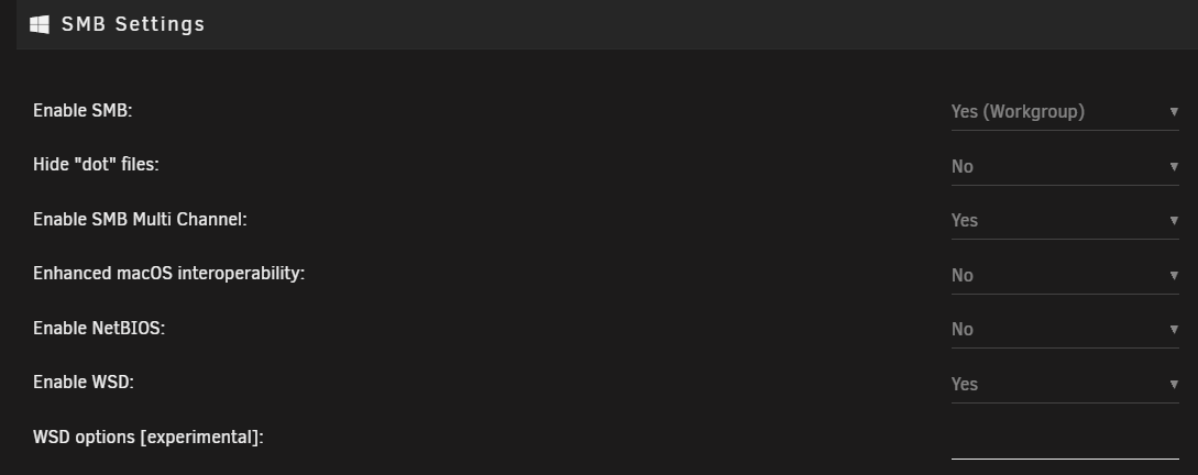

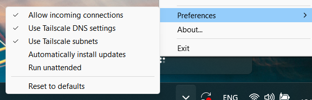

Try changing SMB settings:
I somehow got shares to work using tailscale DNS.
Also make sure to enable magicdns in tailscale admin console and allow local network access in tailscale client.
Honestly... This requires WAAAAAY more effort than it should... Considering local shares reliably work without all this hassle... And advertising your local network ip via tailscale also works.... While trying to use tailscale IP or DNS is a f-ing nightmare...
Also SHEER AMOUNT of weirdness I encountered while TRYING to get this to work... For example: I got assked for a certificate from trying to connect to my SMB share... This is the 1st time I ever saw a network share asking for a certificate... And I was trying to connect to a PUBLIC non password protected share... The same share that any 1 can access from my local network... I had a few issues that unraid asks for user and password for a public share but a certificate? Damn... I clicked cancel on the certificate selection and then got promted for user and password... Well OK I typed my shares details... Invalid password... I checked my password, used it in another PC to check if it is the right for this share user... Everything works... Yet TAILSCALE manages to surprise me... I gave up. Went to restart tailscale for above taildrop tests switched SMB Multi channel to Yes. And it worked... Why? I have no idea... It might be related to using my phones internet via hotspot for a more accurate test then running tailscale on my local network which already has stable and working SMB access to my server... All in all... Proceed at your own risk... I still plan to advertise my local network for printers and a backup access but that is just due to Tailscale failing to be stable...

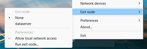

I ran
sudo tailscale up --advertise-exit-node
But nothing happens,
tailscale status
doesn't show my server as exit node. Any tips?
Also attempted this:
tailscale up --advertise-exit-node --accept-routes --advertise-routes=192.168.1.0/24
But i still can't select the exit node from Tailscale Admin GUI
