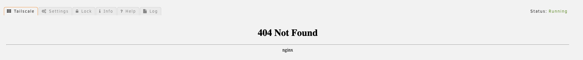

Tailscale Plugin seems to install but when going to settings, get a 404 server error (nginx) message. Totally weird, right?

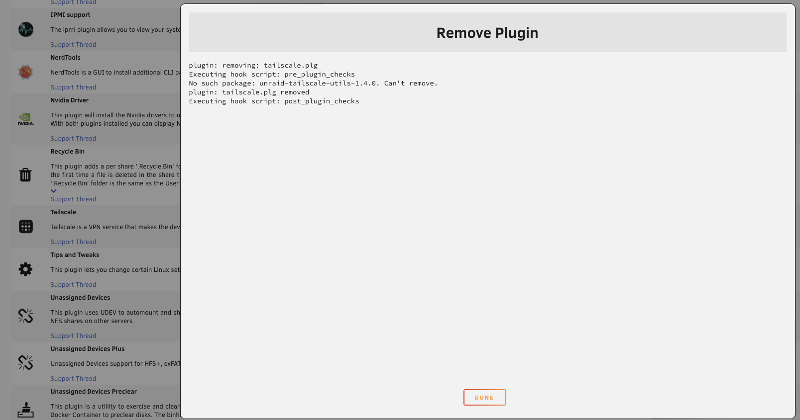

And then when attempting to uninstall it, the uninstaller says it's not even installed. Odd.
