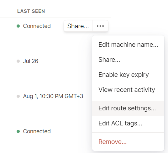

In tailscale console
tailscale set --advertise-routes=192.168.1.2
Then in plugin settings enable IP forwarding
And finally in tailscale admin console (tailscale web page) accept the advertised subnet.
tailscale set --advertise-routes=192.168.1.0/24
Should I use the above, the command in your message didn't work... invalid IP address or CIDR prefix...
