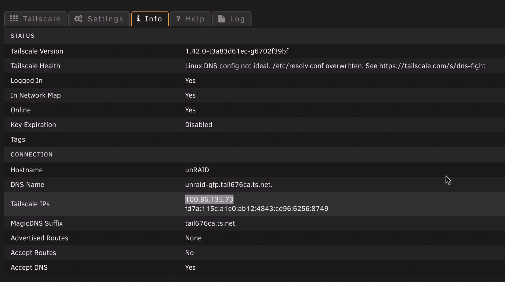

I am having issues after updating to 6.12.0.
I have three unRAID servers which I maintain via TailScale plugin.
I updated to the latest version of the TailScale plugin before updating to 6.12.0
Now I am unable to connect to the unRAID system I updated (not an issue as I can remote onto my father's iMac with screen sharing although not ideal).
I was able to check the Tails:cale status and look at the settings as shown below:
790994456_CleanShot2023-06-18at12_15_51.thumb.png.2bfb4c294d2c8cc0d0549867cb1ebf16.png

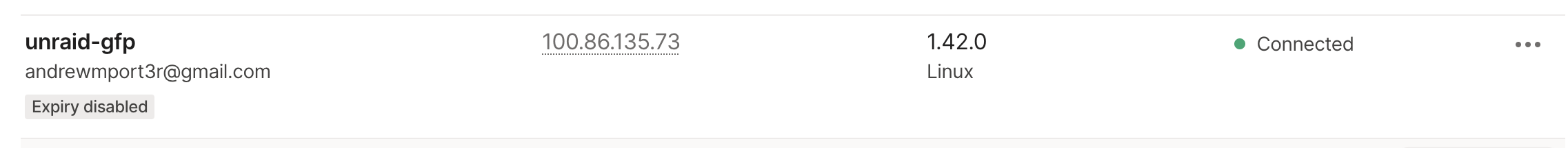

I am able able to see that the unRAID is connected to tailscale in my admin console:

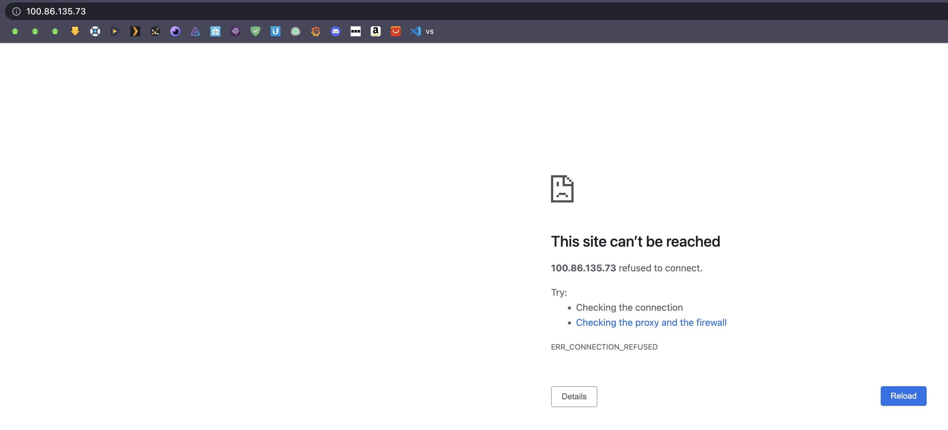

Yet I am unable to enter the IP into Chrome to connect, receiving this message:
91726289_CleanShot2023-06-18at12_31_04.thumb.png.d5eedd93012e0e660204d040da4e8d1d.png
Same issue here, would like to know how to troubleshoot this...

I'm also having the same problem as @Rocka374. I'm on Unraid 6.12.0. After setting up this plugin, I'm unable to access the Unraid web UI or SSH via the Tailscale IP. Access through the local IP still works. I have "Unraid services listen on Tailscale IP" set to "Yes". I tried changing it to "No" and back to "Yes" but it didn't help. My diagnostics are attached. Any assistance would be appreciated.

Usually this has something to do with “Accept routes” being turned on. I’ll look at your diagnostics when I get some time later tonight.
Thanks! By the way, I just tried turning off "accept routes", both in the plugin settings page in the web UI as well as by running "tailscale up --accept-routes=false", but unfortunately it didn't help.

OK, I think I see what's happening here. I should have a fix for that out probably tomorrow evening, unless I end up being super productive tonight (always a possibility, but hard to predict :) ).
In the meantime, you can probably just add "tailscale1" to the extra interfaces section in the network settings, and it should start working.
Edit: Nope, turns out a simple mistake on my part, fix should be up within 30 minutes.
