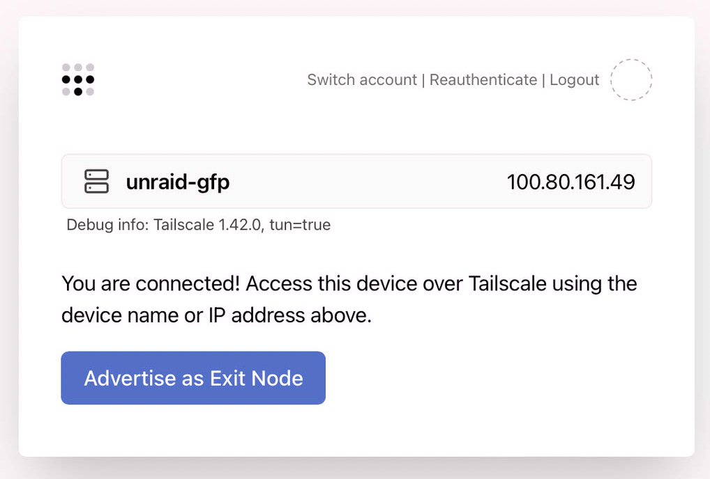

Hi there
I have just installed the latest version but I am still unable to access a remote unRAID box via tailscale.
It is my father's unRAID and I can use use screen share on mac via request to tinker.
Process followed was:
Remove the machine from Tailscale console.
Remove plugin.
Re-install plugin.
Tailscale up.
Tailscale login.
Try to access via tailscale IP to access GUI via Chrome still does not work.
I am able to ping the tailscale IP from my unRAID system.

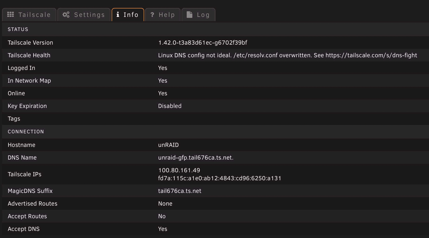

The remote unraid (gfp) shows as connected in unRAID:
81303618_CleanShot2023-06-19at13_28_12.thumb.png.725ca0c66c4ded1ebc875d640d19d65f.png

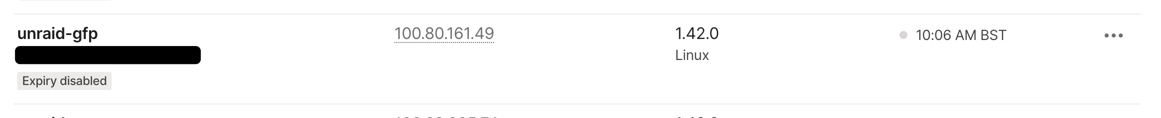

The unraid (gfp) shows connected in the tailscale admin console:
556681317_CleanShot2023-06-19at13_32_052.thumb.png.e32d6daa8e86de50a39866c1bcc1a937.png

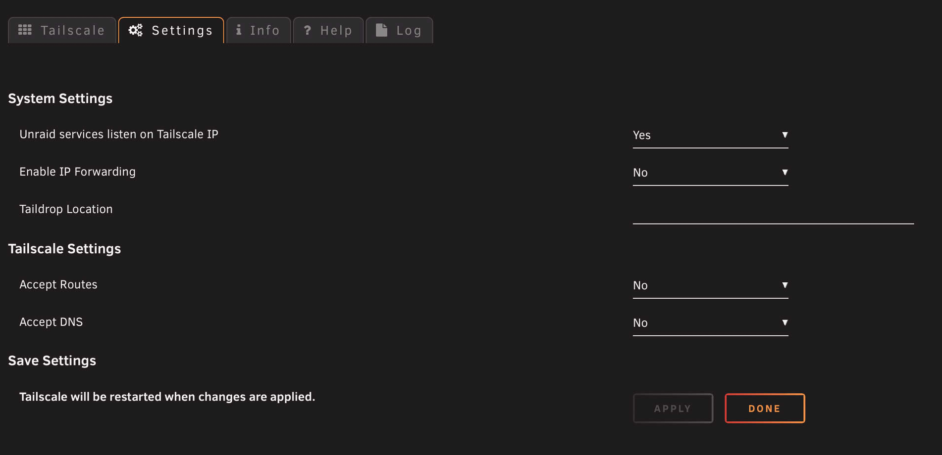

The settings of the plugin are:
1161209912_CleanShot2023-06-19at13_28_23.thumb.png.3d5bab43e90016748f7fb07897b6f4f8.png
and:
1090178289_CleanShot2023-06-19at13_28_30.thumb.png.ef6cd0200b2d23d3b08920a1f5296054.png
the latest diagnostics are attached.
The tailscale plugin was fine up until 6.11.5 and only seems to have broken when upgrading to 6.12.0.
Under Settings > Network Settings the listening interface does list tailscale1.
This is tailscale plugin version 2023.06.18.
I have another unRAID box that is remote that I am only able to access via the tailscale plugin and would like to update but I am concerned if I do I will lose access (it would be a 500mile round trip to fix).
Any help or advice would be most appreciated.
unraid-diagnostics-20230619-1328.zip
Edited by amp88759
Obfuscate email address

Yay! An easy fix :)
You just need to restart the Unraid services (easy method: go to tailscale settings, change any setting so that the "Apply" button will turn on, change the setting back, click "Apply").
I don't have a good way to catch when "tailscale up" happens, so I can't restart the Unraid services automatically on the first login to Tailscale. The plugin restarts the Unraid services 60 seconds after starting, but if Tailscale isn't logged in yet there's nothing for Unraid to listen on.
Edited by EDACerton
5 hours ago, EDACerton said:
Yay! An easy fix :)
Hi there
Thanks, this fixed the issue.
The only problem I found is that I then had to re-authenticate. So presumably would have been kicked off the tailscale network. No good for the machine 250miles away.

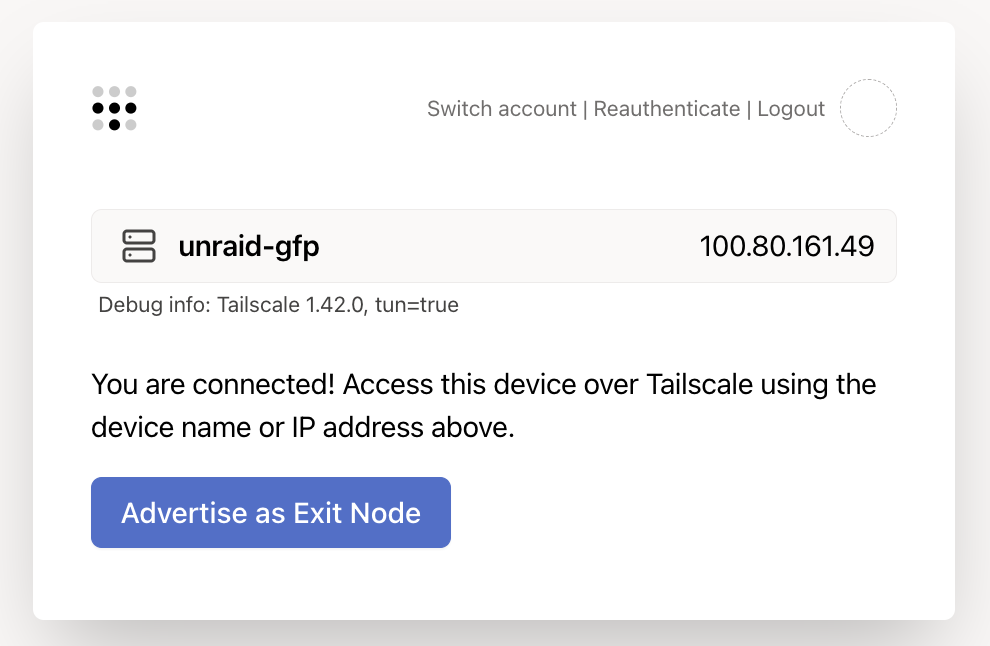

Additionally, although I am connected to the unraid-gfp server as can be seen here:
The connected status is not shown in the tailscale admin panel:
795978494_CleanShot2023-06-20at10_08_45.thumb.png.dff7892304273f7d9e73705d87273f7f.png
Thanks for helping me fix this issue of non-connection. Much appreciated.

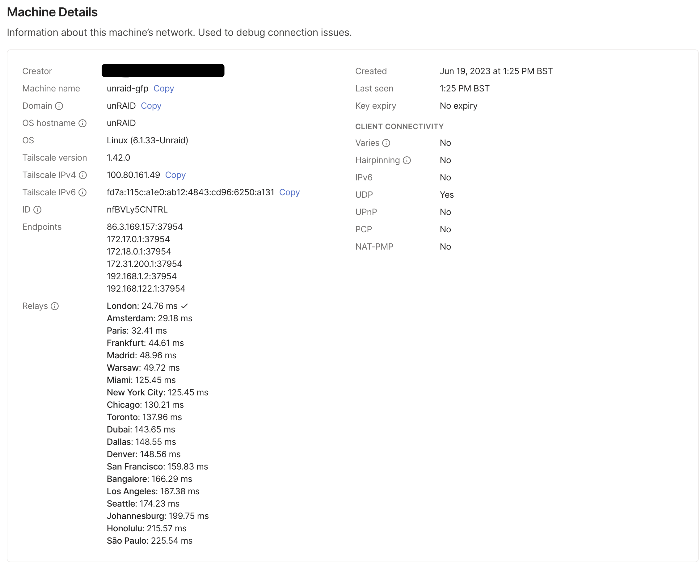

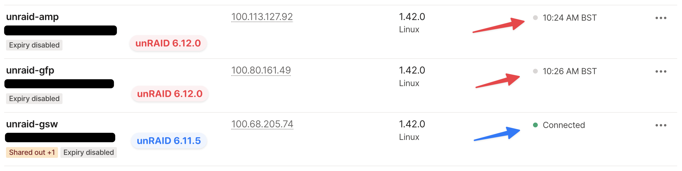

Incidentally, my unraid server has been upgraded to 6.12.0 and has the tailscale plugin running, I very rarely connect remotely to my own system, although I have tried and it worked straight away without any of these problems.
I noticed this morning that whilst my server is connected to tailscale the admin panel also shows not connected:
1805000909_CleanShot2023-06-20at10_24_32.thumb.png.af50b5040b5c48197bd510860767f431.png
Is something still not quite right with unRAID 6.12.0 and tailscale?
Thanks for the fantastic work you are doing this plugin really does make my life easier!
This is my tailscale admin console with three unRAID servers and their versions: which are all connected to tailscale despite what the console says.
338297249_CleanShot2023-06-20at10_28_48.thumb.png.5ce01b932e6906aa878733d8228ad5f1.png
All are on the latest version of the plugin 2023.06.20
Edited by amp88759
That's been a weird bug with the Tailscale console that I've seen before, it doesn't seem to hurt anything though. I'm not certain what causes it, will have to dig in at some point, but that hasn't been a priority since it seems to be harmless.
