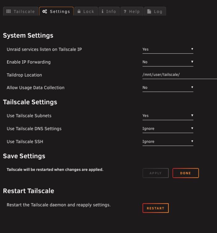

I would start by turning "Use Tailscale subnets" and "Use Tailscale DNS settings" off in your config.
Most installs don't need them, and in some networks turning them on can result in the behavior that you've described.

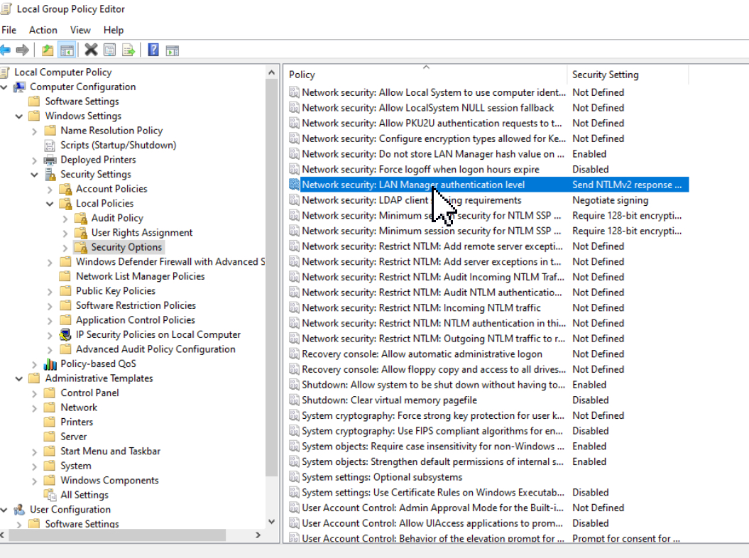

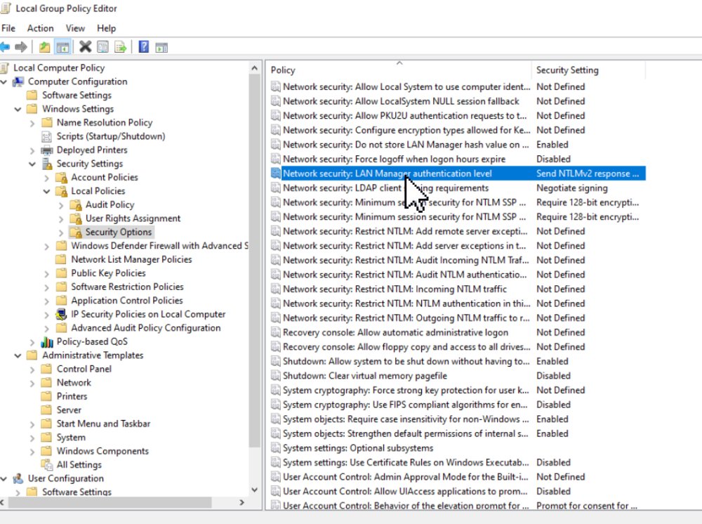

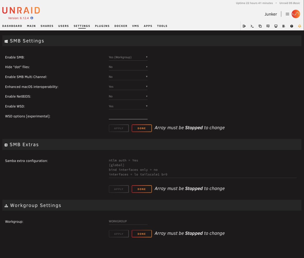

Just came here to say - I’ve been trying to get silly shares available over Tailscale for a few days. My understanding was it “just worked”. Never the less my experience has been frustrating and admittedly somehow likely to be self inflicted.
Just wanted to say thanks - some combination of changing “NTLM” group policy in Windows along with advice in this thread about turning netbios OFF and some specific SMB extra configuration(seen below) info I am happy to report success.
No idea truly which change was most relative to resolution - but thank you folks - all of you; my remaining sanity can now remain intact.

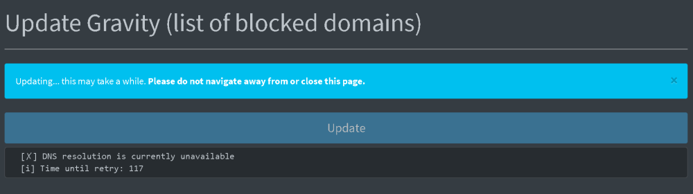

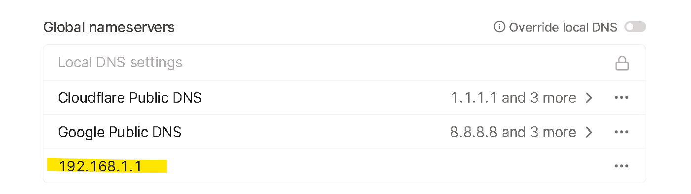

[Tailscale plugin and Pihole container]
So I have only basic knowledge of networking, containers and Unraid, and I need some help achieving the following:
  • Use my local Pihole as a DNS server for my iPhone wherever I am.
I have the Tailscale Unraid plugin installed and it is working, i.e. I can access the Unraid WebUI via Tailscale. I also have the Pihole container running and I am using it as my DNS server for my local network.
The challenge I seem to have is that my Pihole container is running on a "Custom: br0" interface which exposes an IP address of 192.168.178.250 to my LAN, whereas the main IP of my Unraid box is 192.168.178.222 and so the Pihole container is not part of my Tailscale network.
One idea I had was to adapt the Pihole container so that it would also include Tailscale and so that my Pihole machine would expose itself as a separate node, but doing that is above my knowledge, and on paper seems like a lot of work - there must be other, simpler ways? Somehow forwarding port 53 request on the Unraid host to the Pihole's container port 53?
Many thanks for your insights!

im doing the same thing with my iphone and and pushing all my iphone traffic to my unraid box with exit node enabled.. I just added my pihole dns address in to talscale. it seems to work
however im havving an issue when using gravity update
im getting this error "[✗] DNS resolution is currently unavailable" its worked before not sure what changed or had enabled to cause this error.
