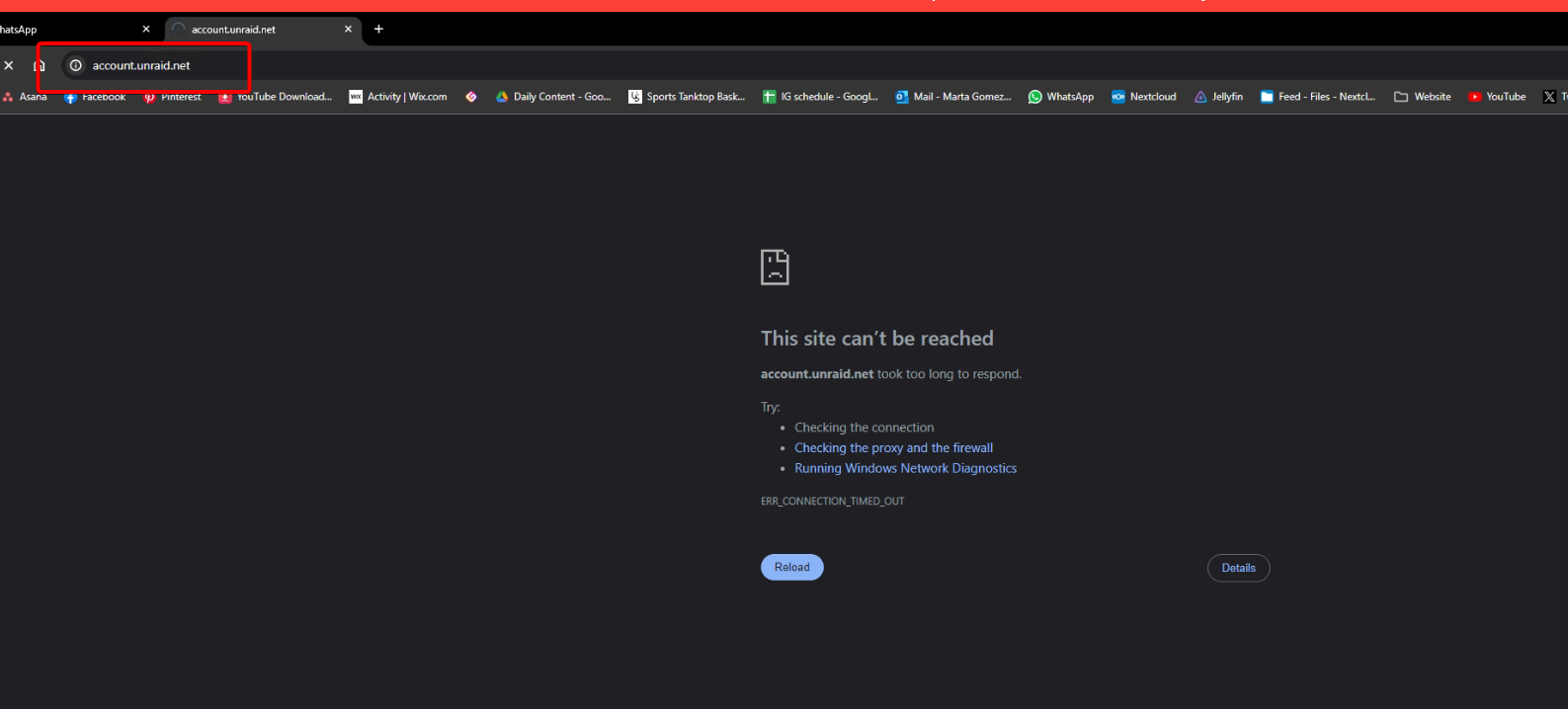

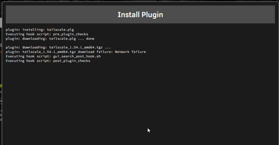

my tailscale stopped working.
so i uninstalled and tried to reinstall. now i have network failure
anyone know whats going on?

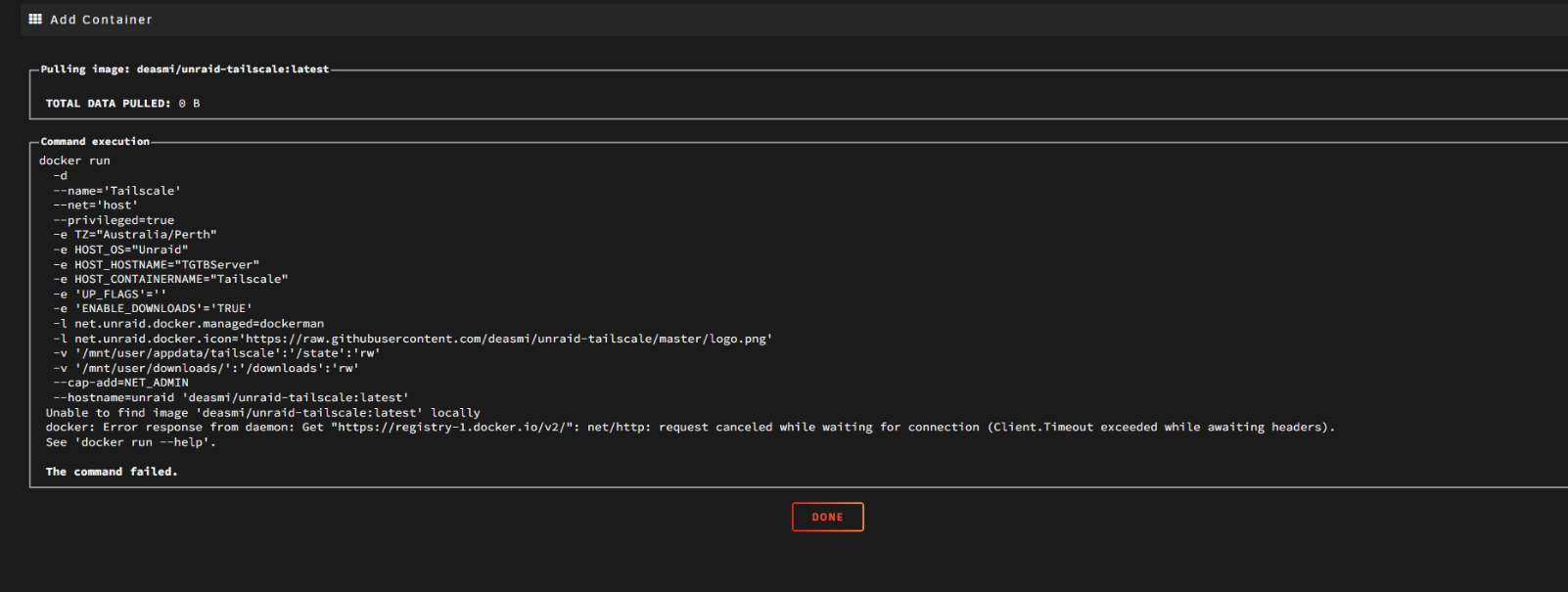

I also tried the docker just to see if it could be downloaded: also failed
Is this a server problem with tailscale plugin / docker?
'image.thumb.png.86591d07ab2843380752dc608d6cdbca.pngimage.thumb.png.9181fcab9a8cc65a8f691d7c15f500ac.png
Edited by K1LLA_KING_KING
Without diagnostics all I can do is guess… I’d guess that your Unraid instance might be having trouble getting to some parts of the internet, which would explain both Tailscale not working and why it can’t download the package from Tailscale to install.

please see diagnostics here
EDIT:
ah something wrong here
I cannot connect to unraid.net
tgtbserver-diagnostics-20231227-1159.zip.crdownload

That's not a complete diagnostics file... it looks like you uploaded the partial download before it finished.
In any case, based on your other screenshot I think it's fair to say that you're having larger internet issues... once those are fixed I would expect for Tailscale to start working like before.
