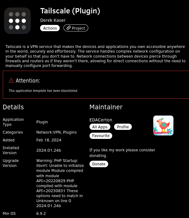

Just updated a few applications and plugins, but now seeing this plugin marked with "this plugin template has been blacklisted". See attached screenshot. What does this mean?
@Squid  ??
Edit: it looks like Squid is working on something weird with Community Applications, I'd assume that this is related to that, it will hopefully be fixed soon.
