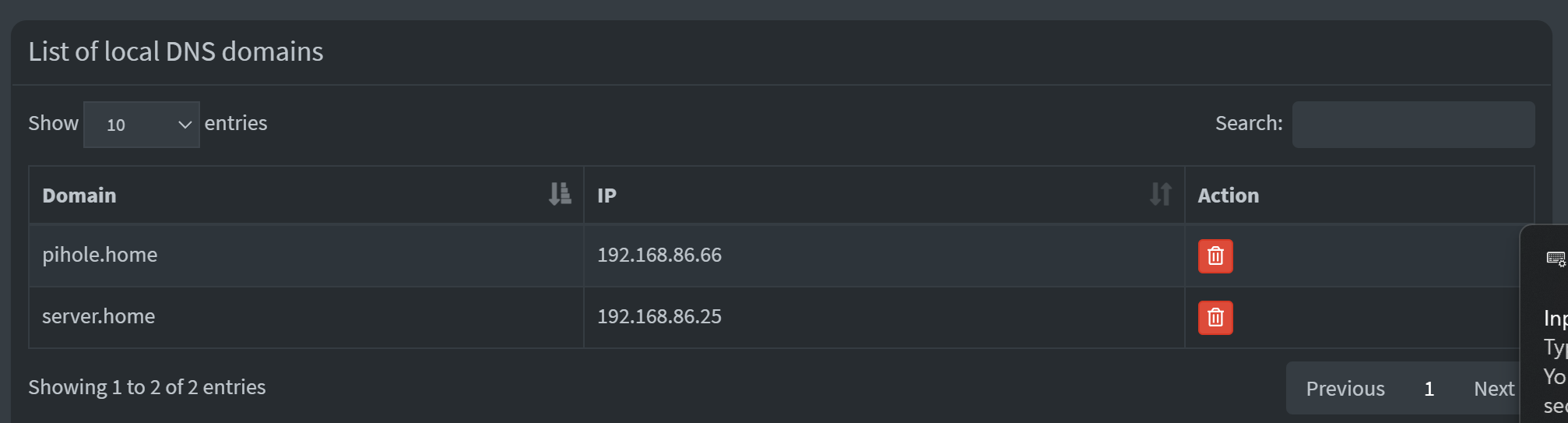

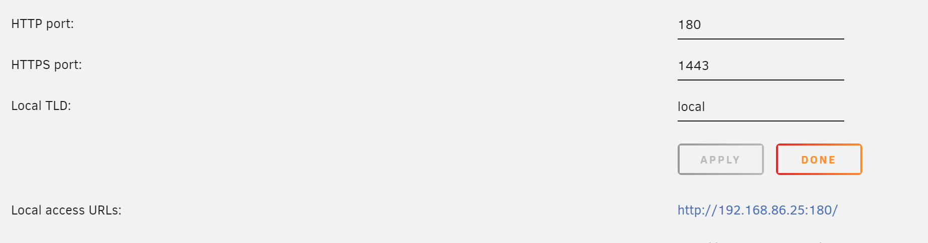

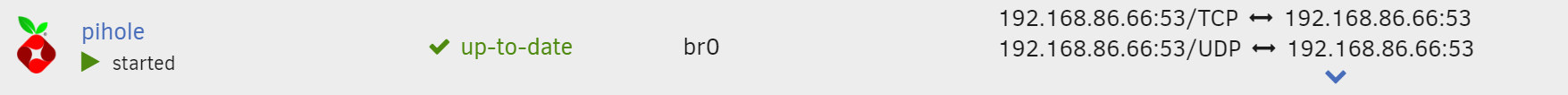

I installed the plugin today and things are working... for the most part.
I have pihole and ngnix proxy manager set up for local dns, and my unraid dashboard runs on port 180. Ngnix dashboard runs on unraids default dashboard port 80. Pihole ip is set up as primary dns server on my router.
If i connect via tailscale through my phone i can access all my services either via ip:port or my dns entries e.g sonarr.home, except for the unraid dashboard. It works using unraid.home but not by ip:180 directly. tailscale-ip:180 does not work either.
Trying to resolve the issue as it would be nice to be able to access unraid remotely in the case where docker service is not running.
Does anyone have an idea whats wrong with my setup here? Likely its some misconfiguration on my part with nginx 🙃

From the Tailscale side, everything looks fine.
If you've been accessing the WebGUI from your phone, you might be accidentally crashing the WebGUI. There's been a known issue with the WebGUI and mobile devices (in particular Android devices)... essentially, if a tab with the WebGUI gets left open (even in the background), it eventually causes problems for the server.
