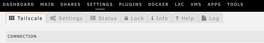

Did you mean that you don't see any Tailscale UI at all, that you don't see a Tailscale icon in Settings or just that the first Tailscale tab (where you log in) looks different from the old one?
With default theme the Tailscale icon in Settings looks like this in the second row, Network Services
Clicking it brings up a tabbed Tailscale UI with the first tab selected.
The old WebUI showed a white rectangle in the middle of the display on the first tab that didn't match the rest of the Unraid UI. The current UI now matches the rest of the Unraid UI.
The current UI looks like this along the top:
If you haven't enabled Tailscale (on the second tab - it would make more sense on the first) and haven't logged in (first tab), then the tab will be empty except for a message telling you to enable and possibly log in.
There's one aspect of this UI that is incorrect - it's always a tabbed interface, even when Unraid's page view (in Display Settings) isn't set to Tabbed. I just found this today as I normally only use a tabbed UI so would have never otherwise noticed.

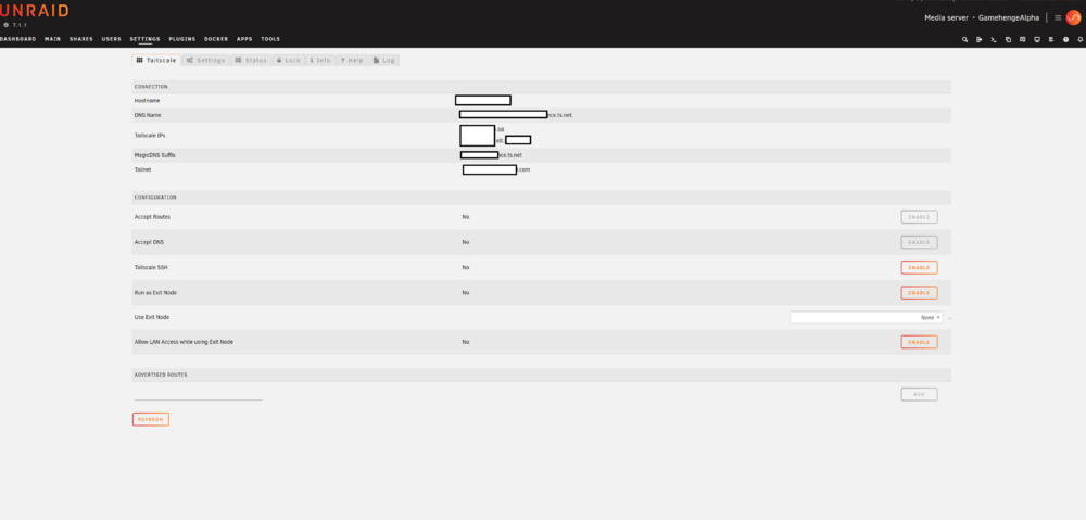

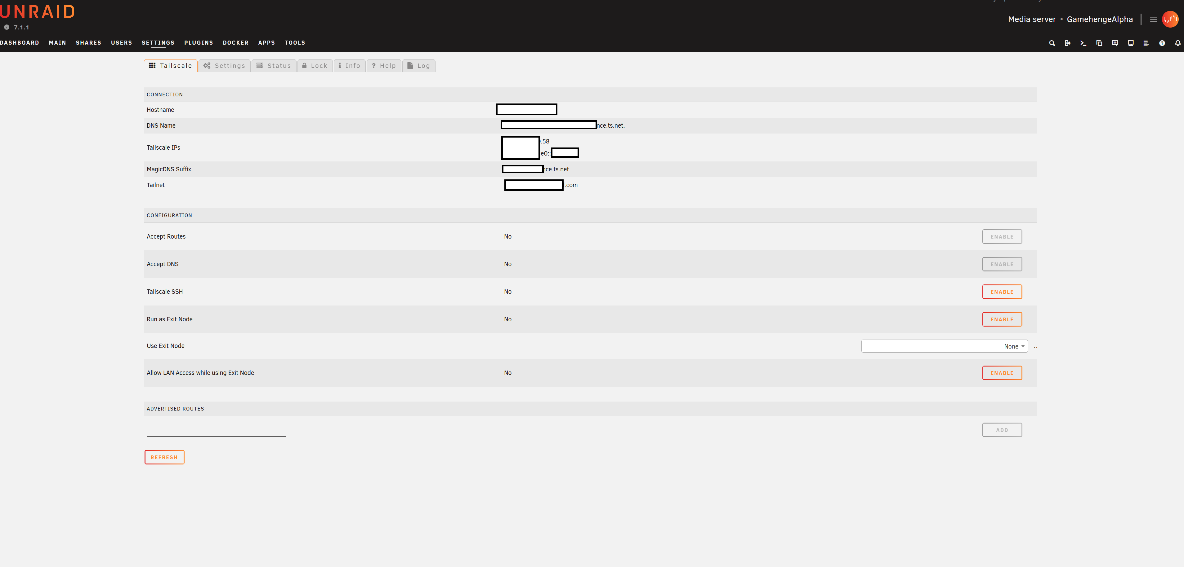

I've run into a problem on Unraid Version 7.1.0
Tailscale installs fine and I can also connect to the tailnet, however I cannot activate the unraid server as an exit node. If I click on "enable" nothing happens. I have played around with all other settings, nothing makes a difference. I have also tried both the standard Tailscale plugin and the preview version with the same results.
I Have the same issue
Visit the server via TailscaleIP:5252 and enable the exit node there. That should work. Otherwise cli should work too
I was unable to connect on port 5252, however there has been an update on the preview branch and everything now works as expected. Thanks!

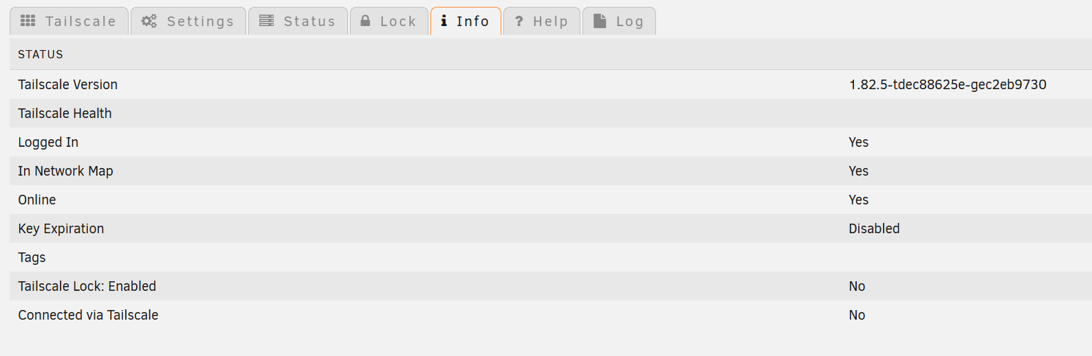

I am having the same issue.  I have followed all the steps.
On the unraid dashboard, it is showing "online : Yes"
On the tailscale website it is showing my unraid server as "Connected"
but on the tailscale settings page is it still no showing the connection page that everyone else is seeing.
and in my plex docker, it is showing "use tailscale: Option disabled as network type is not bridge or custom"
I have changed settings to enable EXIT MODE.
I have reauthenticated.
I have erased tailscale configuration and relogged in when prompted, but still it is returning to the tailscale screen that is not showing me logged in.
I am on google fiber if that has anything to do with this issue, but I am suspecting that the issue is entirely a setting on the server itself.
I truly have tried reading through all the pages of this support thread before posting.  I simply do not know what I am missing.  If anyone has any advise for me, it would be truly appreciated.tailscale.thumb.png.be81e9f6b199f3e0c943d56224433945.pngtailscale2.thumb.png.98693d02dbd8cba102e907da8a89cd2e.png

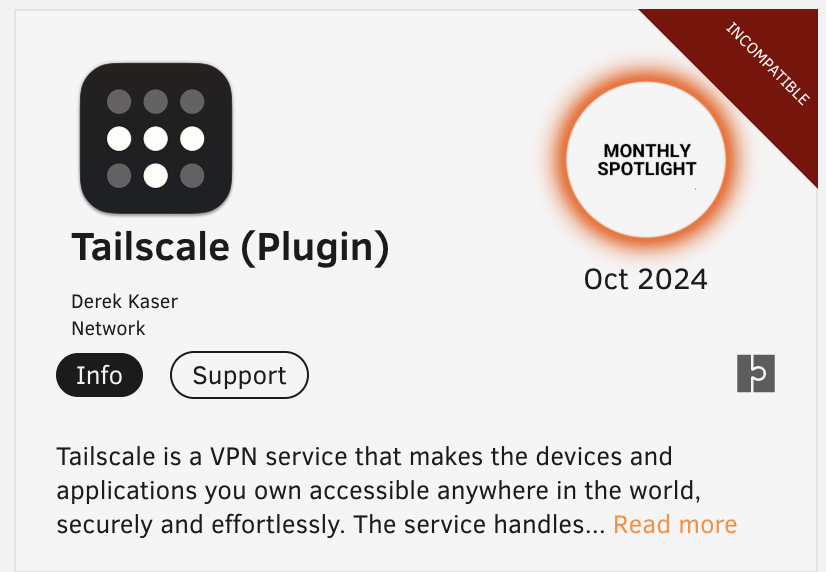

Is the Tailscale plugin only compatible with Unraid 7.x? I'm trying to install it to my Unraid 6.12.15 but it says the plugin is incompatible. First I couldn't find it in Community Apps but when I changed the setting to not hide incompatible applications, I was able to find the plugin but it says "incompatible". Or is there a way for me to install the plugin so that I can access my server remotely?
The current version of the plugin is maintained for 7.0-7.1 (I maintain for the current and previous minor release). I can get a link in a little bit for the  last 6.12 version.
