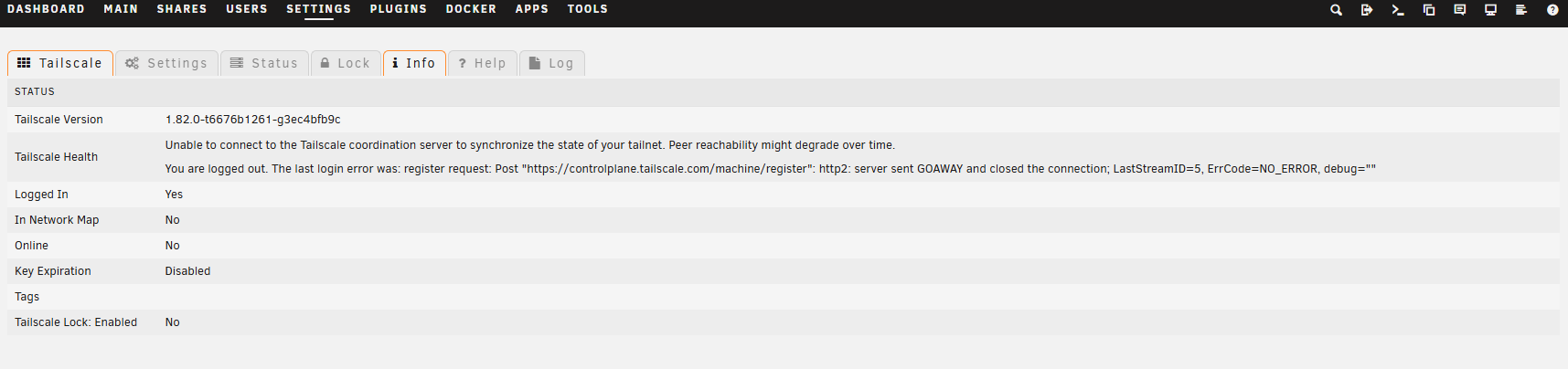

First time posting here. Updated to Beta 4 of 7.1 and the Tailscale plugin required that I authenticate again to access my Tailnet. After authentication I got a notice that my 'machine had been added' but that an admin needed to approve it. I found this strange since this Unraid server is my main server and has been running the TS plugin just fine. It's also an exit node with subnet routing. When I went to my TS Admin console I saw that my 'new' machine had been added (subject to approval) and had the same name as my 'old' server with a -1 added to the name. So clearly the plugin and TS think my main Unraid server is an entirely different machine. I haven't change out any hardware etc. Just updated to Beta 4. Ran fine on Beta 3. I've logged out, rebooted, uninstalled the plugin, reinstalled the plugin, etc. Nothing works to get the TS plugin to facilitate seeing my current server as the original machine that is still listed in my TS admin machine list. Any suggestions?
Just to clarify here... this is all happening via Settings -> Tailscale? Please provide plugin diagnostics: https://edac.dev/unraid/plugin-diagnostics/usage/
Yes. After updating to Beta 4 I rebooted and saw that TS was logged out on the server. Went to the plugin to reconnect and when through the auth process via Google. Hit the TS auth saying my machine would be added and you know the rest. Here are the diagnostics. Know that I recently reinstalled the plugin and decided to go with Preview when I couldn't get the regular plugin to register as my 'old' machine. Preview plugin is no better..
MediaStation-tailscale-diag-20250411-154743.zip
On 1/28/2025 at 2:30 AM, EDACerton said:
Yes, I would just do an "Erase Configuration" (might need to toggle advanced settings), then wait 30 seconds and reload the page.
It seems like somehow Tailscale didn't connect correctly after the restart.
When you redid the login, it replaced the key for the server, so there's no way to make the server register as the "old" machine now. What you can do is delete the old machine from the Tailscale admin console, then use the "Edit machine name" and "Edit machine IPv4" options to make it look like the old one.

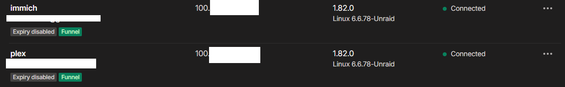

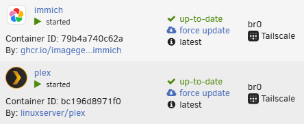

Currently, with the tailscale plugin installed host not configured, I funnel my plex and immich...
So I can go to plex.mytailscale.net and reach my plex and immich
as I have found that the plugin needs to be installed and exist
but alot of actual maintained and contorted via the tailscale admin console...
