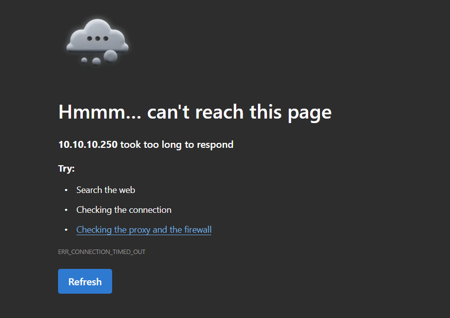

I'm having trouble enabling the Tailscale SSH server on my unraid server.
I go to myUnraidUrl/Settings/Tailscale, click Viewing and then Sign in. Then after signing in on the new tab, I click Tailscale SSH server. Then I click "Run Tailscale SSH server", to toggle it on, but it immediately toggles off and I get an error message in the bottom right which reads "Failed to update node preference".
I'm running unraid 7.0.0 and Tailscale 1.80.0-t4f4686503-gccb3ce01b
Does anyone know what's causing this?
