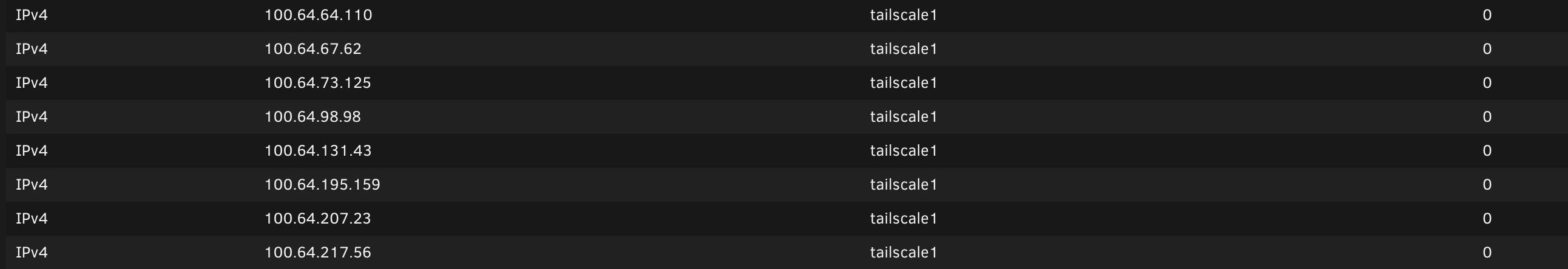

So I just updated to Unraid 7 from 6.12.11 and it seems to have broken my subnet routing with tailscale. With the array stopped, it works fine, but after the array is started and services come up, about 5 minutes after, the subnets no longer route. In the tailscale logs I have:
"2025/01/18 04:53:54 Rebind; defIf="shim-br0", ips=[10.2.0.3/24]
2025/01/18 04:53:54 onPortUpdate(port=44559, network=udp4)
2025/01/18 04:53:54 onPortUpdate(port=50180, network=udp6)
2025/01/18 04:53:54 wgengine: set DNS config again after major link change"
which seems to indicate docker is the issue, and sure enough, setting "Enable Docker" to "No" resolves the issue. What is going on here? I read about possible issues with CIDR but mine is 10.2.0.0/24. I have combed through every setting I can imagine and even rebooted multiple times and can't seem to resolve it. Any help?
It seems I can still ping the devices across the tailscale subnet route, but can't access any services there like I was in 6.12 or when docker is disabled

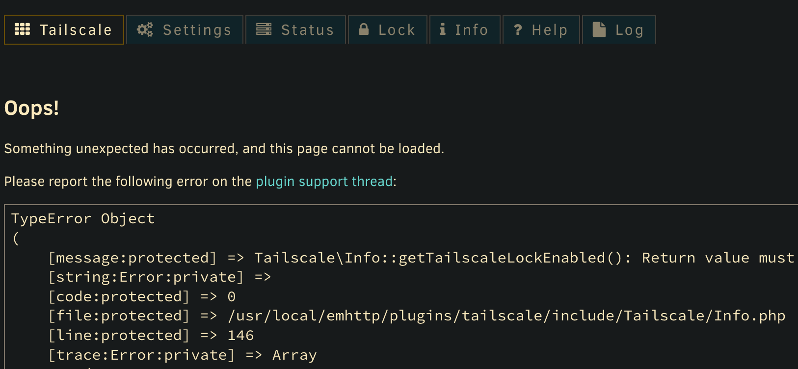

I am trying to set up Tailscale for the first time. I have recently updated unRaid to 7.0.0.
I have installed the limetech plugin, and when I try to view the settings and get things going, I get this error on the settings page:
TypeError Object
    [message:protected] => Tailscale\Info::getTailscaleLockEnabled(): Return value must be of type bool, null returned

I'm not sure what the error is exactly here, but it seems like a bad file?
Any help would be greatly appreciated!
Try going to the “Settings” tab and use the restart button there. Those errors can occur if Tailscale doesn’t start properly.
If that doesn’t work, you can check the logs page, or follow the instructions in the pinned post to create plugin diagnostics.

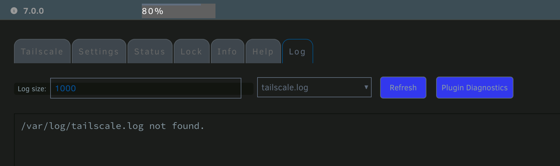

Unfortunately, the logs page didn't provide any logs.
Thanks for the direction pulling the diagnostics, I've included them here.
EDIT: deleting some old, unused plugins and then rebooting my server loaded tailscale for me.

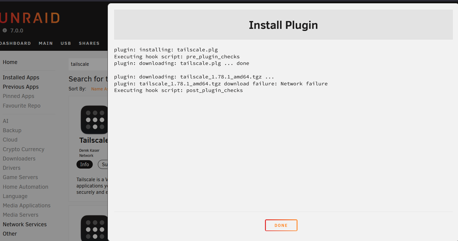

Hello guys,
do you know why the install of the plugin is not working? Other plugins can be installed actually...
