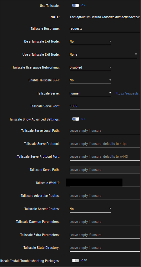

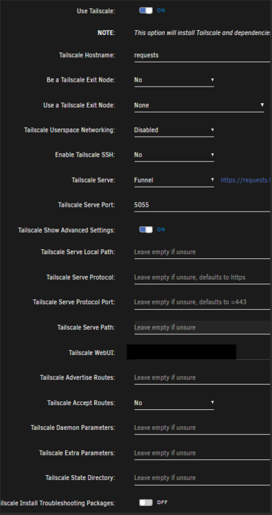

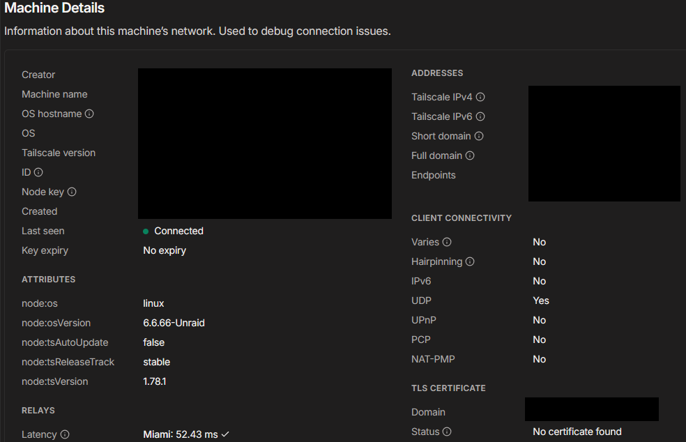

I need some help with the serve/funnel features on the docker integrations. I hope this is just a case of user error but the documentation isn't all that well fleshed out.
1. Tailscale does not seem to generate an SSL cert for HTTPS (which i've enabled in the admin console)
2. I've enabled funnel but it appears to be stuck at enabling funnel as nothing happens after that last line.
The status.
The Docker shows up as a device on my tailnet after I authenticated it. I just cannot connect to it when I type in the domain.

1 hour ago, MowMdown said:
SOLVED: Funnel was not enabled on my tailnet from the admin console, apparently this has to be toggle ON for this feature to work.
The status.
This is not an issue with the Tailscale plugin, please make a post in the pre releases forum if you have further issues:
