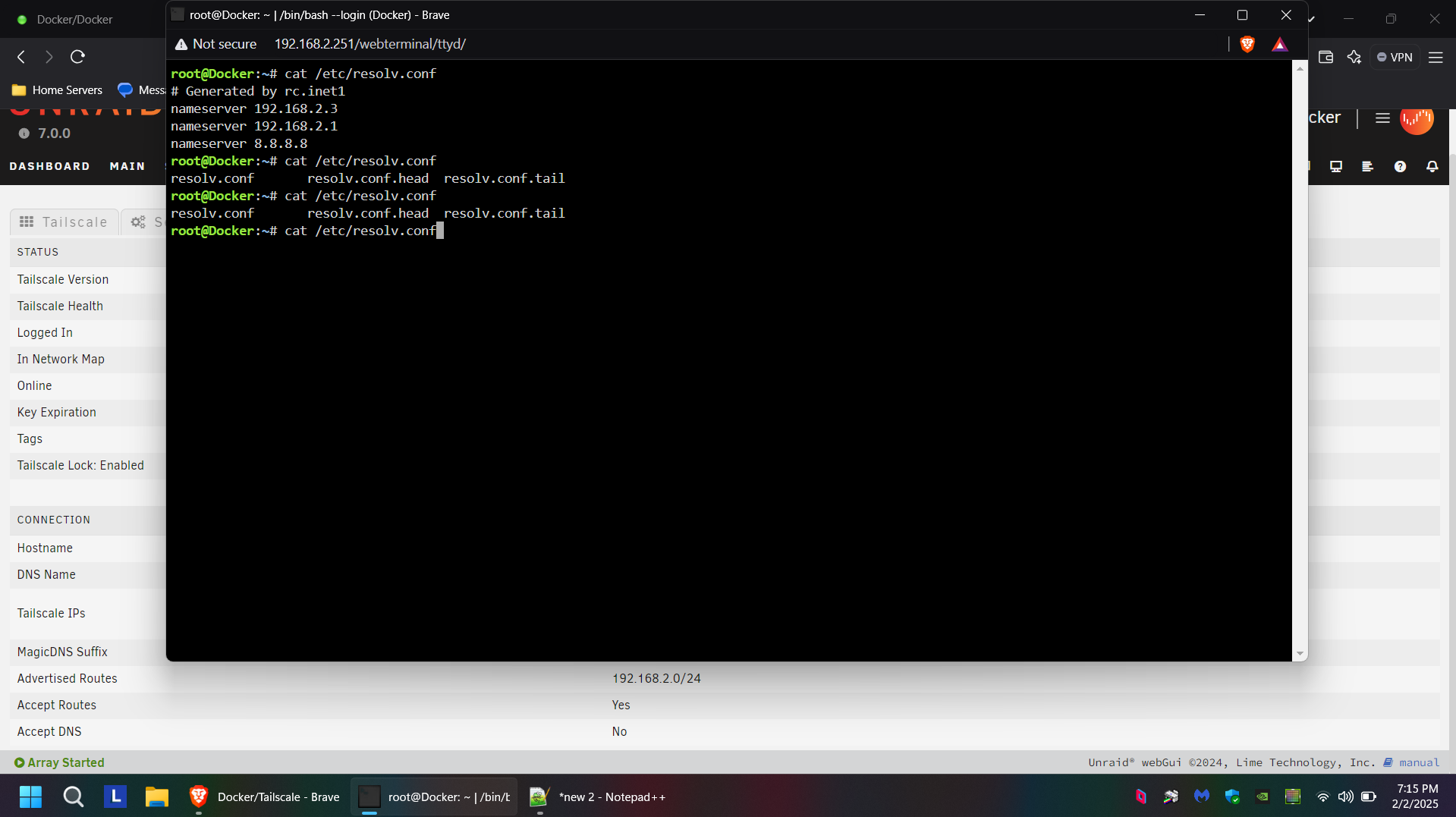

so after the lattest update. Before I run my script to setup tailscal as a node:
Step 1 nothing runnign yet system is up...
root@Docker:~# cat /etc/resolv.conf
resolv.conf       resolv.conf.head  resolv.conf.tail
# Generated by rc.inet1
nameserver 192.168.2.3
nameserver 192.168.2.1
nameserver 8.8.8.8
root@Docker:~#
this is what the host resolv.conf is...
step 2 run my ensre route scirpt wil will start tailscale and allog the tailscal vpn to conect to my lan though my unriad system via the route...
I would normaly wait 1 min for full system boot and run this to start tailscale!
sleep 60
tailscale up --accept-routes --accept-dns=true --advertise-routes=192.168.2.0/24
As I want docker fully started and working first then tailscale then edit the docker network settings to flush and change the ip which enacts a rcnet restart.... (during this restart step is when tailscale breaks the resolve config...)
ran command wants the settings and resolv.conf say:
root@Docker:~# tailscale up --accept-routes --accept-dns=true --advertise-routes=192.168.2.0/24
Warning: UDP GRO forwarding is suboptimally configured on shim-br0, UDP forwarding throughput capability will increase with a configuration change.
See https://tailscale.com/s/ethtool-config-udp-gro
root@Docker:~#
so now tailscale vpn is working (as I want it!)...so what does resolv.conf say...
So nope still a broken resolv.conf...
resolv.conf                       resolv.conf.head                  resolv.conf.tail                  resolv.pre-tailscale-backup.conf
# resolv.conf(5) file generated by tailscale
# For more info, see https://tailscale.com/s/resolvconf-overwrite
# DO NOT EDIT THIS FILE BY HAND -- CHANGES WILL BE OVERWRITTEN
nameserver ###Tailscale IP####
search MyTailscaleNetwork.ts.net
root@Docker:~# cat /etc/resolv.pre-tailscale-backup.conf
so now that this is reporduceable ... This is now on teh maintainer! they need to not break the host unraid v7 resolv.conf at the host level!!!
so the plugin maintainers will need to make a backup of there setting (or NOT REPLACE TO THE DAM /etc/resolv.conf) to have there data but to keep and maintain Unraids data to maintain and keep dns and other stuff working!!!!
So lets run a script to backup there curent Fup in and run similar to make there setting and then combine the 2! AS IT SHOULD BE!...
IF they just write the Tailscale stuff to /etc/resolv.conf.tail it be fine!

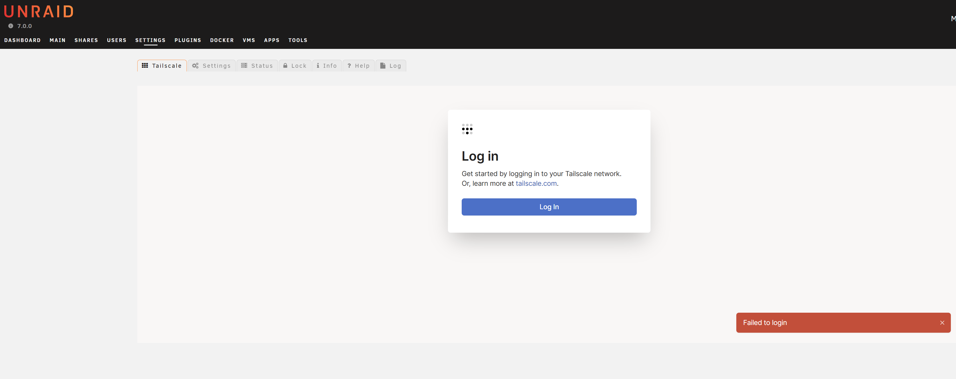

Hello All,
I try to setup Tailscale on my Unraid nas, but I encounter some problems unfortunately. I'm on Unraid 7.0.0 and use the Tailscale plugin. I follow the steps from the Spaceinvader One video on Youtube, but already I'm blocked at the start.
I installed the Tailscale plugin. After it was installed I went to Settings -> Tailscale. According to the Spaceinvader One tutorial I should see a button to reauthenticate. I don't see that. I see a button to login. When I click the login button, I directly get a notification that login fails.
I already tried to:
* Refresh the browser.
* Shutdown and start the nas.
* Uninstall the plugin and reinstall it.
* Check the log.
* Find people online with the same issue. Can't find anything..
What am I doing wrong? I hope somebody can help me.
Thank you very much!
tailscale-utils.log tailscale.log
Got the same error after the update
This appears to be caused by a security fix that was added in Tailscale 1.80.0. It breaks the "Login" button when accessing the WebGUI over HTTP. I'm opening a case with Tailscale for that.
In the meantime, if you enable SSL/TLS for the WebGUI via "Management Settings", you should be able to complete the login. You can also open the CLI and run "tailscale up", then go to the link it gives you.
I've also rolled back the "main" plugin version to 1.78.1 while I work on getting a better fix for this. I will keep 1.80.0 on the "preview" branch for anyone that wants it (1.80.0 allows Unraid to use exit nodes again, so some folks might want that).
Edited by EDACerton
Thanks for the quick response! Enabling SSL/TLS solves the problem! I am able to login to Tailscale now.
nameserver 8.8.8.8
 but now i lose my abilt to use dns and host name over the VPN...
