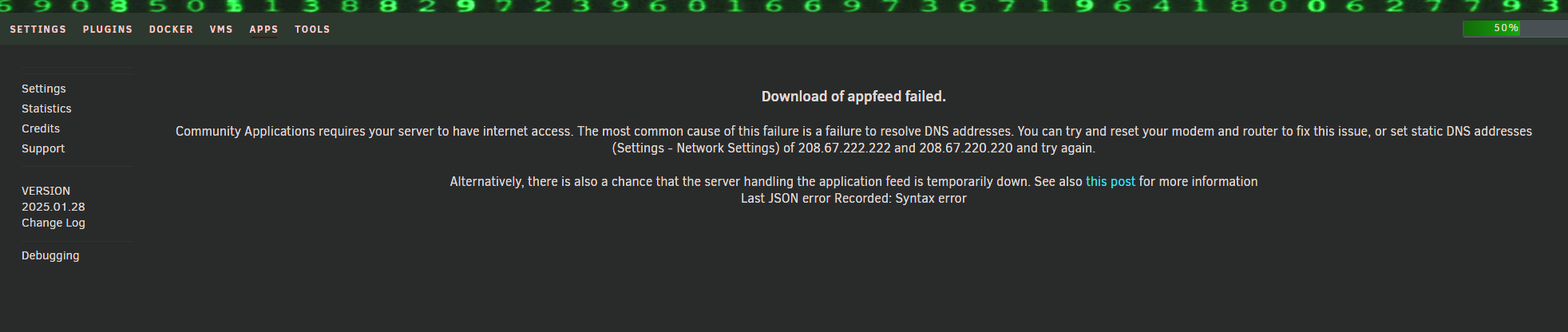

I had a previous tailscale installation that I uninstalled (unraid 6.x.x). I updated to 7.0.1 and reinstalled the plugin and my machine was going crazy. Pages wouldn't load, couldn't generate diagnostic data, unraid webui intermittently not loading. Problems -immediately- resolve when the plugin was uninstalled. I then installed the preview version to see if it resolves any issues, and now the unraid webapp is behaving normally except for a few things.
1.  Tailscale is still picking up data from my previous installation... as you can see I had Tailscale lock enabled and it thinks the machine is still locked even though that previous tailscale has been completely deleted as a tailscale network altogether. The entire account that had that network has been deleted. I successfully authenticated the new network, it's showing up in tailscale as a machine connected, but in the plugin ui as you can see it says the machine is still locked and I cannot edit many settings such as assigning this machine as an exit node.
2. The apps page won't load. The plugin isn't installed- loads fine, the plugin is installed- it stops working. Also Unraid connect throws up connection errors after tailscale is installed, but this is less of an issue given tailscale would replace unraid connect generally.
What was updated in preview that makes it much more stable in 7? Why is Tailscale picking up an old installation despite being logged into an entirely different account? Why isn't this old data cleaned out upon plugin uninstallation? What's up with the app store freaking out?

I won’t be able to look at diagnostics until tomorrow, but it seems like your plugin is still attached to the old tailnet. (The plugin and the “Use Tailscale” option in Docker are two different things that don’t affect the each other.)
I would do two things:
1. Use the “Erase Configuration” option in the advanced Tailscale settings.
2. Make sure “Accept DNS” is disabled.

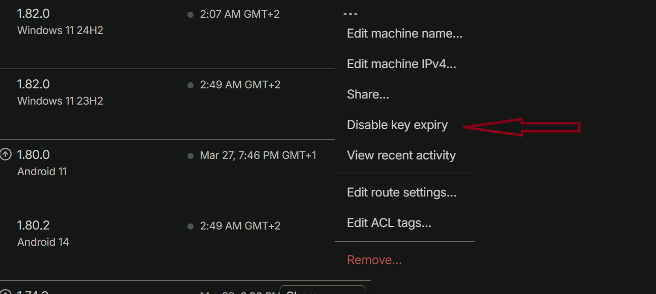

The plugin is displaying this message:
The Tailscale key will expire in 7 days on Fri, 11 Apr 2025 00:58:53 GMT.
Couple of questions/comments:
1. What do I need to do about this?
2. Can the plugin display the answer to question 1 so people don't need to ask :D
Thanks!
Login to your tailnet admin dashboard and disable key expiry

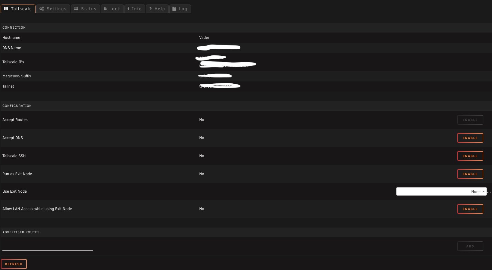

Following Spacenvaderone video to set up Subnets. first my setting screen looks nothing like everyone else's.I did use the Plug-in that he recommended  The second is I tried using the command line and get this error
tailscale up --advertise-routes=100.00.0.0/24
Error: changing settings via 'tailscale up' requires mentioning all
non-default flags. To proceed, either re-run your command with --reset or
use the command below to explicitly mention the current value of
all non-default settings:
The video is out of date, correct instructions are here:
https://edac.dev/unraid/tailscale/plugin/

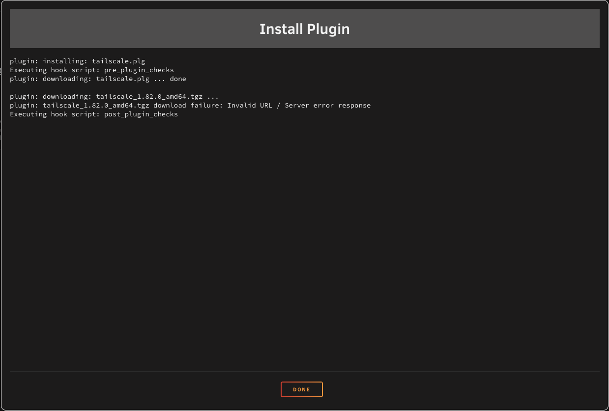

Hello. I was trying to install plugin, but i always get an error about invalid url. Maybe someone can help me installing this plugin. I get the same error when i try to use a link to the plugin that i found in some previous messages
