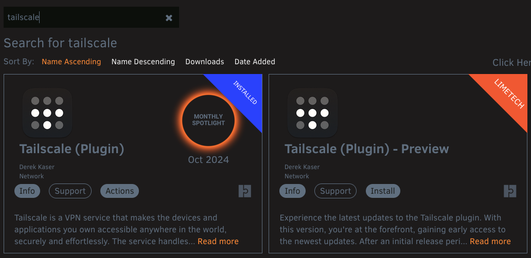

Is this plugin removed from apps since i cannot find it?
On 6/26/2025 at 8:27 AM, Laov said:
I tried to hook up Shinobi docker container with tailscale and received the following exception:
I'm confident this isn't the correct thread for your issue. You might be looking for the thread about Unraid Tailscale docker integration. This plugin isn't responsible for that.
11 minutes ago, Espressomatic said:
My search only finds docker. Or does it mean that i need to install it manually on 6.12.15?
Yes
1 minute ago, Espressomatic said:
Yes
Thanks. Just wanted to make sure. I was in impression that you dont need plugin on 7+ since builtin and since main post says plugin is maintained on 6.12.0 and newer i though latest version is in apps on 6.12.15.
Edited by twiikker
The Plugin serves a different purpose than the built-in docker support. Instead of using the built-in support with a docker container, I just spin up LXC container and install Tailscale into them on the command-line. IMO, this is much more stable, as is the case with my Nginx Proxy Manager and AdGuard Home LXC.
This plugins latest version only supports Unraid 7 thus you cant find it on the previous versions.
