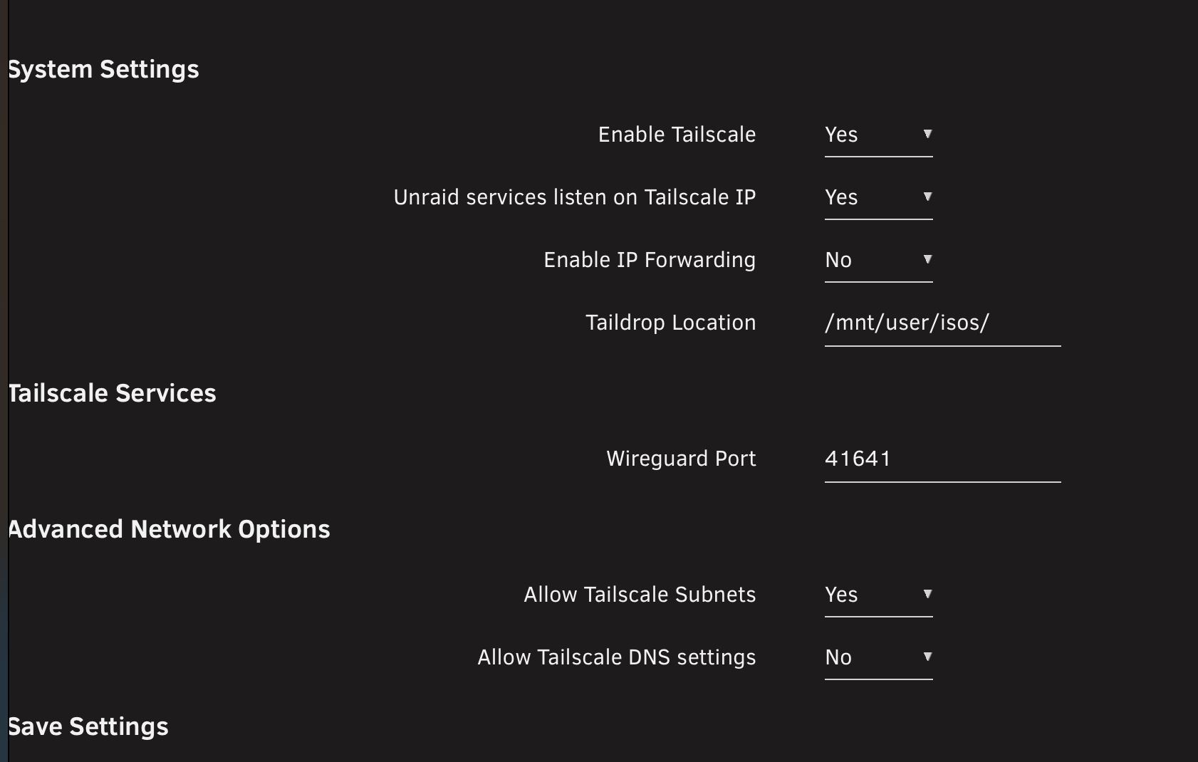

Hey there,
When I use this tailscale plugin on unraid.
Homeassistant (docker) stops being able to talk to devices (smart plugs etc) on the local & other local subnets.
Any ideas how can I fix this?
It would be grande if we could make the help sections explain how a function works not just what its command is.
i.e why would someone use 'unraid services listen on tailscale IP' or 'enable IP forwarding' etc.
On my router I just turn on tailscale and it approve it on the website and it works as if I am at home.
Settings:
Edited by dopeytree
