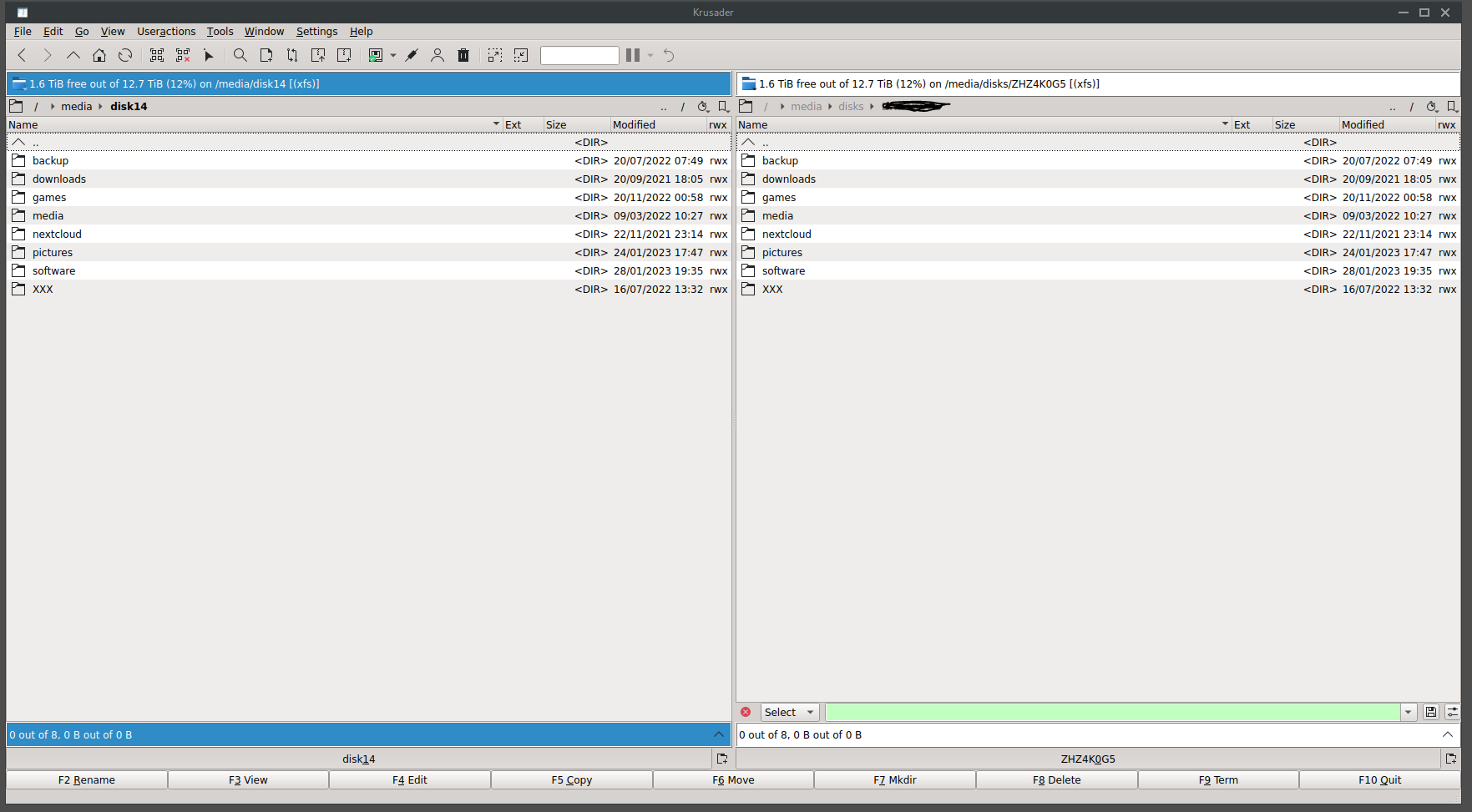

Why is Disk14 visible mounted in /media/disks
As the title suggests, I've got 16 disks and only disk14 is visible mounted under /media/disks it should not be here.
Does anyone know why this happened? How should I resolve this?

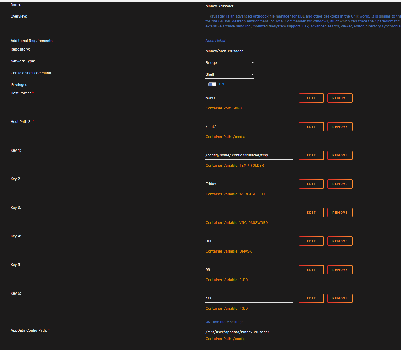

Krusader is only able to show/access what you gave it access to in the path mounts and with the container's internal structure, so it's likely you don't have that set right to access everything. Post the template contents.
/media is mapped to /mnt, so all of your disks should show up there.  Along with "user" which is all the the shares combined from all disks
Are you saying that nothing else is showing up in /media except for disk14?
You could always try editing that path mapping and changing the access mode to be Read/Write:SLAVE and see if that makes a difference (in theory it shouldn't matter though)
Nope that's not what I'm saying. Yes it's mapped to mnt, and yes I expect to see all my disks here. I do.
What I'm saying is /mnt/disks which is where mounted drives outside of the array show up has a drive that shouldn't be there.
Disk14 should not be visible in /mnt/disks because it's not a drive mounted outside of my array. Disk14 shows up where it's supposed to but ALSO shows up where it's not supposed to.
