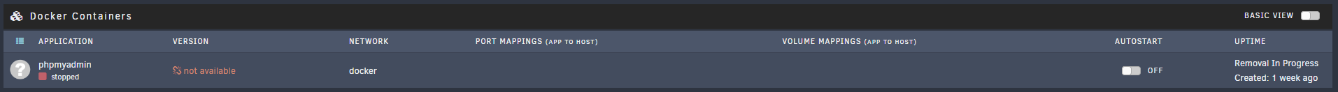

In the unraid UI i just get
Execution error
Server error
When i use docker compose i get the error.
And if i want to do docker-compose up, i now get
failed to register layer: exit status 2: "/usr/sbin/zfs fs snapshot ssd/System/b22b6c868df6ce04c55ffda2784887209f9129d6bad85a33dcb6523094c8fa82@749664689" => cannot open 'ssd/System/b22b6c868df6ce04c55ffda2784887209f9129d6bad85a33dcb6523094c8fa82': dataset does not exist

Nothing works at the moment with docker. Is there a way to fix this? Or to completely reset docker? (except the volumes if possible - but i have backups if really needed)
I dont have any docker images or containers
but still have one in unraid
