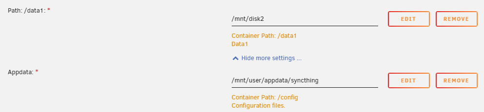

Pulling my hair out trying to figure this out.  Trying to keep two Unraid servers in sync.  Syncthing seems like it would do the trick but having trouble configuring.  I have it set up on both Unraid servers using mostly the default setting.  However, I'm having trouble added the existing folders I would like to sync.  In the syncthing gui it only lets me add folders that show up under appdata->Syncthing. (see test and test2).  I would like to sync disk2.
Setting up any folder under /config seems to work but something like /mnt/disk2 doesn't.
I'm not sure if it has something to do with the docker setup.  The Appdata setting is at the default but it asked me to set the Path:/data1 during install.  I'm not sure what that should be or if it's related to what I'm trying to do.

The concept you are looking for is docker container path mapping. What you put in the host side (Unraid's view) will appear in the container side at the mapped location. You show the container path as /data1, so that's where the contents of /mnt/disk2 will appear from the container's view.

Thanks @JonathanM

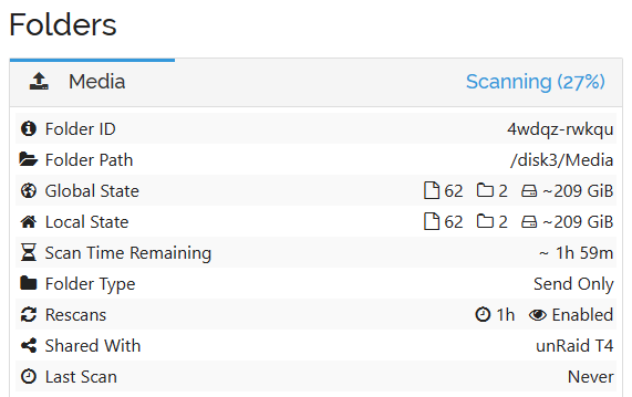

It's a little hard to find documentation/examples especially using the GUI.  I was able to figure it out through a bit of trial and error. Using this setting on both servers, I was able to sync folders as set up below.  A similar method could be used for any share (/mnt/user) versus individual disks (/mnt/disk3).
