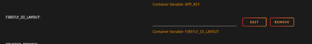

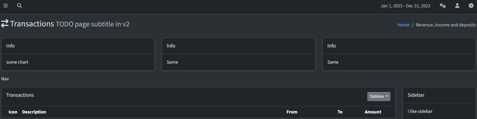

February 29, 20242 yr I have had firefly installed for quite a while, but haven't used it in over a year. I just got back and see this: Is this normal? The image used is fireflyiii/core:latest, and unRaid assures me there are no pending updates. There's placeholder text everywhere, in case it's not apparent. And not just on this page either. Edited February 29, 20242 yr by SvbZ3r0
March 1, 20242 yr 23 hours ago, SvbZ3r0 said: I have had firefly installed for quite a while, but haven't used it in over a year. I just got back and see this: Is this normal? The image used is fireflyiii/core:latest, and unRaid assures me there are no pending updates. There's placeholder text everywhere, in case it's not apparent. And not just on this page either. To anybody else who has this problem, it was because I had FIREFLY_III_LAYOUT set to v2. The v2 layout has been merged into the main branch, so this is unneccessary. Just leave the variable empty in the template.

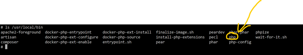

September 27, 20242 yr On 8/9/2024 at 10:21 PM, plantsandbinary said: Could someone please tell me how they set up cronjobs for Firefly III using this container? Creat a user script to run this command: docker exec --user www-data Firefly-III /usr/local/bin/php /var/www/html/artisan firefly-iii:cron

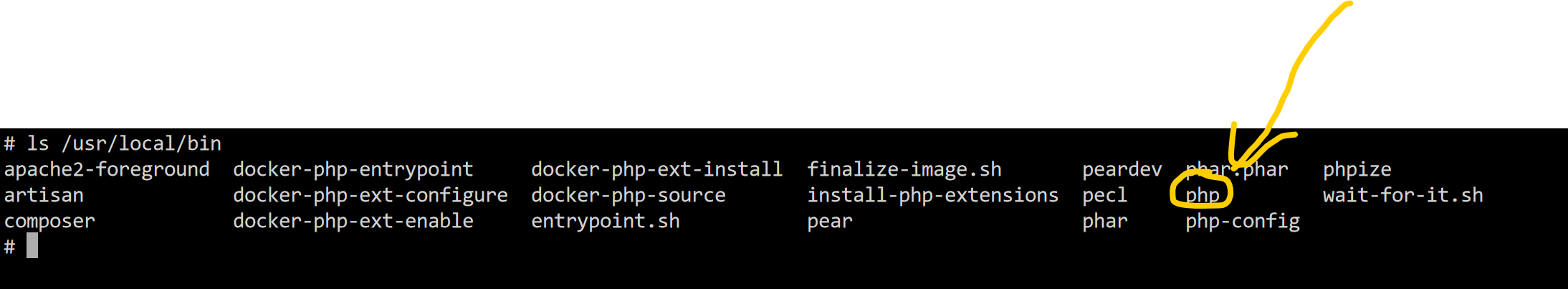

October 16, 20242 yr On 9/27/2024 at 10:15 AM, Bruceflix said: Creat a user script to run this command: docker exec --user www-data Firefly-III /usr/local/bin/php /var/www/html/artisan firefly-iii:cron Can you please confirm this? In the documentation, it says "/usr/bin/php" and not "/usr/local/bin/php". In the directory of /usr/local/bin there is no "php" But in the directory in /usr/bin/ there is "php" Sorry I'm not expert on this. Just want to clear things out. Thank you. . Edited October 16, 20242 yr by HHUBS edit

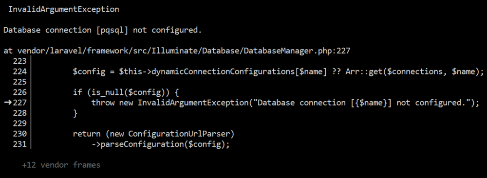

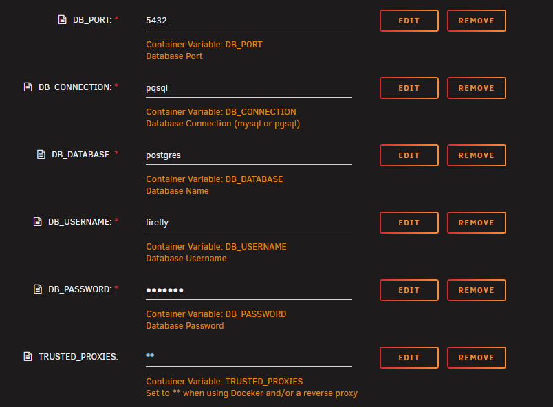

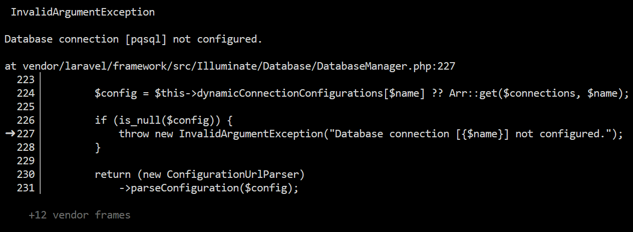

October 18, 20242 yr On 9/2/2023 at 3:42 AM, wieli99 said: Solution: it is a database user permission problem, granting the user correct permissions on the db and schema solves it Would you please share specific permissions did you grant the user? I used the GRANT ALL PRIVILEGES command and am still running into this issue. EDIT: You need to give the user that you create SUPERUSER and CREATEDB privileges. This can be done with the ALTER USER command. Edited October 18, 20242 yr by N¿¿B

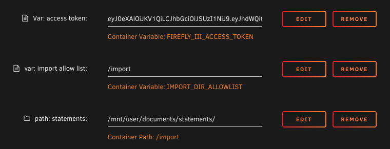

November 13, 20242 yr I can't get the auto importer working. Here is my firefly setup. I have setup firefly-iii and connected it with importer and managed to import data from my bank via gocardless. I have the config.json as well, and have uploaded it to docker container. Following the guide for auto importing: https://docs.firefly-iii.org/how-to/data-importer/import/automated/ It tells me to run this command: docker exec firefly_iii_importer php artisan importer:import /import/config.json Where firefly_iii_importer is the container ID, and where config.json is the configuration file from the previous step. This should run the import again. However: When checking docker container IDs from unraid SSH I would need to use this command: docker exec ae6225d48e78 php artisan importer:import /var/www/html/storage/upload/import_config_2024-11-13.json However I get the following error: root@Tower:~# docker exec ae6225d48e78 php artisan importer:import /var/www/html/storage/upload/import_config_2024-11-13.json Trying to connect to ... The last 25 chars of the access token are: ApiHttpException: Could not connect to Firefly III at : cURL error 3: URL using bad/illegal format or missing URL (see https://curl.haxx.se/libcurl/c/libcurl-errors.html) for /api/v1/about The last 25 chars of the access token are: No access granted, or no connection is possible to your local Firefly III instance at . Manually running the config via importer web-ui works just fine though. Where am I going wrong? Why is the command failing? I would intend to automate this command into cron jobs or userscripts in unraid. Edited November 13, 20242 yr by eilif

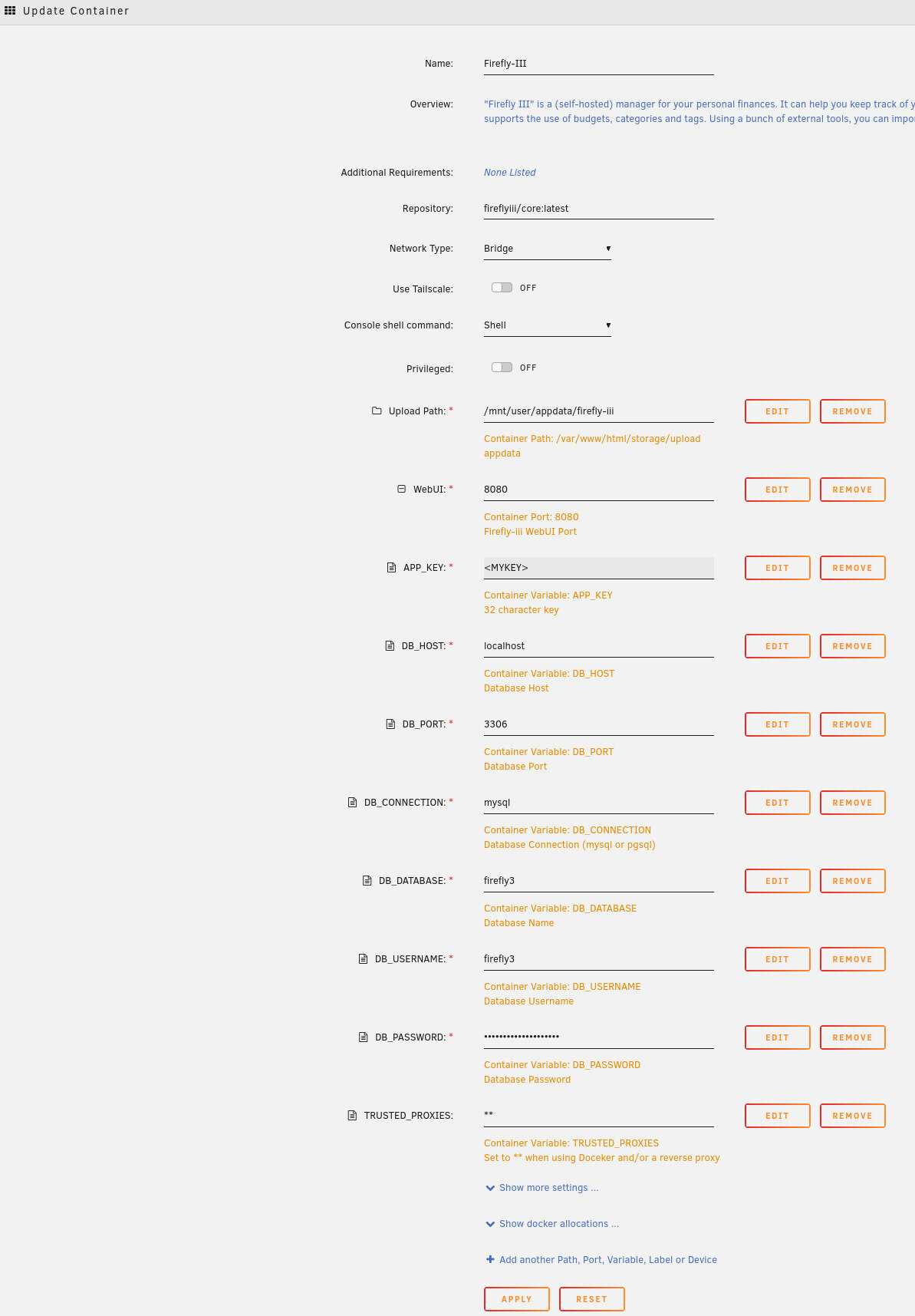

June 5, 20251 yr I tried to get my firefly 3 up and running with a mysql as DB. The logs show, that the DB should be up and running, after the "wait-for-it"-Script. But then I get:[2025-06-05 16:29:13] production.ERROR: SQLSTATE[HY000] [2002] No such file or directory (Connection: mysql, SQL: select * from `configuration` where `name` = db_version and `deleted_at` is null and `configuration`.`deleted_at` is null limit 1) [2025-06-05 16:29:13] production.ERROR: SQLSTATE[HY000] [2002] No such file or directory (Connection: mysql, SQL: select * from `configuration` where `name` = ff3_version and `deleted_at` is null and `configuration`.`deleted_at` is null limit 1) as error. You can see my config here.I also tried sqlite. Is this a better way or should I not use sqlite? sqlite works, but I don't want to start with firefly "broken by design" (from me!).Any help is appreciated. Niko
June 5, 20251 yr 3 minutes ago, jamfx said:I tried to get my firefly 3 up and running with a mysql as DB. The logs show, that the DB should be up and running, after the "wait-for-it"-Script. But then I get:[2025-06-05 16:29:13] production.ERROR: SQLSTATE[HY000] [2002] No such file or directory (Connection: mysql, SQL: select * from `configuration` where `name` = db_version and `deleted_at` is null and `configuration`.`deleted_at` is null limit 1) [2025-06-05 16:29:13] production.ERROR: SQLSTATE[HY000] [2002] No such file or directory (Connection: mysql, SQL: select * from `configuration` where `name` = ff3_version and `deleted_at` is null and `configuration`.`deleted_at` is null limit 1) as error. You can see my config here.I also tried sqlite. Is this a better way or should I not use sqlite? sqlite works, but I don't want to start with firefly "broken by design" (from me!).Any help is appreciated.Niko4 minutes ago, jamfx said:I tried to get my firefly 3 up and running with a mysql as DB. The logs show, that the DB should be up and running, after the "wait-for-it"-Script. But then I get:[2025-06-05 16:29:13] production.ERROR: SQLSTATE[HY000] [2002] No such file or directory (Connection: mysql, SQL: select * from `configuration` where `name` = db_version and `deleted_at` is null and `configuration`.`deleted_at` is null limit 1) [2025-06-05 16:29:13] production.ERROR: SQLSTATE[HY000] [2002] No such file or directory (Connection: mysql, SQL: select * from `configuration` where `name` = ff3_version and `deleted_at` is null and `configuration`.`deleted_at` is null limit 1) as error. You can see my config here.I also tried sqlite. Is this a better way or should I not use sqlite? sqlite works, but I don't want to start with firefly "broken by design" (from me!).Any help is appreciated.NikoFor variable DB_HOST put the ip address of your DB.
June 5, 20251 yr 3 minutes ago, Bruceflix said:For variable DB_HOST put the ip address of your DB.I tried it with the IP and mariadb, but this resulted in the following:Could not poll the database: SQLSTATE[HY000] [2002] Connection refused (Connection: mariadb, SQL: select `id`, `name`, `data` from `configuration` where `name` = is_demo_site and `configuration`.`deleted_at` is null limit 1) So I tried again with mysql and the IP. This ended up in a 500 Error. And from the logs I got:[2025-06-05 16:49:22] production.ERROR: Exception is: {"class":"InvalidArgumentException","errorMessage":"Database connection [myslq] not configured.","time":"Thu, 05 Jun 2025 16:49:22 +0200","file":"\/var\/www\/html\/vendor\/laravel\/framework\/src\/Illuminate\/Database\/DatabaseManager.php","line":227,"code":0,"version":"6.2.16","url":"http:\/\/localhost","userAgent":"Symfony","json":true,"method":"GET","post":""} [2025-06-05 16:49:22] production.WARNING: Sent 6 emails in 5m, return true. [2025-06-05 16:49:22] production.INFO: MailError: reached limit, not sending email. [2025-06-05 16:49:22] production.ERROR: Database connection [myslq] not configured. {"exception":"[object] (InvalidArgumentException(code: 0): Database connection [myslq] not configured. at /var/www/html/vendor/laravel/framework/src/Illuminate/Database/DatabaseManager.php:227)🤔 any other suggestions? Thanks in Advance.

July 21, 20251 yr On 11/13/2024 at 5:55 PM, eilif said:I can't get the auto importer working. Here is my firefly setup. I have setup firefly-iii and connected it with importer and managed to import data from my bank via gocardless. I have the config.json as well, and have uploaded it to docker container. Following the guide for auto importing: https://docs.firefly-iii.org/how-to/data-importer/import/automated/ It tells me to run this command: docker exec firefly_iii_importer php artisan importer:import /import/config.json Where firefly_iii_importer is the container ID, and where config.json is the configuration file from the previous step. This should run the import again. However: When checking docker container IDs from unraid SSH I would need to use this command: docker exec ae6225d48e78 php artisan importer:import /var/www/html/storage/upload/import_config_2024-11-13.json However I get the following error: root@Tower:~# docker exec ae6225d48e78 php artisan importer:import /var/www/html/storage/upload/import_config_2024-11-13.json Trying to connect to ... The last 25 chars of the access token are: ApiHttpException: Could not connect to Firefly III at : cURL error 3: URL using bad/illegal format or missing URL (see https://curl.haxx.se/libcurl/c/libcurl-errors.html) for /api/v1/about The last 25 chars of the access token are: No access granted, or no connection is possible to your local Firefly III instance at . Manually running the config via importer web-ui works just fine though. Where am I going wrong? Why is the command failing? I would intend to automate this command into cron jobs or userscripts in unraid. @eilif did you manage to fix? I'm having the same issue.
September 9, 20251 yr On 9/2/2023 at 4:42 AM, wieli99 said:Solution: it is a database user permission problem, granting the user correct permissions on the db and schema solves itOn 9/2/2023 at 4:42 AM, wieli99 said:Solution: it is a database user permission problem, granting the user correct permissions on the db and schema solves itHello, for user what permission it needs? I tried with firefly and postgres but both having issue. What am I missing?TIA
September 19, 20251 yr @eilif @xxbigfootxx I think I have a solution to the issueTrying to connect to ... The last 25 chars of the access token are: ApiHttpException: Could not connect to Firefly III at : cURL error 3: URL using bad/illegal format or missing URL (see https://curl.haxx.se/libcurl/c/libcurl-errors.html) for /api/v1/about The last 25 chars of the access token are: No access granted, or no connection is possible to your local Firefly III instance at . Generate an auth token within the FireFly III container (Options > Profile > OAuth > Personal Access Tokens) – make sure to save this as you will never see it again!Configure the importer container as per the docsFIREFLY_III_ACCESS_TOKEN – this is the auth token that you generated in step 1IMPORT_DIR_ALLOWLIST – this is the dir within the "FireFly II Importer" container from which you are allowing the importer to import fromAn external directory to mount to the directory set by IMPORT_DIR_ALLOWLIST – it will be a directory outside of the containers into which you will be dropping your statements (CSV) and configs (JSON)Run the import command from Unraid – you might need to tweak this to suit your setupdocker exec -it $(docker ps -aqf "name=Firefly-III-Data-Importer") php artisan importer:import /import/path/to/config.json /import/path/to/statement.csvHopefully this helps.

March 6Mar 6 On 9/19/2025 at 6:46 PM, shooftie said:@eilif @xxbigfootxxI think I have a solution to the issueTrying to connect to ... The last 25 chars of the access token are: ApiHttpException: Could not connect to Firefly III at : cURL error 3: URL using bad/illegal format or missing URL (see https://curl.haxx.se/libcurl/c/libcurl-errors.html) for /api/v1/about The last 25 chars of the access token are: No access granted, or no connection is possible to your local Firefly III instance at . Generate an auth token within the FireFly III container (Options > Profile > OAuth > Personal Access Tokens) – make sure to save this as you will never see it again!Configure the importer container as per the docsFIREFLY_III_ACCESS_TOKEN – this is the auth token that you generated in step 1IMPORT_DIR_ALLOWLIST – this is the dir within the "FireFly II Importer" container from which you are allowing the importer to import fromAn external directory to mount to the directory set by IMPORT_DIR_ALLOWLIST – it will be a directory outside of the containers into which you will be dropping your statements (CSV) and configs (JSON)Run the import command from Unraid – you might need to tweak this to suit your setupdocker exec -it $(docker ps -aqf "name=Firefly-III-Data-Importer") php artisan importer:import /import/path/to/config.json /import/path/to/statement.csvHopefully this helps.Hi!I'm trying to automate the import task using enable banking provider.Manual import it's working, i have .pem file and config.json inside docker.The problem is loading .pem certificate, i link Github Topic here and here.What's the way to add a new line \n in environment variable or .env file in Unraid?Edit: i found this post, but I don't understand how to use the information.Thank you very much Edited March 6Mar 6 by FBoscarato
